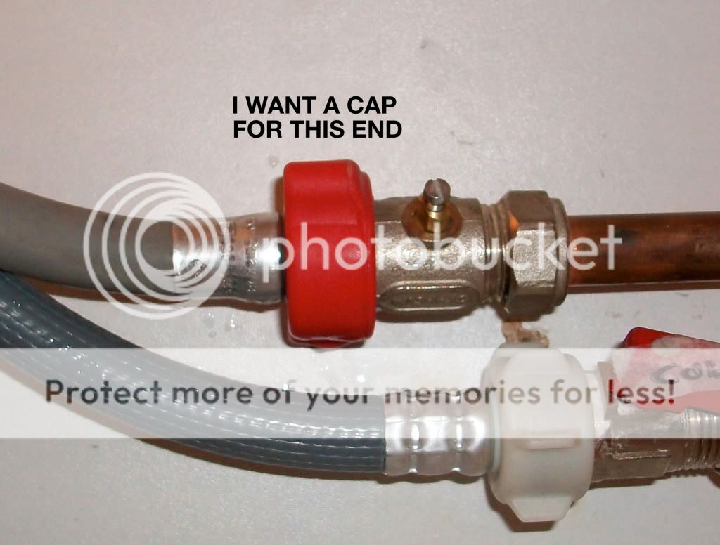

New washing machine - need to cap off disued hot feed
To save faffing about go buy yoursel a 15mm kuterlite stopend, shut off the hot water, open tap to make sure its off, with a shifter and a pair o gordons undo the 15mm nut at the WM valve and put the stopend on and tighten:)
Turn on water again and test for leaks.
Thats a 1/2 inch cap you have and is no use. If you can't get a 3/4 cap get a 15mm compression blank (stop) end and remove the valve (use the existing nut and ring from the valve).
The valve does look as if it is not fully off.

Golly gosh! If the hot valve is letting by anyway then it needs to go in the bin, so shut off the water and loosen the backnut off the valve , and fit a 1/2 inch blanking cap onto the backnut and olive. Job done, and more reliable in the long term, as those valves can drip out of the operating screw.
the photo looks like a bog standard 15mm washing machine valve , which has a 3/4" BSP end for the hose, (someone said it might be 1" but the perspective in the photo shows it as a "normal" valve), so it comes back to are you sure it is a 3/4" cap :oops: do us a favour and take another pic with the brass nut next to the valve, or if you just want to get the job done, but a 15mm compression balnk, turn off your hot water, make sure it is properly off, remove the washing machine valve and tighten your new blank cap onto the nut and olive from the valve

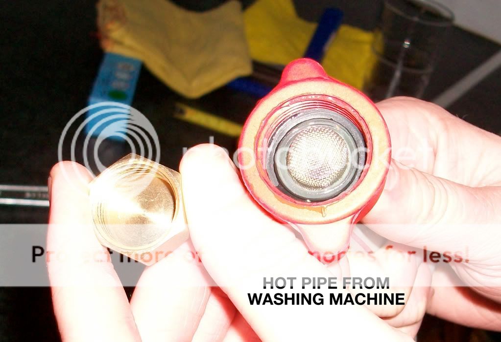

Yes of course i've tried to screw it on!! :D Its farrrr too small.
Just to be clear, i'm trying to fit this cap to the part of the isolating valve that once was attached to the red plastic washing machine hose. As you can see in that top pic, that is about 1" in diameter, the cap i was advised to get at the plumbase shop is about 22mm wide.
We all know exactly what you're trying to do, and if it's about 22mm wide then it's definitely a 1/2" cap, back to the merchants with you and get a 3/4"
Cut the hot water hose,and pull it thru the nut. You need the red nut and washer.
Place a ten pence piece in the nut,then then existing washer,tighten onto valve. Job done

Anyway, I had a new washing machine installed today so the hot water connection is switched off, but it needs a cap to stop it and make it safe completely.
I have read the responses, and wonder if this item is what I need?
http://www.diy.com/diy/jsp/bq/nav.jsp?action=detail&fh_secondid=9265155
I have pretty much no idea at all about plumbing.
Unfortunately the picture on the B&Q website does not show the inside of it, so will it have a screw thread or not?
I just want a cap that can screw onto the connection. I am not going to alter things by cutting the pipe or anything, as it is a council property and I would not want to get into trouble if anything was done wrong or against the council's rules.
yes that is the cap that you need to cap off a washing machine tap, 3/4 female thread. The reason that washing machines only have cold fill nowadays is that it generally takes less time to fill the machine than it does to get the hot water from the airing cupboard to the kitchen, all that you are doing is putting hot water in the pipes.[/quote]
