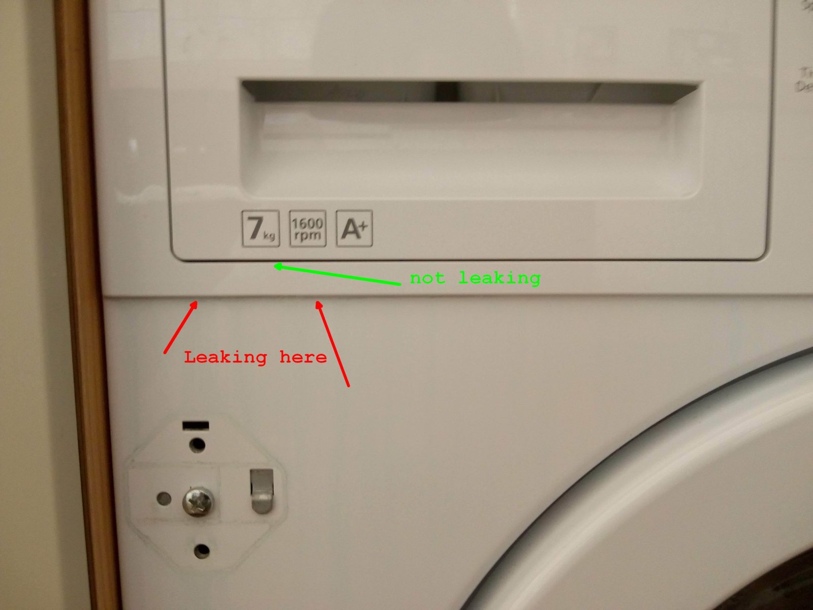

Thanks guys. Pump is sorted now, but now there is a leak from the front panel below the soap drawer...
Came back from holidays yesterday, used a wet vac to get most of the water out, turned the machine to the side and removed the internal drain hose, using pump pliers, found a pair of baby socks in the filter and some other residue! The machine is draining well again.
But it leaks from the front panel, below the soap drawer. First I thought it was directly below the drawer, but it's actually a bit further down, see photo. When the water runs through the drawer, there is a slow leak where the panel joins. When I push against it, it leaks more. There was some laundry detergent residue which I wiped off, and in two spots it looks as if there are two pin hole leaks (could I have done this when I flipped the machine - carefully I thought)? Do you think I could try sealing this with silicone or can you think of something else I could try?
