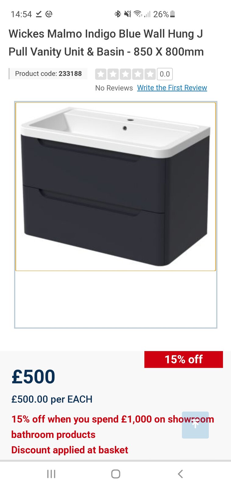

We have a bathroom installer from Wikes doing an install. This bathroom has cost is 10k and we are not happy with some of the answers he is giving us regarding what we want. We have brought a wall hung vanity and want the waste and the hot and cold water feed hidden. I have asked the question if these could be hidden in the metal frame stud work instead of having box work as that defeats the object of a wall hung vanity. Can you run the pipework through a metal studwork cavity wall? He told us the metal framework is not the best to cut holes into. If this is the case then fair enough. But I get the impression he is just fobbing us off. Surely a metal studwork is the same as wooden studwork and can be cut with a drill hole saw? I think the cavity width is 50mm.
Also we brought a low profile shower tray and he has told us the only way it can be installed is by way of legs raising the tray off of the floor. This is not what we wanted. Can the 40mm waste be routed through wooden joists?
If the products we purchased are not suitable for our requirements why have Wikes allowed us to purchase these products.
I have attached the technical sheet for the shower tray and a screen shot of the vanity.
Thank you in advance for your responses.

Most of them already have service apartures in them just or pushouts ready exactly for this. Those that don't then holes can be cut on site upto a sensible size limit (standard is 38x75).
You should also only really pass one pipe is through each apature in the metal framework. If you can't for whatever reason, you should use a proprietary pipe restraint clips or other means of keeping the pipes apart, to prevent vibration noise which will be very noticeable on metal studs.
There can be valid reasons why the low profile tray could not be fitted, but an alternative that would fit could be sourced.
Speak to Wickes and get clarification.
The other thing you should do is to protect pipes the pipes where they go through the ceu outs with a rubber grommet or grommet strip (comes on a roll, cut to length). This prevents the metal damaging the pipework in the event of movement (including when you are drawing through)
