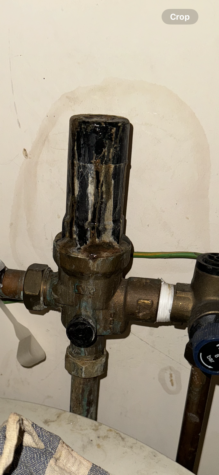

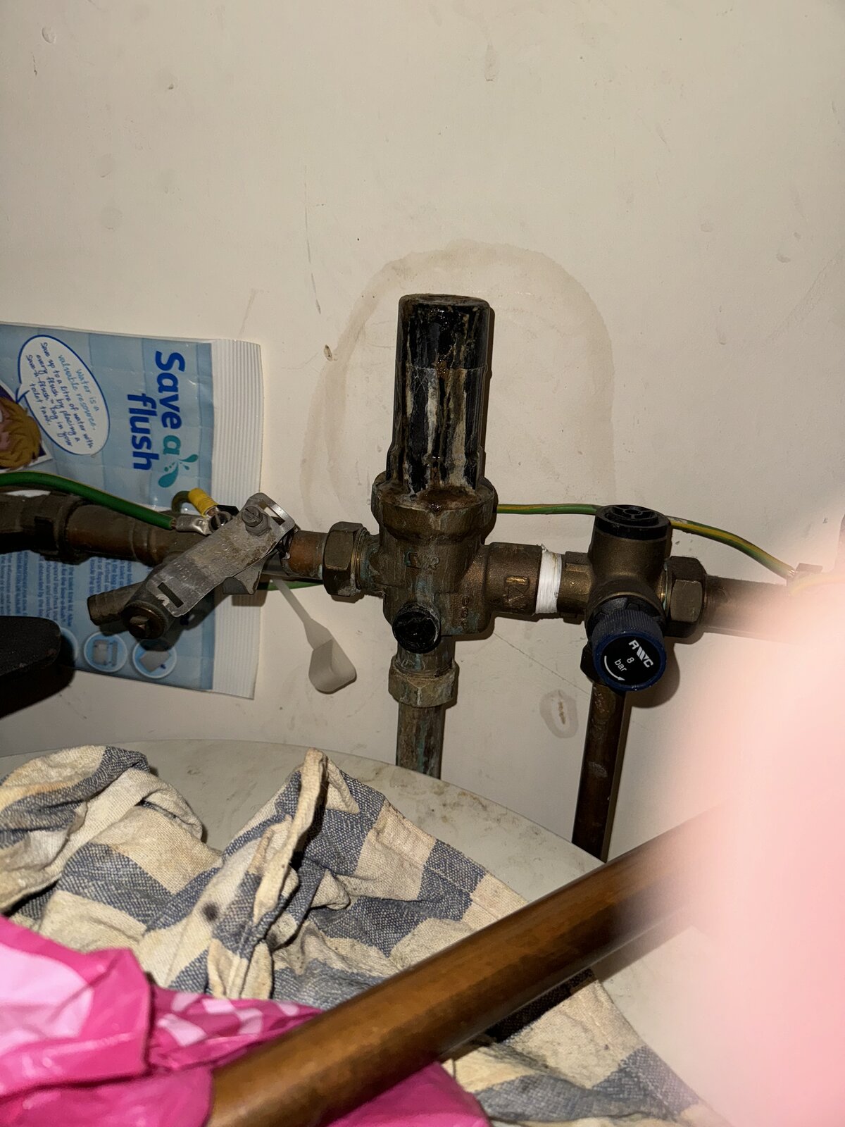

Hi all
I have a heatrae Sadia unvented water cylinder
The pressure valve at the top seems to be leaking.
Any ideas what to do?
Can I simply clean the valve?
Should I buy a new cartridge?
Or do I have to buy a whole new preset cartridge with the pipe?
Any help is much appreciated
Jordan
Also I replace this cartridge and preset section around 5 years ago.
Could I just change the cartridge? Or clean the filter?
1. Its part of the safety system for an unvented cylinder so only someone with a G3 qualification and current accreditation can work on it. It is not a DIY job.
2. In my experience those filters (black, upward pointing lump) disintegrate when you try to undo them after a few years use.
3. I would change the whole valve.
4. Those cylinders are meant to be serviced annually.
