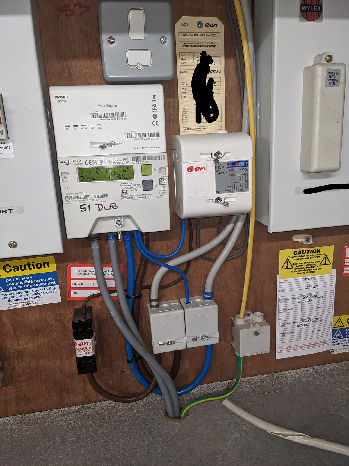

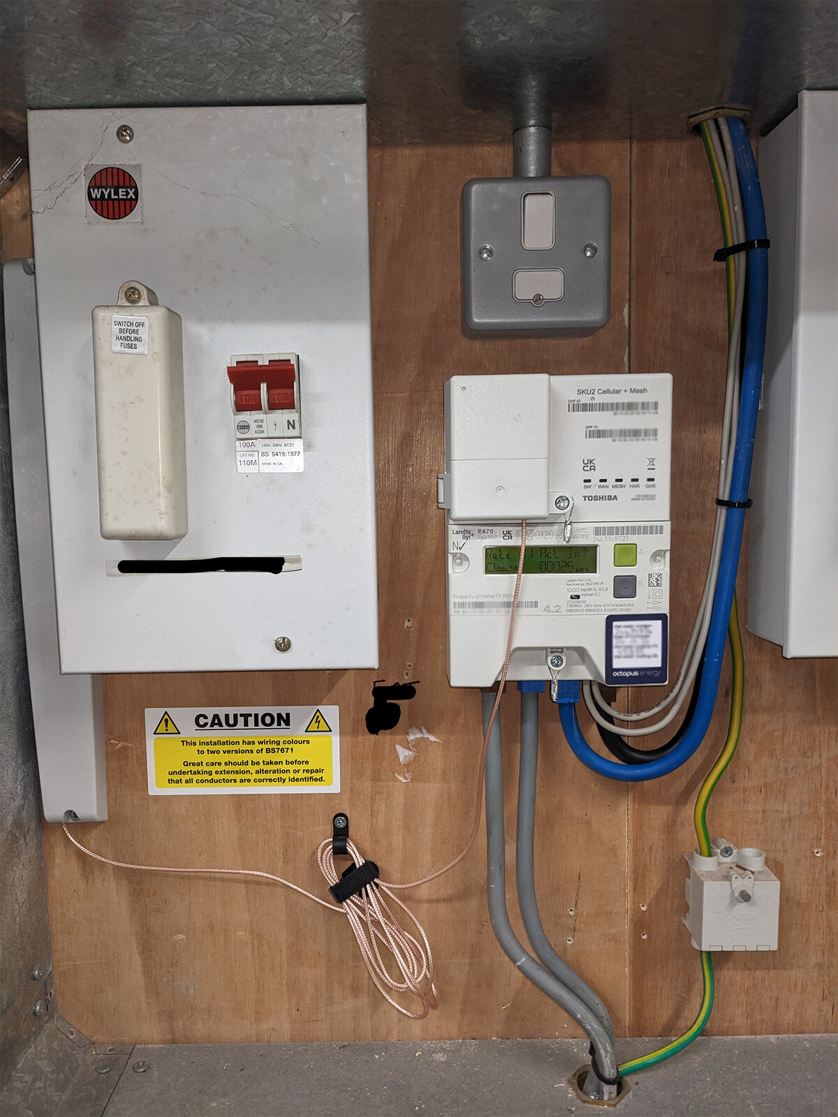

I live in an apartment (7th floor), and 6 weeks ago Octopus came out to install a smart meter. We're on an economy7 tariff, but as soon they installed it our water heater stopped working.
We have the typical Off Peak Switch and Boost Switch, off peak always stays on and overnight would heat up.
Based on our reading, we're getting Off Peak rates, it just no longer connects to the Off Peak switch (The light doesn't come on).
Octopus have sent 3 engineers out, and after about 50 emails we've gotten nowhere. Every engineer says the same thing, well it looks right to me.
Here are some images for context. One is our New Smart Meter, the other is what it used to look like (when we were with eon).
I've seen this a lot online, but CANNOT find the solution. Any advice would be massively appreciated.

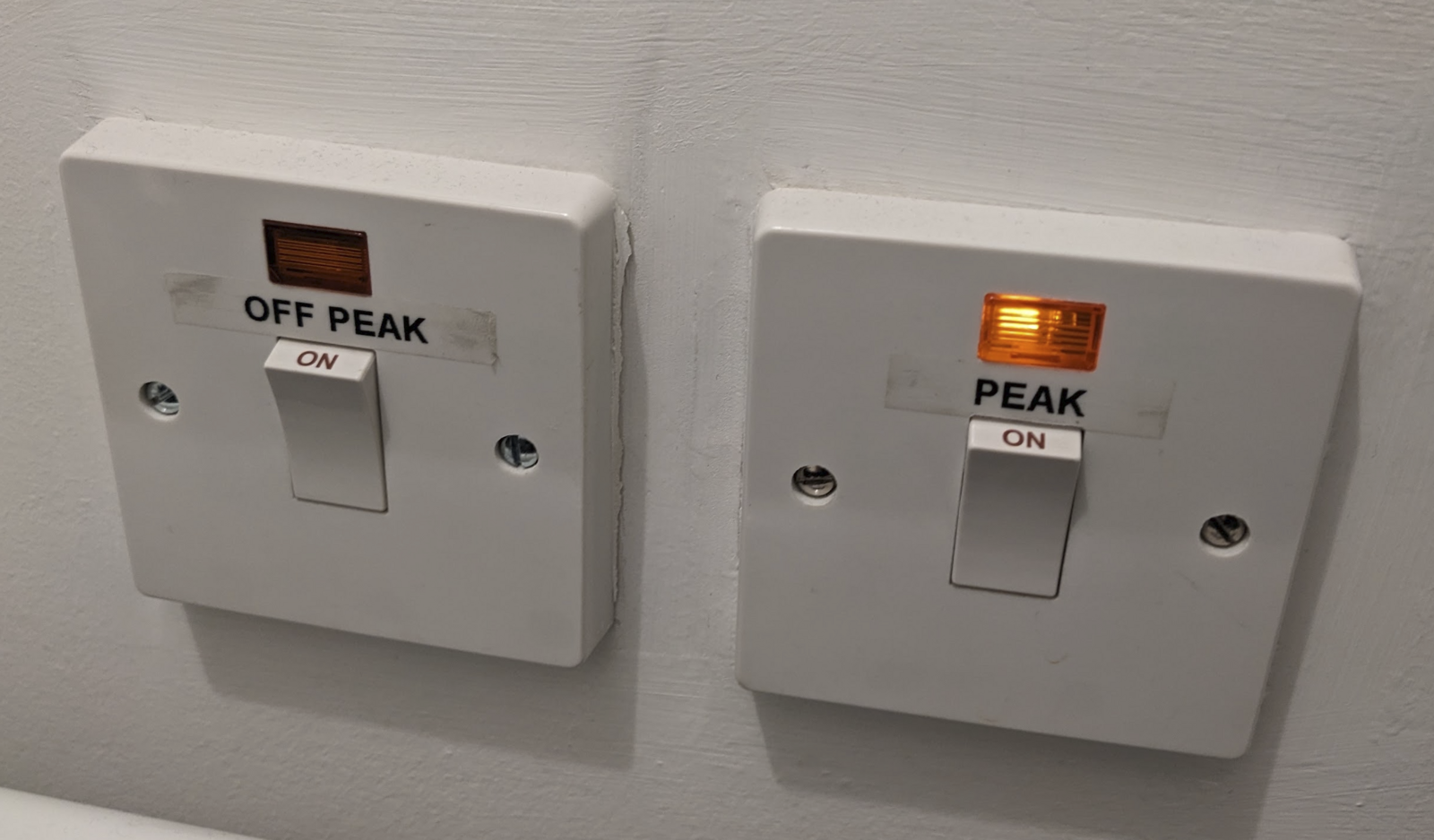

Hey Wayners, Apologies, should have clarified.
Water heater works fine when we use the Boost/Peak function. The switches have LED lights above them to show when they're receiving power. Off Peak doesn't light up anymore, Peak works fine though (just costs a lot more and is very inconvenient).

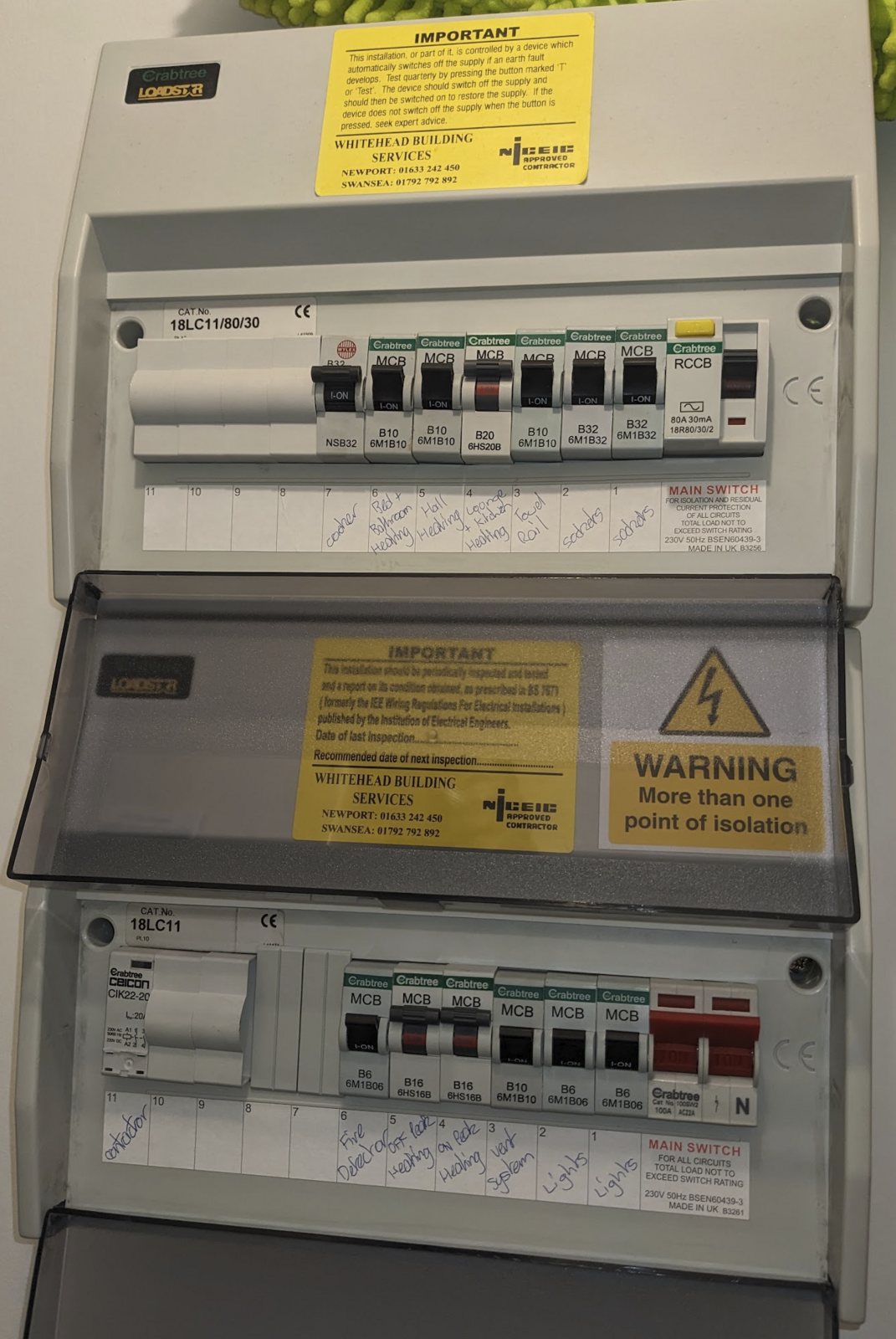

Images of Switches and Fusebox for reference.

either the switch live from the meter to the contactor isnt working, or the contactor it's self has failed
Old setup has a contactor to the right of the meter (the box with EON on it).
New has no contactor visible, the fuse for it has been removed, the wires to whatever it connected to have been replaced as they are a different colour, as have the main tails.
What else did they change/alter/add/remove? Clearly a lot more done here than just a meter swap.
