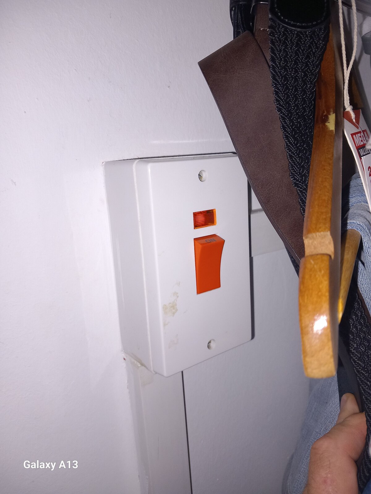

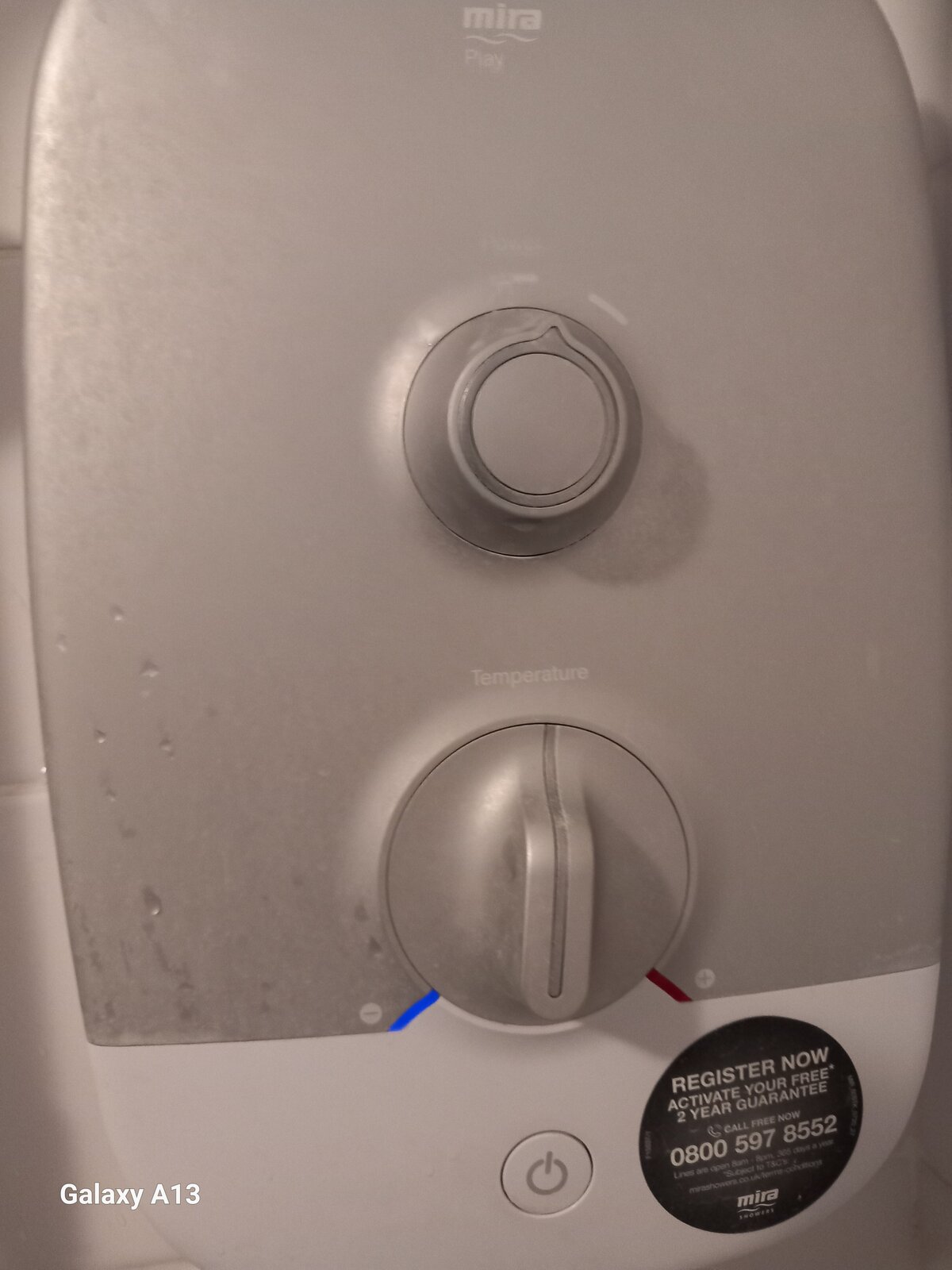

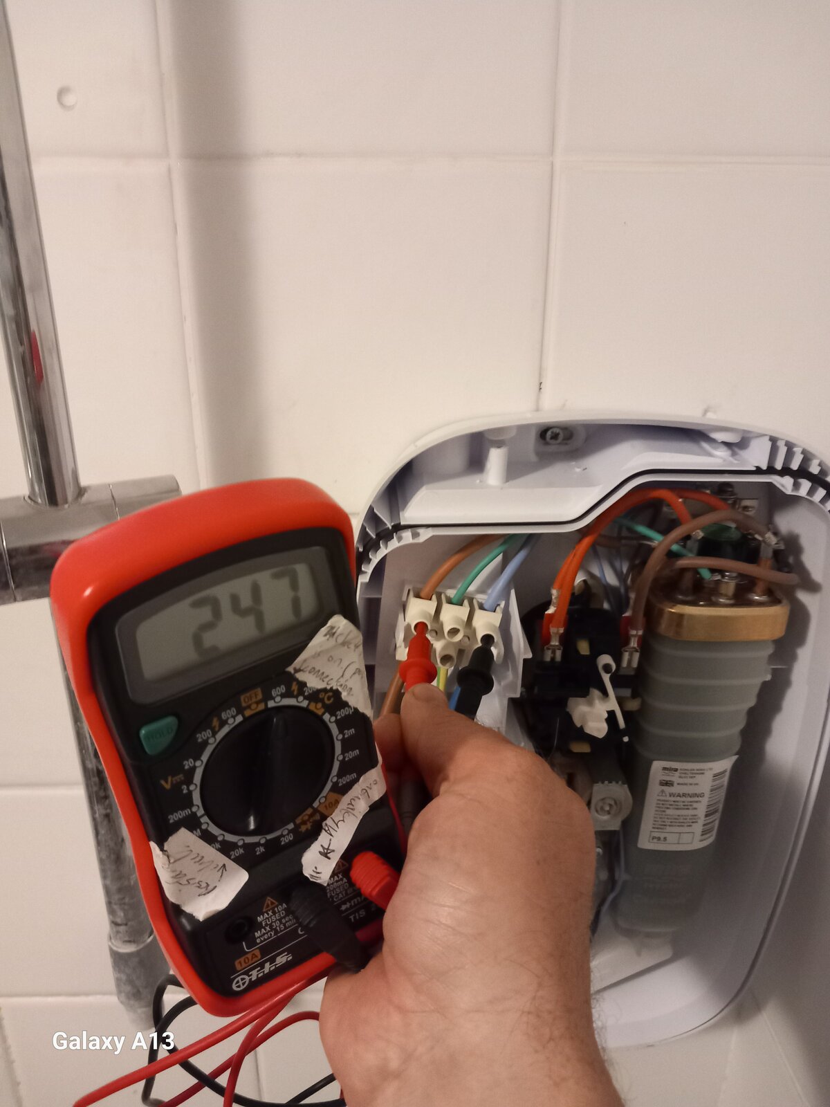

In the middle of a shower the water just stopped, what's wrong? The switch does go in and stays in.
Looks like there's no power, button should be lit.
Which button? Usually just the two led lights- blue and red, both look lot on photo above, don't they?
This is photo of isolating electric switch in cupboard behind shower- lights on

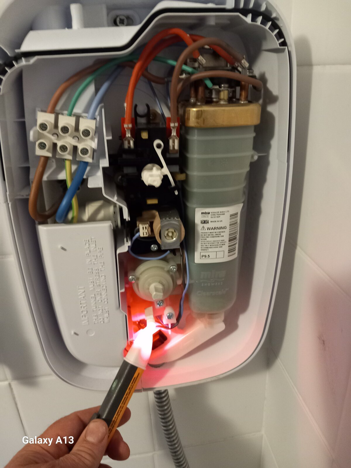

Where's the fuse?
Check the pull cord or outside switch and fuse.

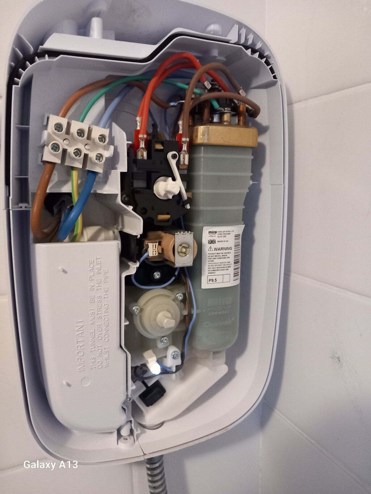

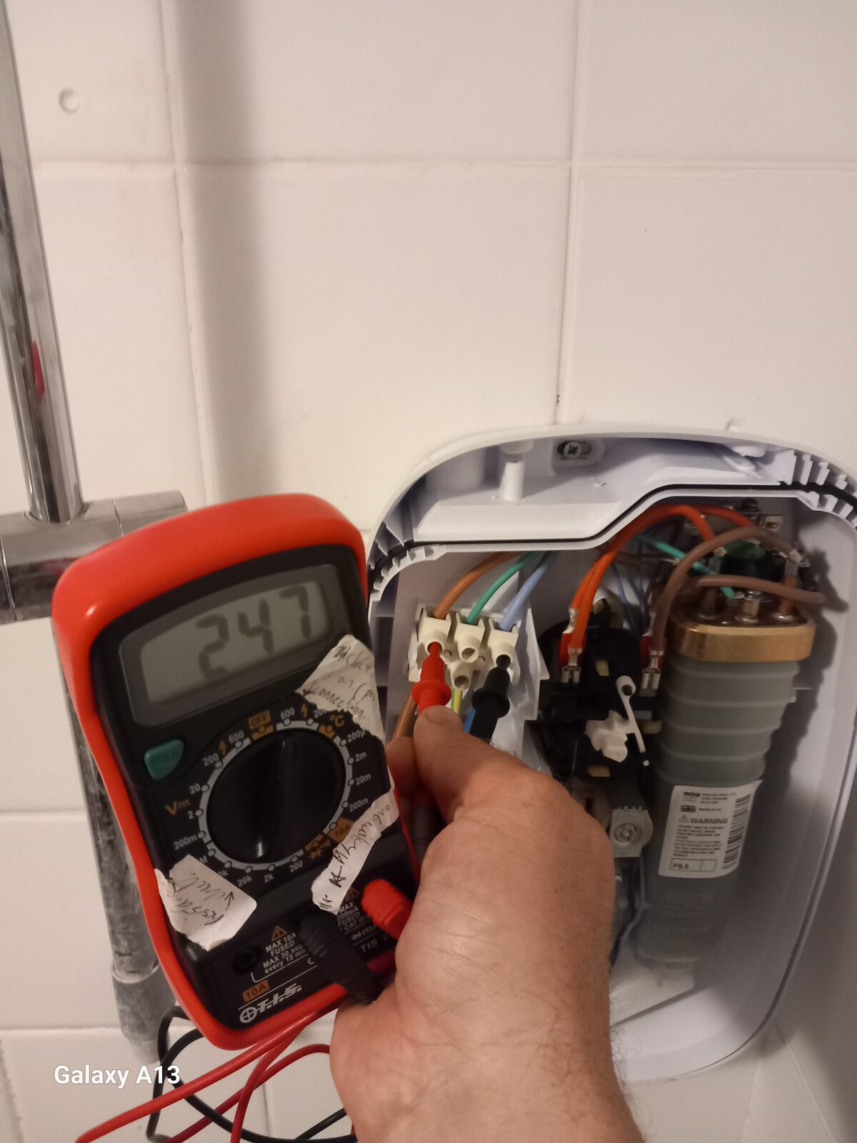

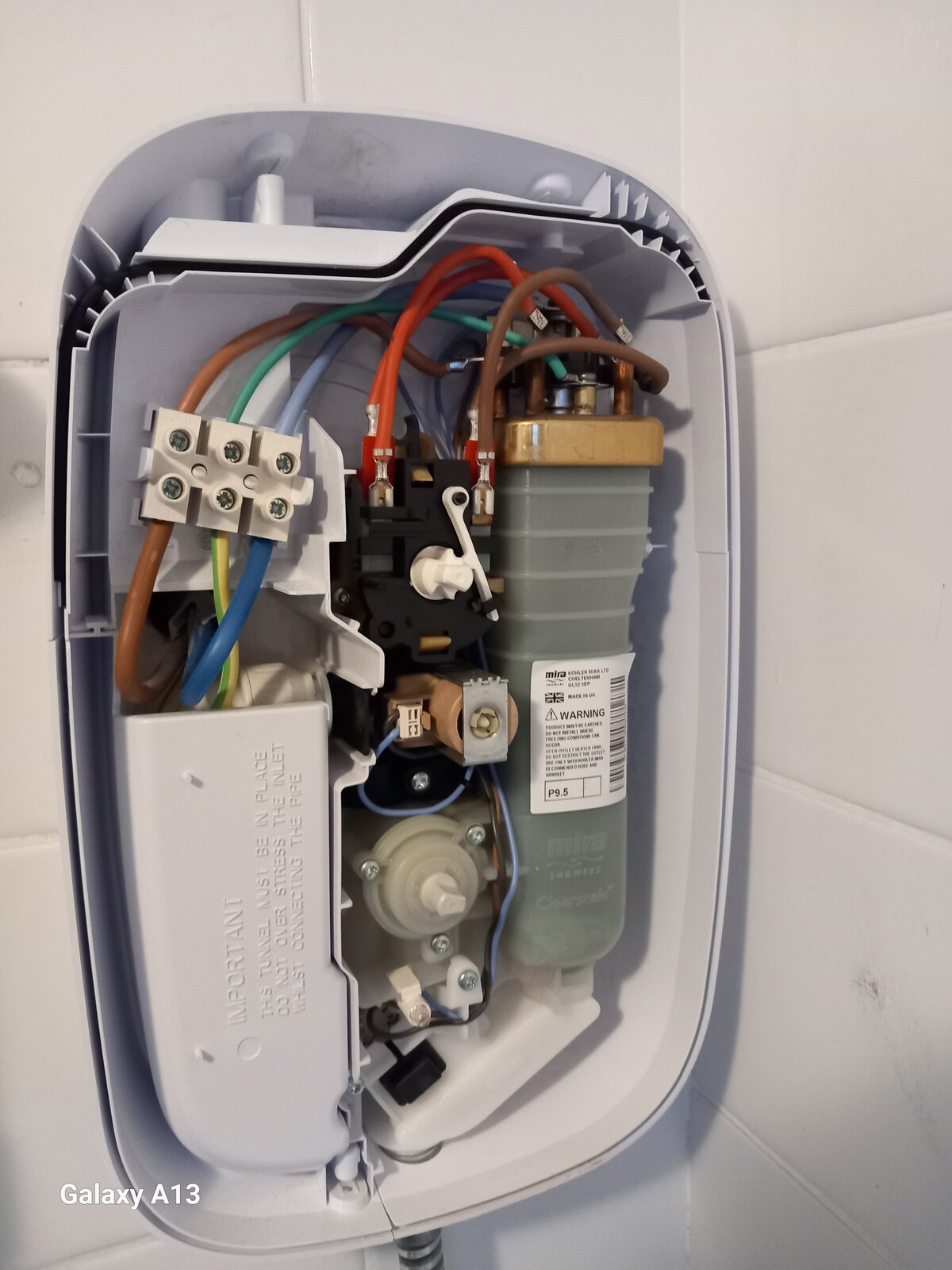

Either the shower unit is not getting a 230/240 volts supply ,or there is a fault within the shower ( possibly the solenoid).
You would need an electrical testing instrument to determine which it is.
Usually the MIRA's have a light on the power button, not sure with that one though, never fitted a Play.

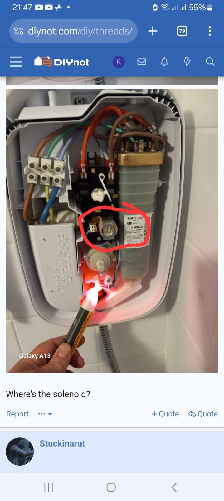

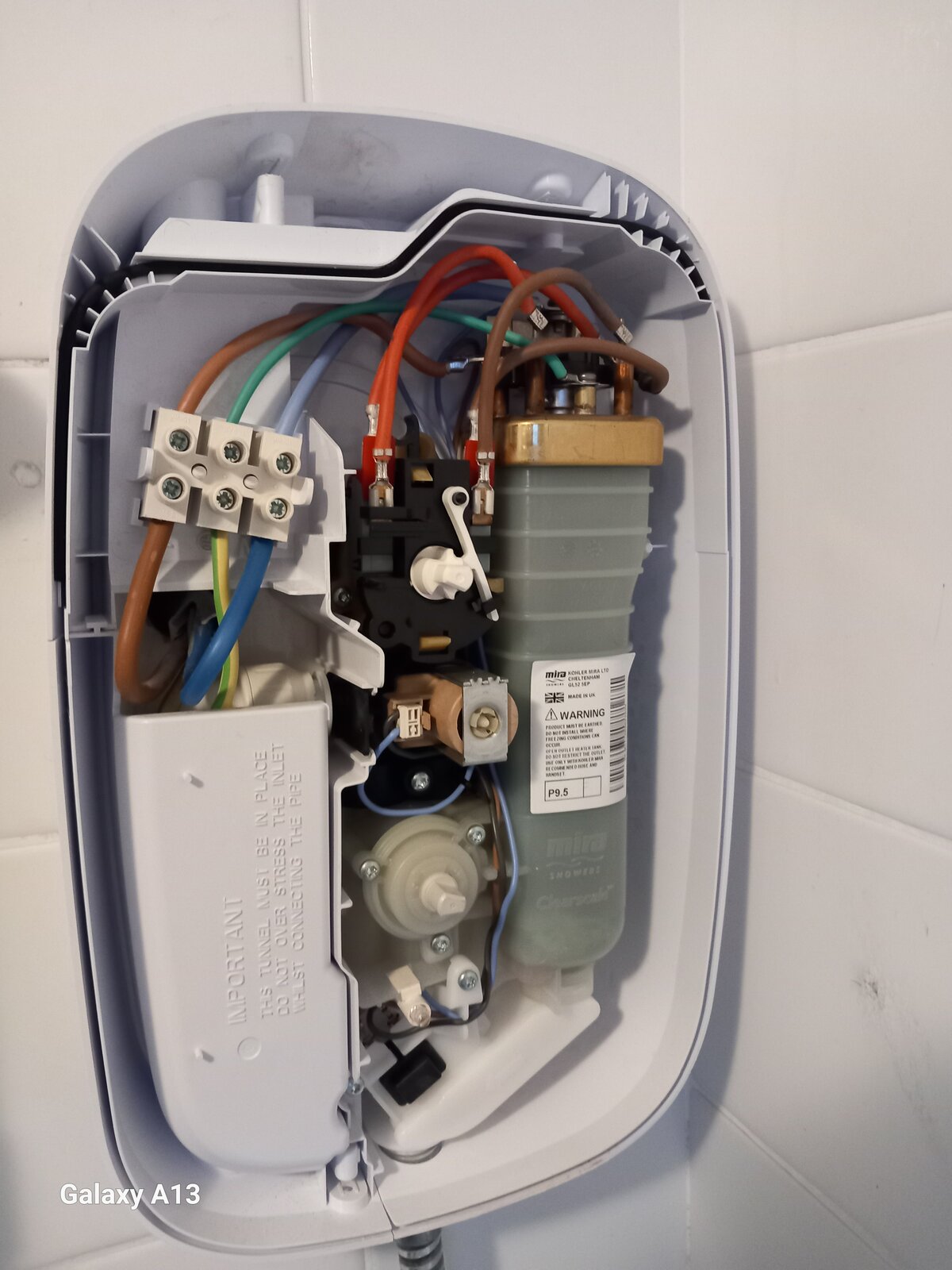

If it is getting power to the unit then as suggested it'll be a component failure, like the solenoid.
Yes ,you can buy a new solenoid. But first you need to establish the voltage at the showers main terminal block between live and neutral is 230/240 volts.

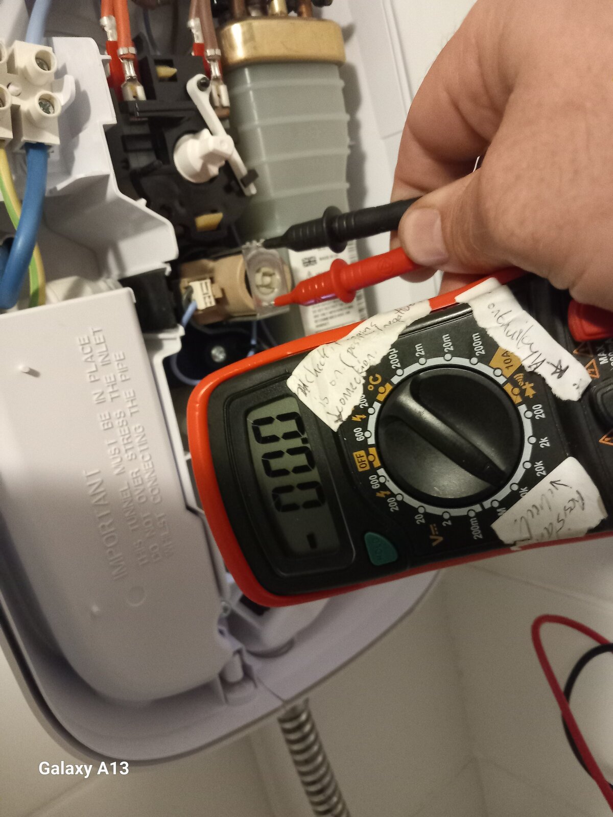

The solenoids resistance can be checked with a multimeter to determine if that's at fault .

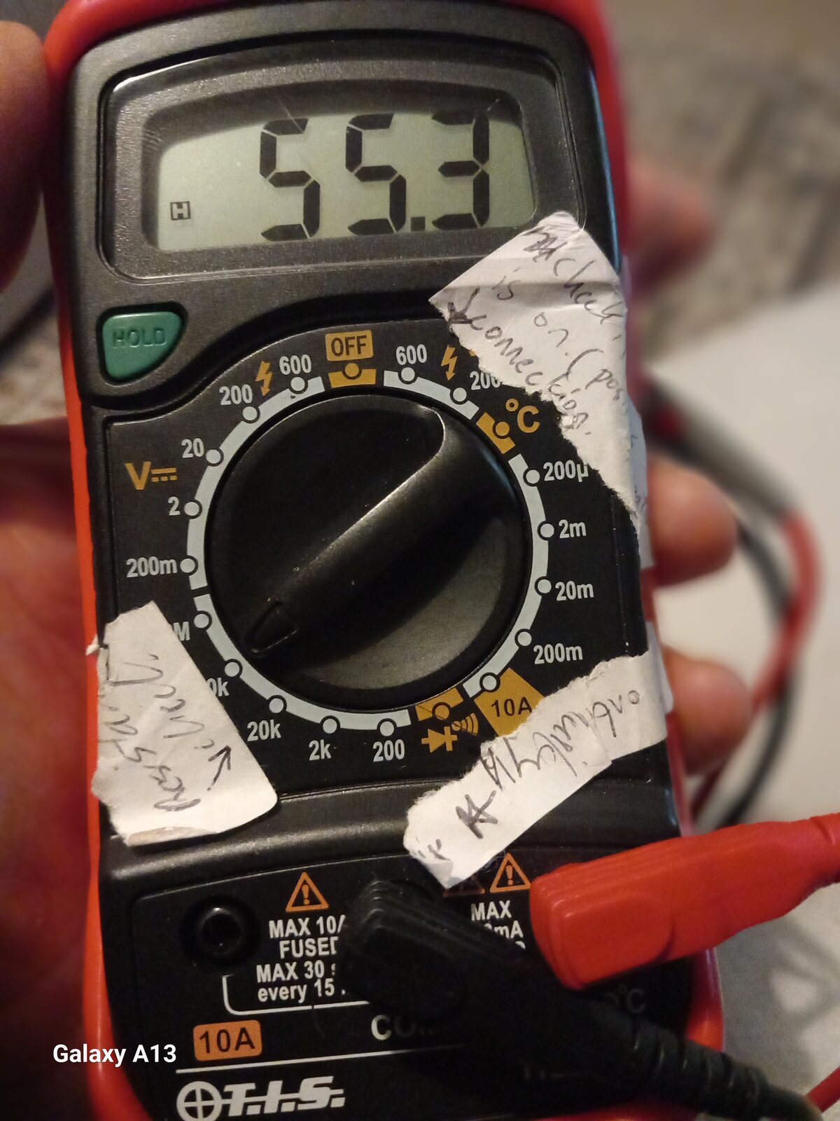

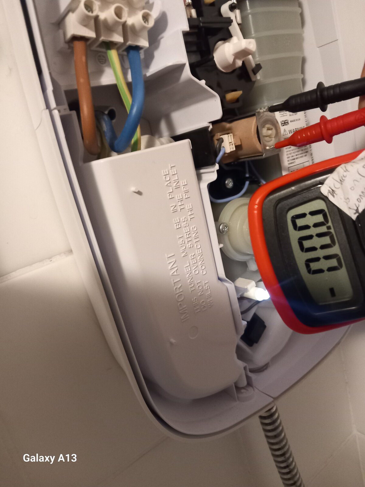

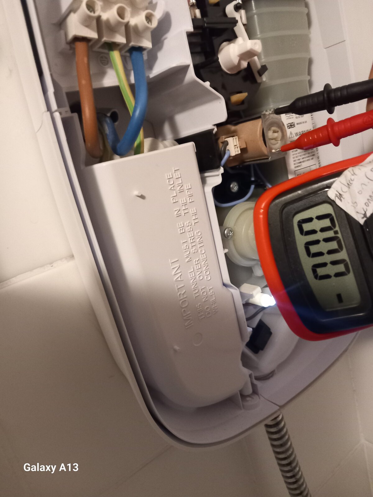

Have I checked solenoid with correct setting on multimeter? I did it with electricity off.
The resistance check the numbers went up then down to 0 quickly but i pressed hold quickly and got 55.3.
And correct setting for voltage and placing of probes for that?

Yes that appears to be a failed solenoid, should be around 4kohm.

View attachment 385347View attachment 385348View attachment 385349
Normal coil resistance should be ~ 3.0K to 3.5K.okms, 3000/3500 ohms), Set the resistance scale to 20K and see do youget a steany resistance reading of 3.0 to 3.5 ish, it will not read the correct resistance even on a "good" coil if set to the 200K, I have a old Triton coil in my box and it reads 3.75 on the 20K scale but on the 200K scale jumps around a bit and then reads _1 which is meaningless really.
