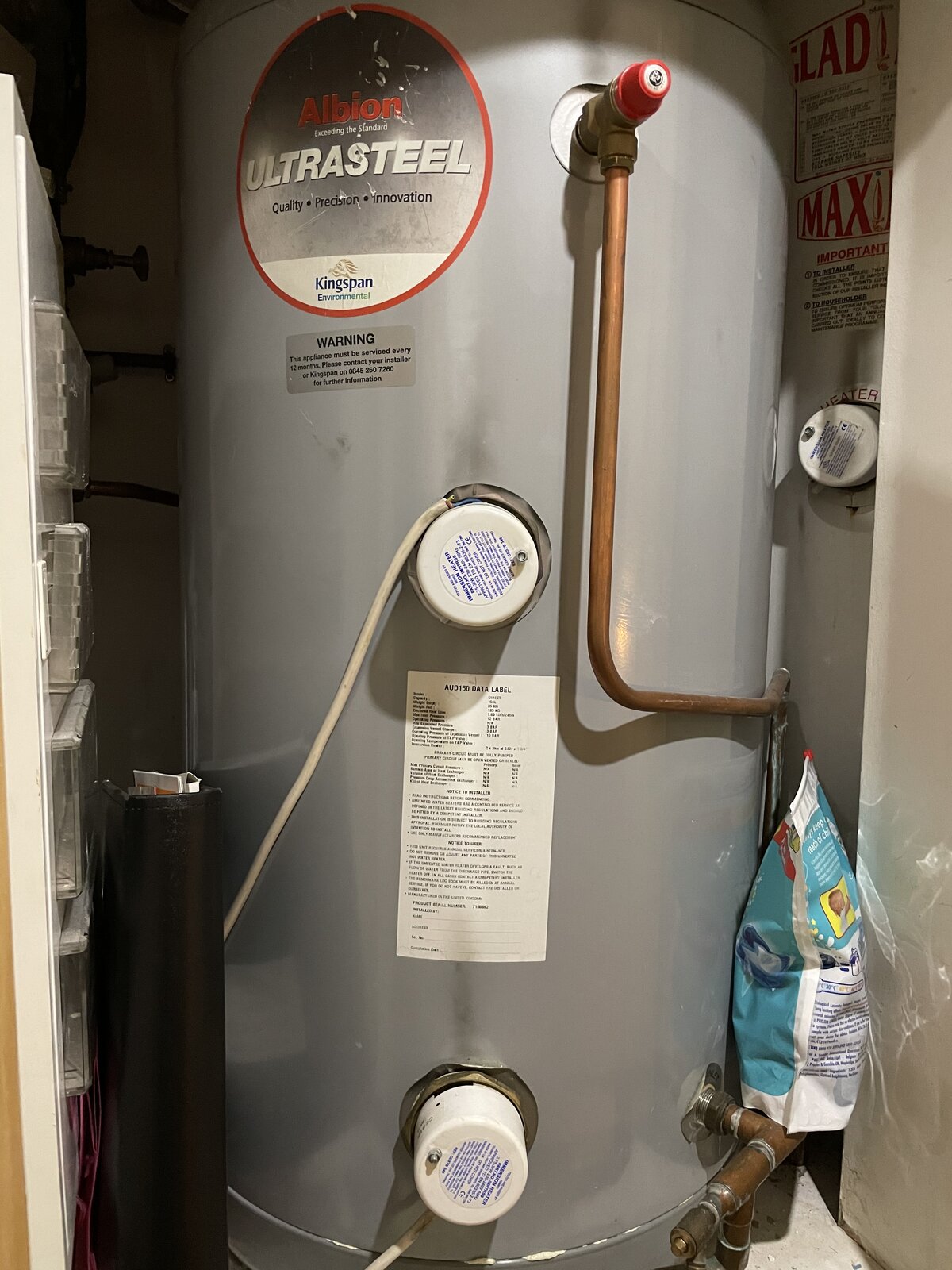

I have a boiler that has an upper and lower attachment and they both have dials in and I don’t know which controls the temperature of the water.
Pls see photo attached.

The two immersion elements have adjustable thermostats under the cover ,ONLY remove when electric is isolated to them

Your HW cylinder has two immersion heaters, the bottom one will be on an off peak supplu, heats the water overnight, the top one is a boost that you have to manually set to on and is more expensive to run, the thermostat on the bottom immersion has probably failed, very easy to replace and not expensive

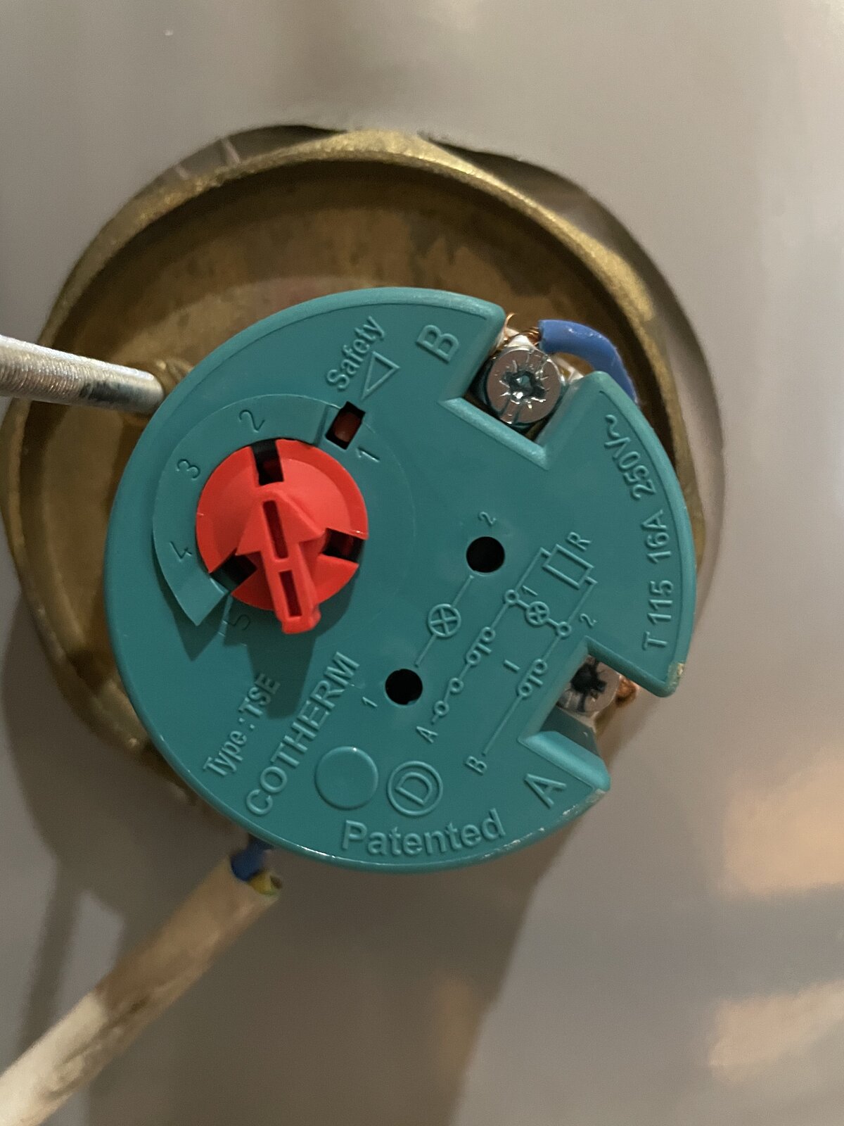

The top one is a booster and only powers up when you press the boost switch, the bottom one is the constant use one , post a pic of the bottom one saying 1 to 5
I’ve turned the bottom one (green one) down to 2.

1. That is not a boiler, its an direct, unvented, hot water cylinder.
2. As others above have stated, both thermostats should be set at 60. If they have numbers 1 to 5 instead of degree markings, 4 will be around 60.
3. As others have also stated, the lower immersion heater is for the overnight rate (if you have a dual rate meter) and the upper only needs to be switched on if you run out of hot water during the day.
3. Those cylinders require an annual service for safety.

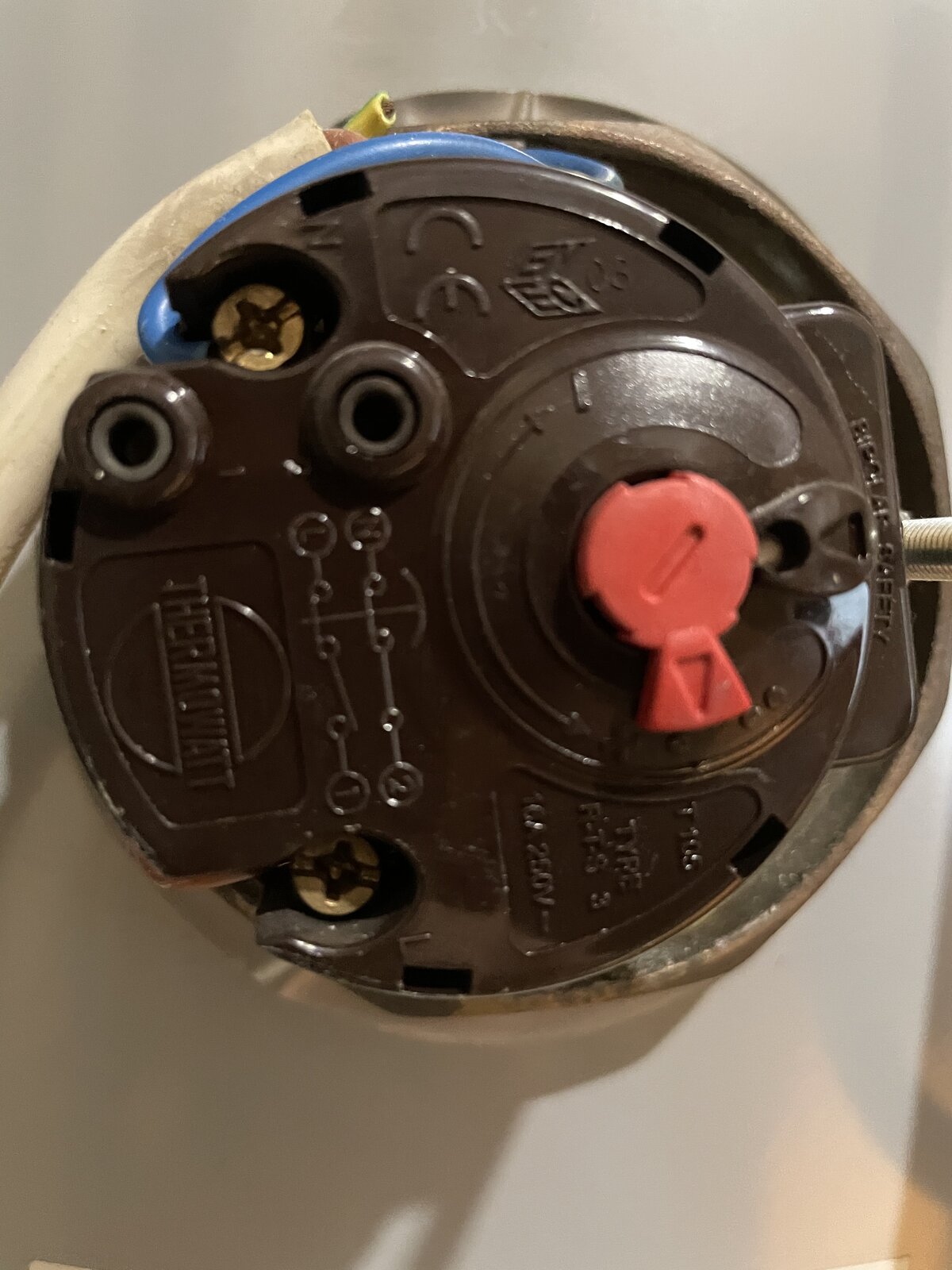

4. I don't like the look of the cable to the upper immersion heater. Both it, and the casing of the cylinder immediately above it appear to be heat marked. It might be that the electrical connections inside the immersion cap are not fully tight and are arcing. However, it might just be heat rising and taking dust with it. The cable shouldn't be wound round the cap like that.
5. That bag of whatever is obscuring the tun dish, which is part of the safety devices for the cylinder. It shouldn't be there.

The top one doesn’t have numbers, it’s a dial without any markings. Should I put it where I’d imagine 4 (out of 5) would be?
It looks like the earth wires have been chopped off as well. Don't know how important earths are with immersions but my immersion is earthed via the cover securing stud. The other thing I think I can see in the OP's first picture is another immersion heater cap to the right of the cylinder. What would that be for?
