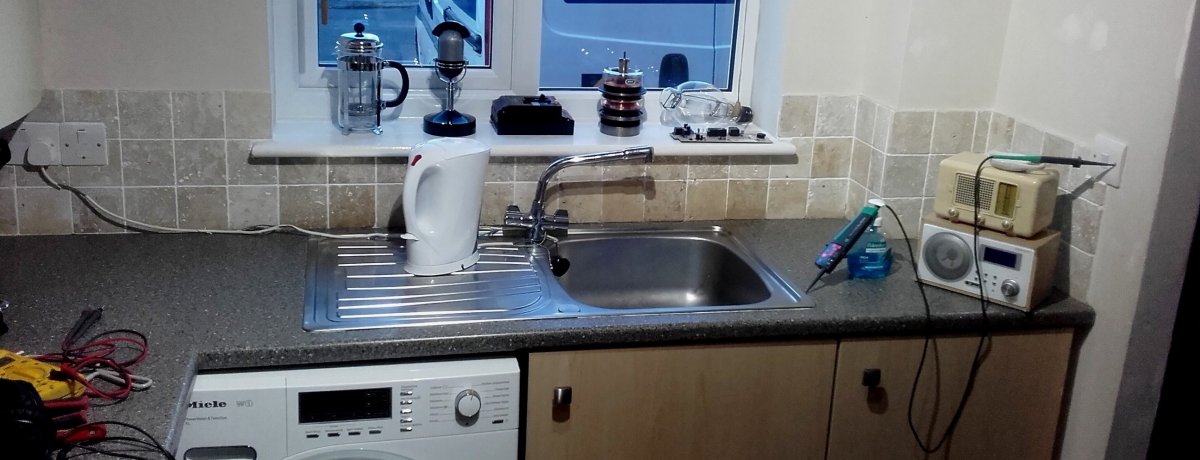

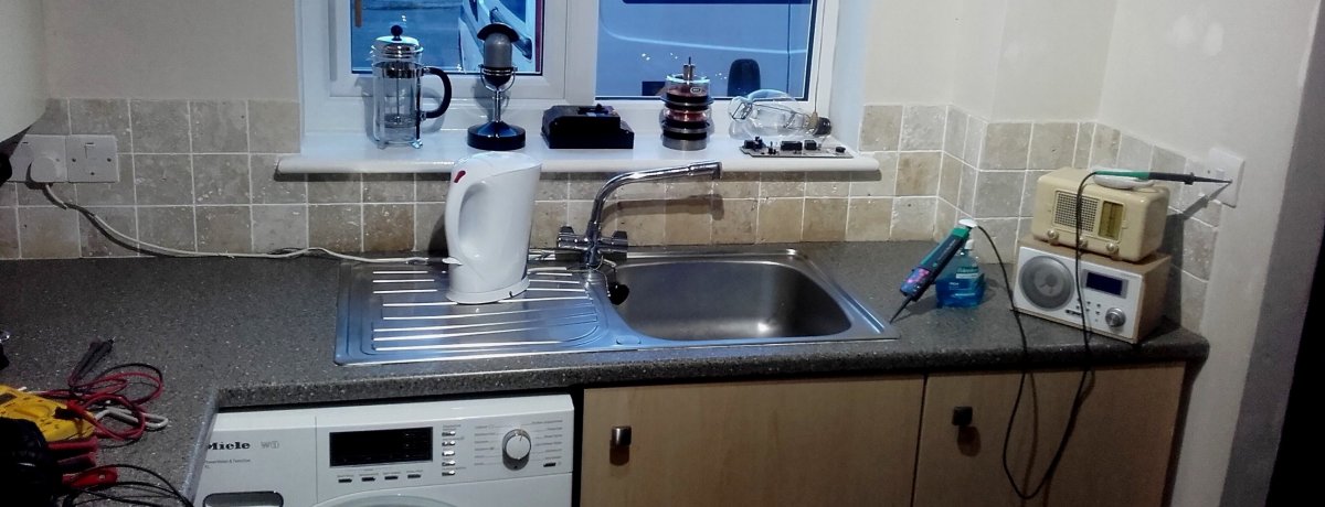

Goodness me, I wish I had come across this thread sooner, a couple of weeks ago I received an electric shock from my kitchen sink! My frayed kettle lead was wrapped around the kitchen tap and one of the wires had got trapped between the bottom of the tap and the sink, the sink then became live!! I know now to wrap up the exposed parts of the kettle lead with tape. To be extra safe I asked a neighbour about it and he said the sink probably needed earth bonding so I bought this book from Amazon which helped explain what I needed to do. I now have quite a lot of earth wires around the kitchen but at least the sink won't become live again.
The book also prompted me to check the leads near the radiators, almost all the radiator pipes had frayed flexes around them! What an eye opener! I have ordered some more earth wire to make the radiators safe, and as also noted in the book, I will put earth wires to the wrought iron newel posts on the stairs to protect against shock when the vacuum cleaner flex rubs against them.
