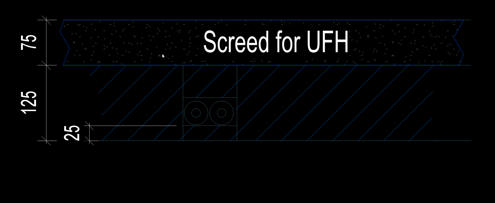

we have a very similar project and have hot and cold water to a kitchen island sink but we will have underfloor heating in the floor screed. (make up is block and beam floor, 125mm insulation and 75mm sand and cement screed)
My plan was to run barrier pipe for the hot and Cold pipes with no joints insulted in in an insulation`tunnel' with 25mm insulation over the B&B floor first.
can anyone see any issue with that method?

the original post doesnt mention UFH but our install has UFH hence my proposal to run pipes in insulation as per my sketch. any thoughts anyone?

It would make some sense to keep the cold separate from the heating, but the hot can run through near. Your sketch seems sensible, so long as the H and C have insulation between them.
