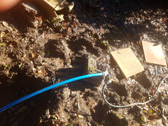

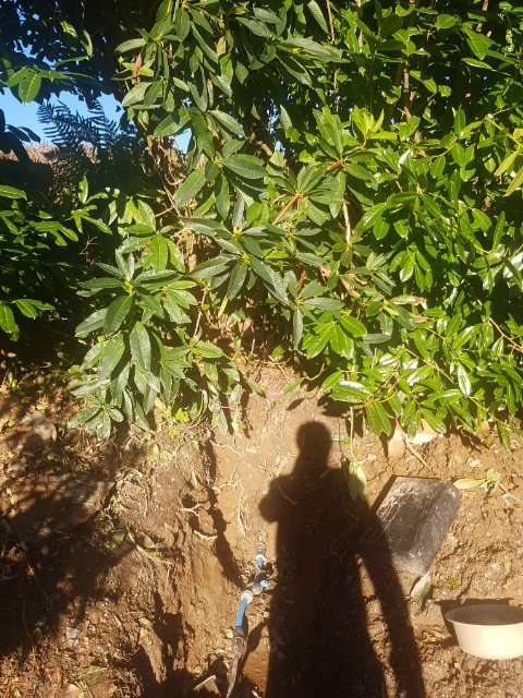

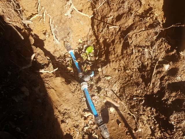

I had to replace the stopcock recently due to the last one breaking. This is nearest the hedge facing the edge of the properties boundry (so nearest to the road).

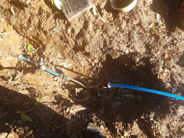

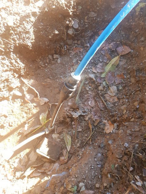

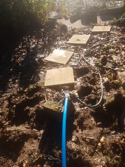

We had to get the connector to fit the samller black pipe u can see at the bottom on this pic this is the conector you can just see on the last pic I put up). We are now facing towards the house. It then goes into the old brass conector, again the black pipe going up we got another conector to fit the new blue pipe which goes just to the outside tap, the other side at the bottom brass conector did continue to be a small black pipe but because ive left it mud has fallen on it, this continues towardsthe house but I havent dug further yet. As it might be difficult because of the concrete steps and path maybe?

The black is an older install than the more modern blue pipe. Both look adequately sized, larger will not normally help the flow. Pressure and flow are two entirely separate values to assess.

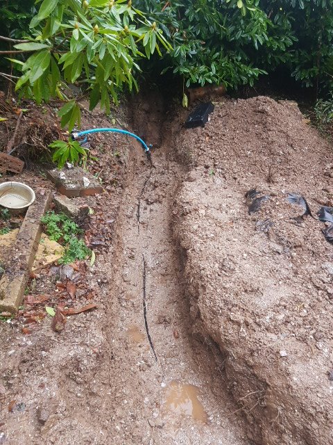

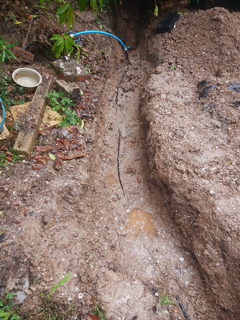

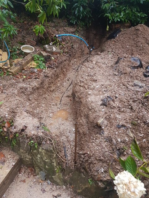

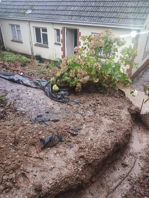

Here are the pics of the bigger trench now going to the house. When looking at thehouse, to give you an idea, of the three large windows, the middle one is the bathroom where the pipe goes in. The one to the right is the kitchen. I was hoping the pipe would go along the garden and then go down under the path but it looks like it goes down under the path near the kitchen all the way along to the bathroom.

I dont think piecemeal replacement is going to achieve very much, the whole installation is governed by the bore of the smallest section of pipework. I'd be breaking into the pipework at the boundary, see what pressure and flow figures you get there. If these are not substantially different to those you're getting in the house, then you're wasting your time doing anymore.
Ask the neighbours if you can check their flow/pressure rates, again, if these are not substantially different, then the issue may well lie in the supply to the area, unless its below the statutory minimum, unlikely the Water Company will do much.
Your measurements give the flow. The additional info you need are the static pressure (water pressure with no draw on the system) and dynamic pressure (pressure with full draw). Big pressure drop generally indicates a restriction in the pipework.
