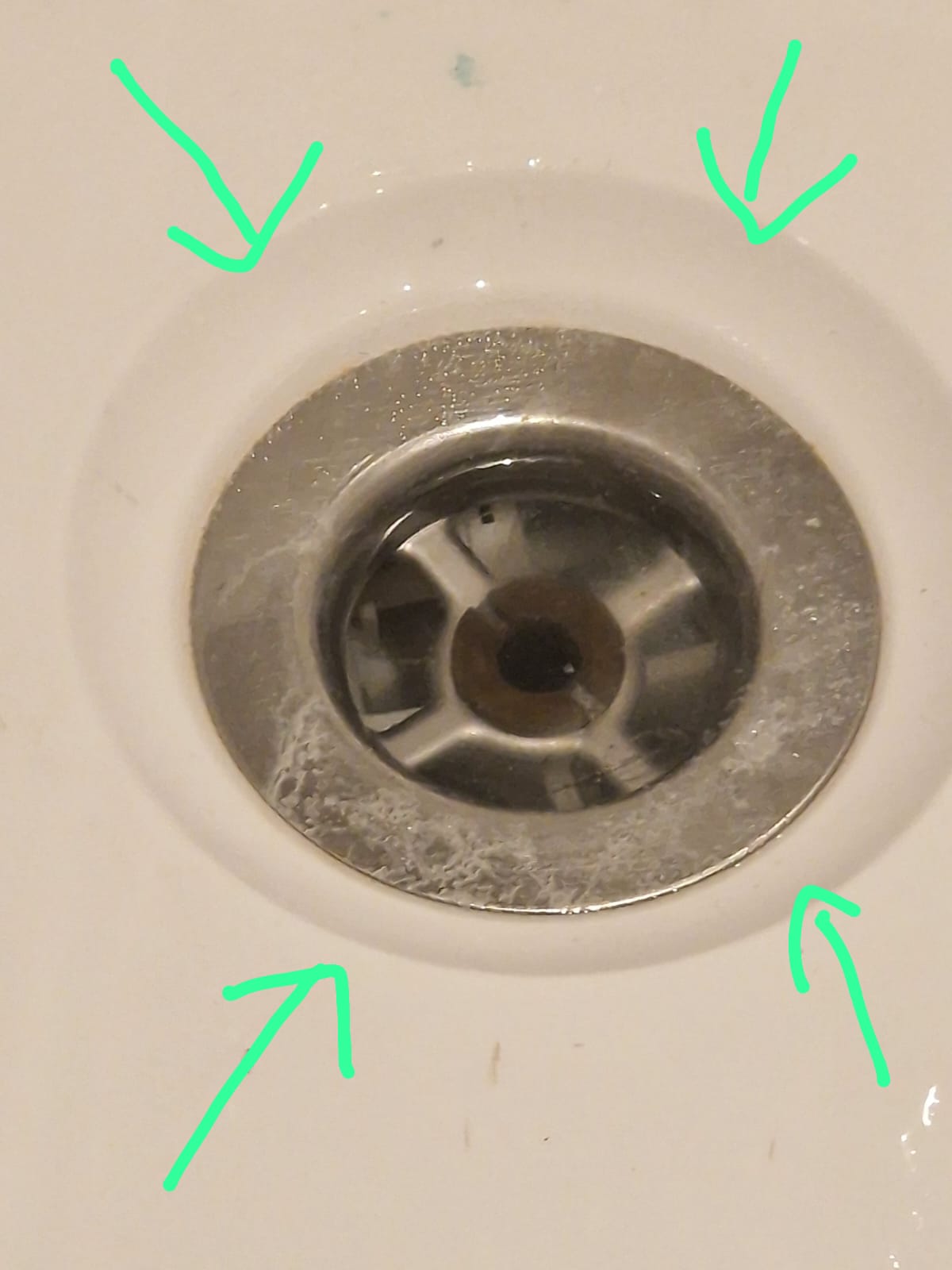

What are the most likely causes of water remaining in the plug hole after the bath has drained and how to fix? This is a bath in a rented place and the recently replaced bath panel has been completely sealed with silicone, so looking for possible fixes that don't involve taking it off. The arrows in the photo indicate the water level.

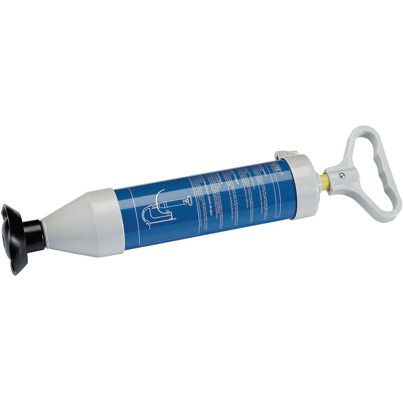

If the water isn't draining away fully then there's a restriction somewhere. As suggested, buy yourself a pump plunger, cover up the overflow and get pumping.

Yea it drains normally then stops at the level shown in the photo.
That implies that somewhere the pipe work is too high

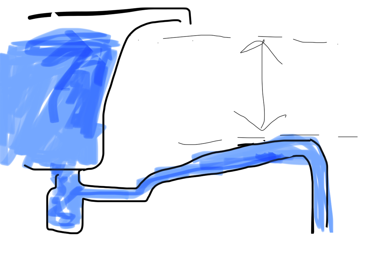

Imagine the cutaway side view looks like this:
If the pipe from the trap runs uphill til the bottom of the inside of it is level with the depression in the plug hole, it will drain while the bath is full of water

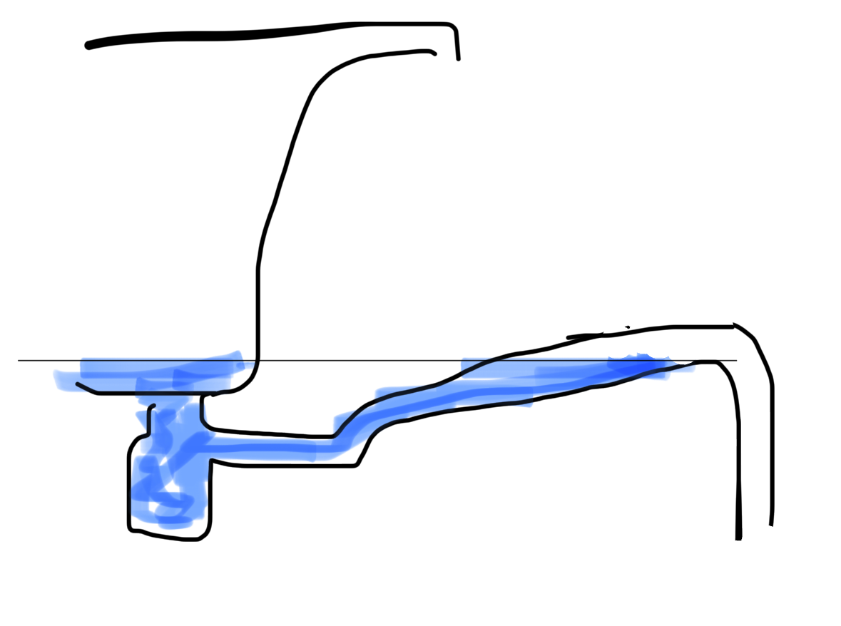

But as the bath level falls, there isn't a height difference to push the water over the "hill" of the pipe any more and everything comes to rest with the water level equal on both sides of the dip formed by the trap

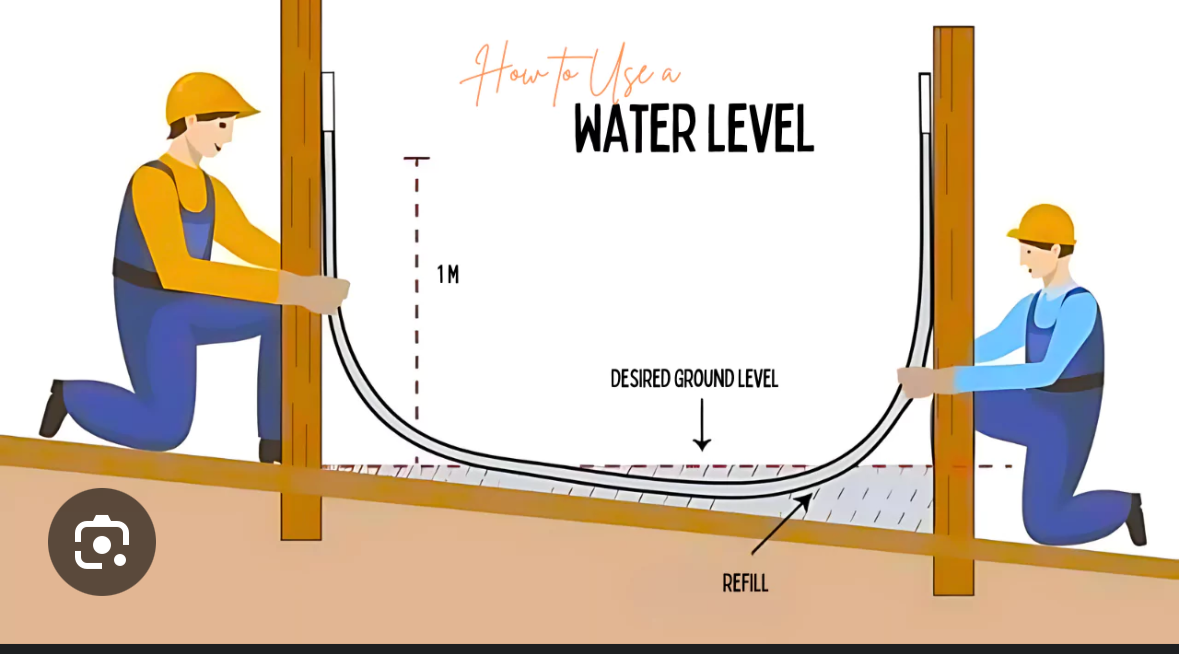

Interestingly this is the same concept as a type of measuring level used over a big distances on building sites where two glass tubes are connected by a flexible pipe and when held upright the water finds an equilibrium where it's at the same height at both ends. in the glass tubes. The ground/structure etc can then be marked at the height of the water and it is known that those two points are the same height, and can be measured from to eg ensure two walls 10m apart are built to the same height
