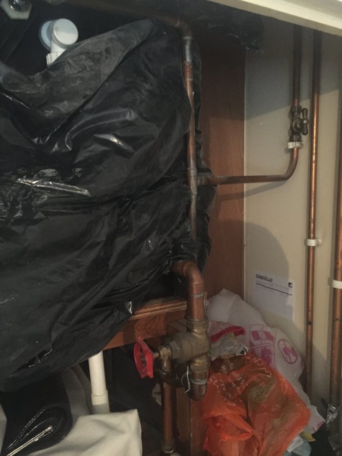

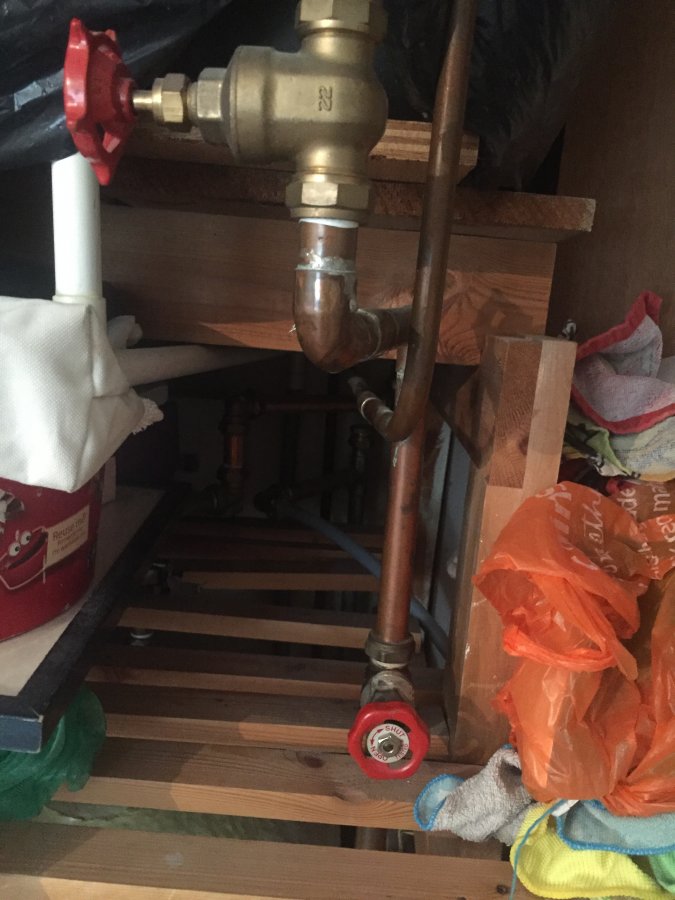

Water pump installed properly??
The feed to the pump is not providing enough pressure to "prime" the flow switch.
Without being able to see the whole arrangement and trace routes, bores and inline fittings - it's impossible to tell.
How much does the cistern water drop by when pump is in use?
Maybe that Surrey flange is sucking stuff up from cylinder and getting blocked!
The tank is in the same cupboard just above immersion, I have a small tank in loft also
