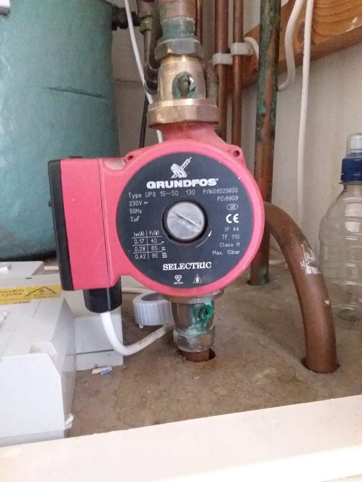

    Water pump was roasting hot but no hot hotter. I tried unscrewing the big screw and rotating pump a few times to no avail.
    Closer view:

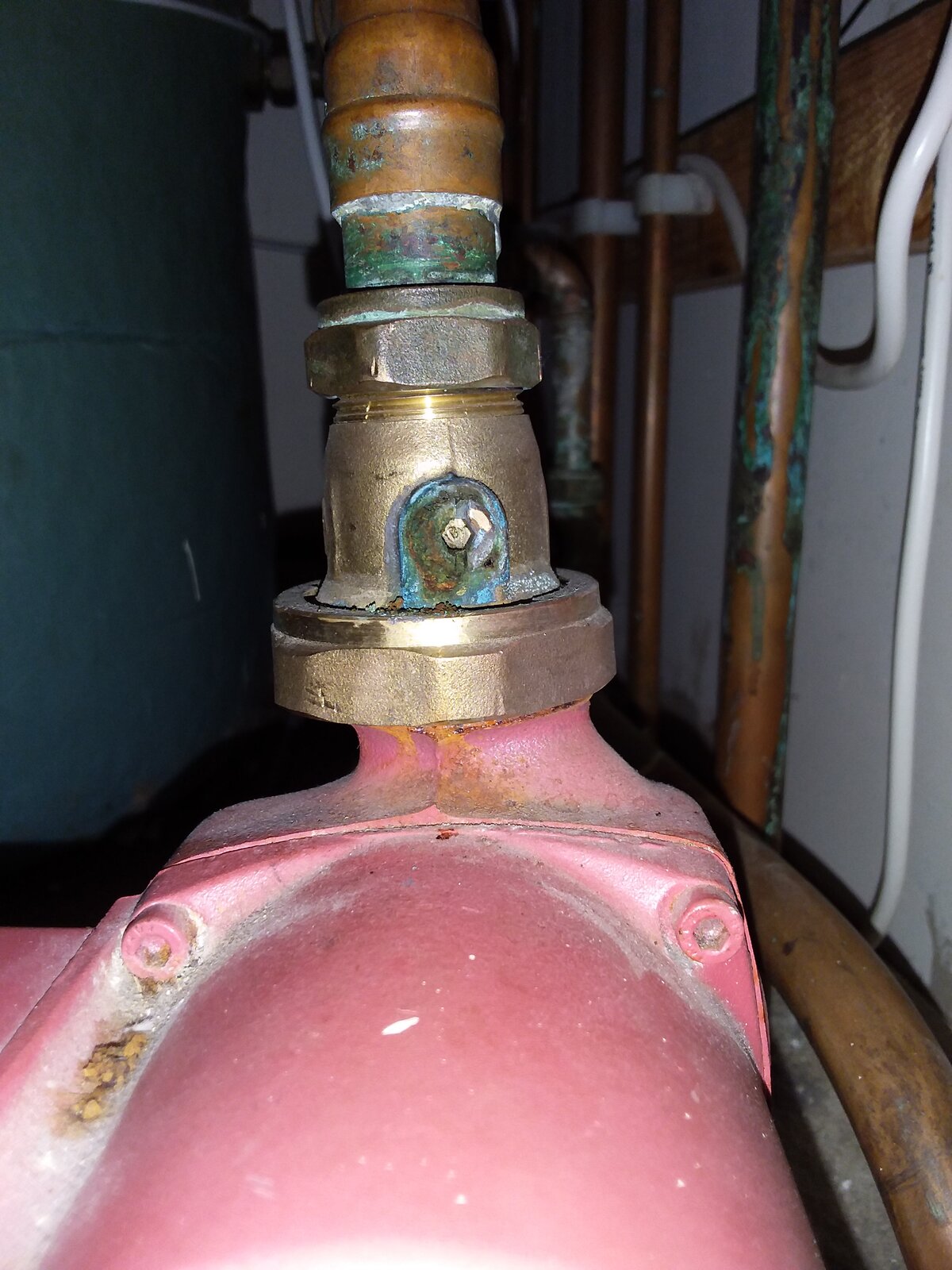

    Allan key valves above and below:
    I guess I should just isolate the two valves (above and below), turn off electricity (of course) and then replace the pump?
    I've not done this before, though have watched a few YouTube videos. I feel reasonably confident.
    Should I replace the two valves as well?
    Any thoughts, in looking at the photos?
    Anything else I should know?

    Have you checked that there is power getting to the pump? If those isolation valves ( the Allen key ones) actually work then you won't need to drain down to swap the pump. If you want to replace the valves then you will need to drain the system.

    I tried an Allen key on the bottom valve but it wouldn’t stop weeping, ever so slightly. On rotating valve back to original position it still wept.
    Draining entire system now.
    I presume to state the obvious that these valves need replaced.
    No I haven't checked if power getting to Water pump. I have a multimeter, advice on how to determine if electricity is getting to pump?

    Red and black probes connected to pump terminals marked L and N, on an ac range greater than 240v (probably 500 or 1000v). With pump powered, meter should show around 230/240v, if powered.

    The pump is 22 years old. I'm wondering as the bottom valve weeps now that I've adjusted it and will need to be replaced before flooding the system again; I'm thinking, just replace the pump too. Afterall, it is the likely culprit.
    If after replacing the pump and valves, it still doesn't work, then it's time to call a plumber.
    At least he/she won't be able to say "The pump needs replaced".

    No chance those isolation valves will work unfortunately and certainly not without weeping by the looks of it. It is likely the pump if as you say it's hot but no hot water, try the heating first though. If that doesn't work it probably is. If it's an open vented system (small tank in the loft) I'd certainly leave it to a plumber to change pump and valves.

    OK, I'm assuming fro pics it's a gravity fed system, ie you have a small tank in the loft that feeds the CH system.
    Isolate leccy feed to CH system
    Go in loft, and bung the outlet of the tank, bung the pipe which overhangs said tank.
    Go find a drain on a radiator, open into a bowl, you'll only lose a pint or two before a vacuum forms in system.
    With towels in place, undo pump unions, (having noted direction of flow), remove pump, replace scabby pump isolating valves at the same time.
    Remove bungs from tank
    Open vent plug on pump, & rotate impellor.
    Switch on heating/hot water.
    Charge yourself as much as you like, & demand a BJ from wife for your efforts.

    Yes, I do have small tank in loft. I have 'bunged' (closed off?) water supply to it and system is drained.
    Undo pump onions? That means the nuts?
    When you say "open vent plug on pump", do you mean the screw on the front to vent?
    Now which pump should I buy? This would be a direct replacement (I think, though this one says UPS2 and mine says UPS).

    Yeah that makes sense, as long as you do use it every so often as it's more likely to get stuck rather than wear out if it's not as good quality. I never realised how much the UPS 2 cost, I work for housing associations so it's all paid for on accounts. The original one you have only used to be about £80. The one you are looking at is exactly the same size (130mm) so will fit in fine, definitely change the valves though so it's much easier to replace in the future. Either the same as yours or slot-headed ones, not wheel gate valve types as they are a tad longer.
