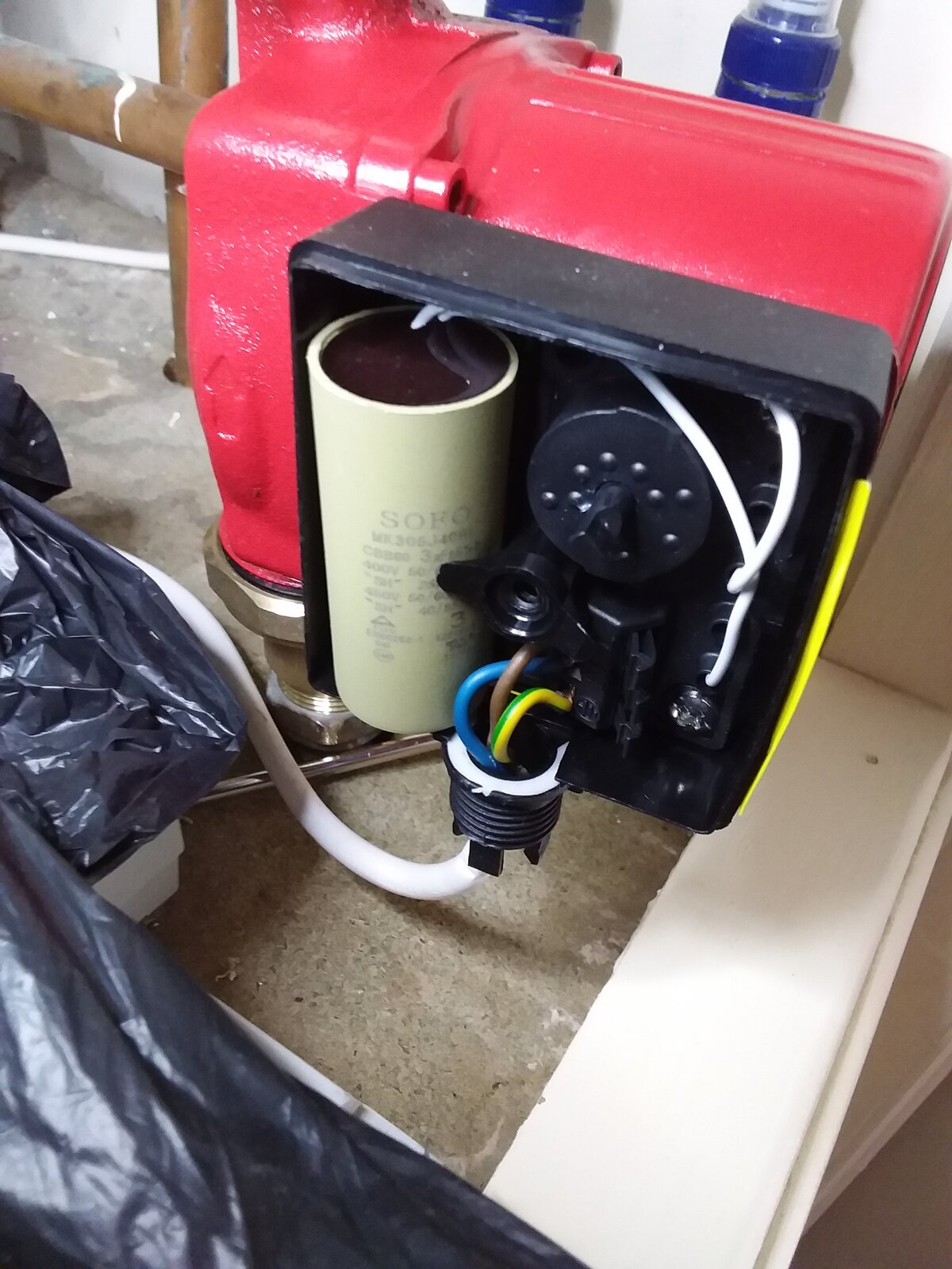

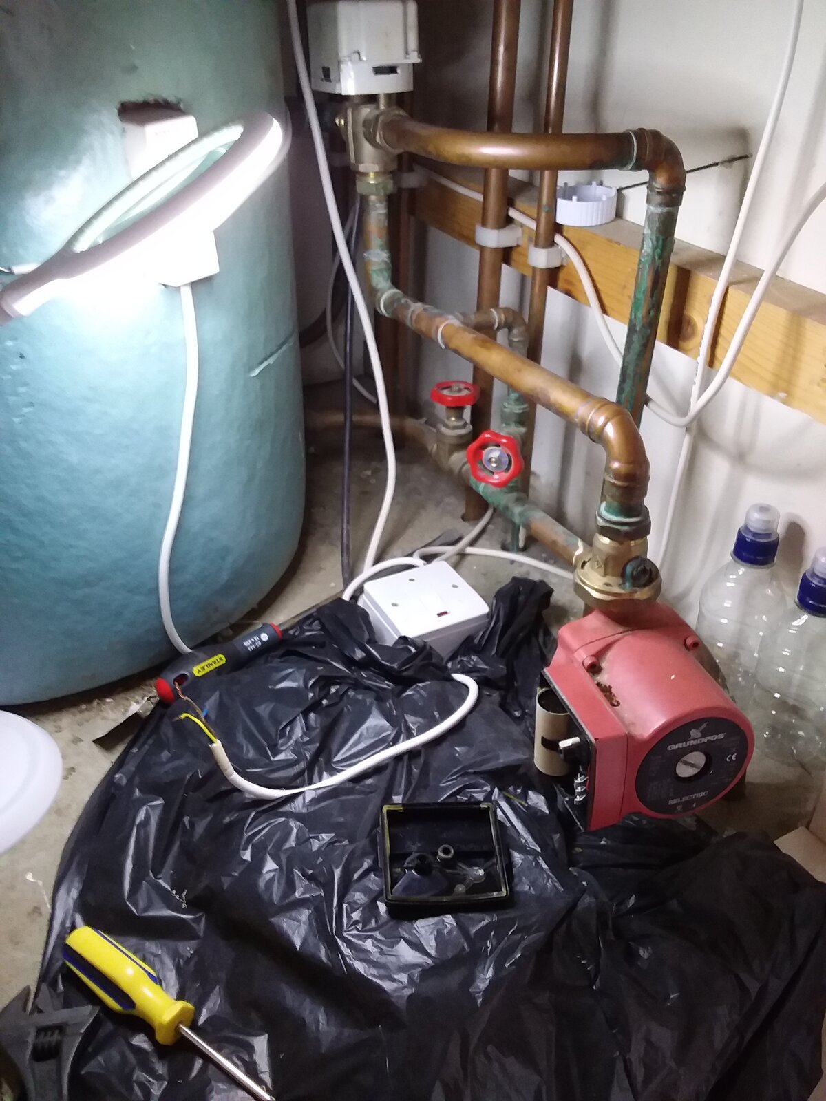

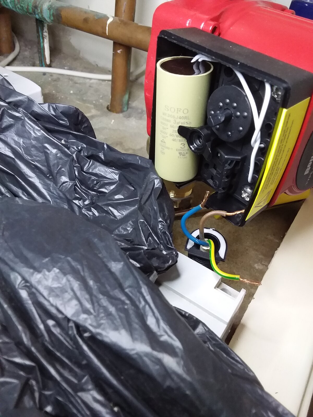

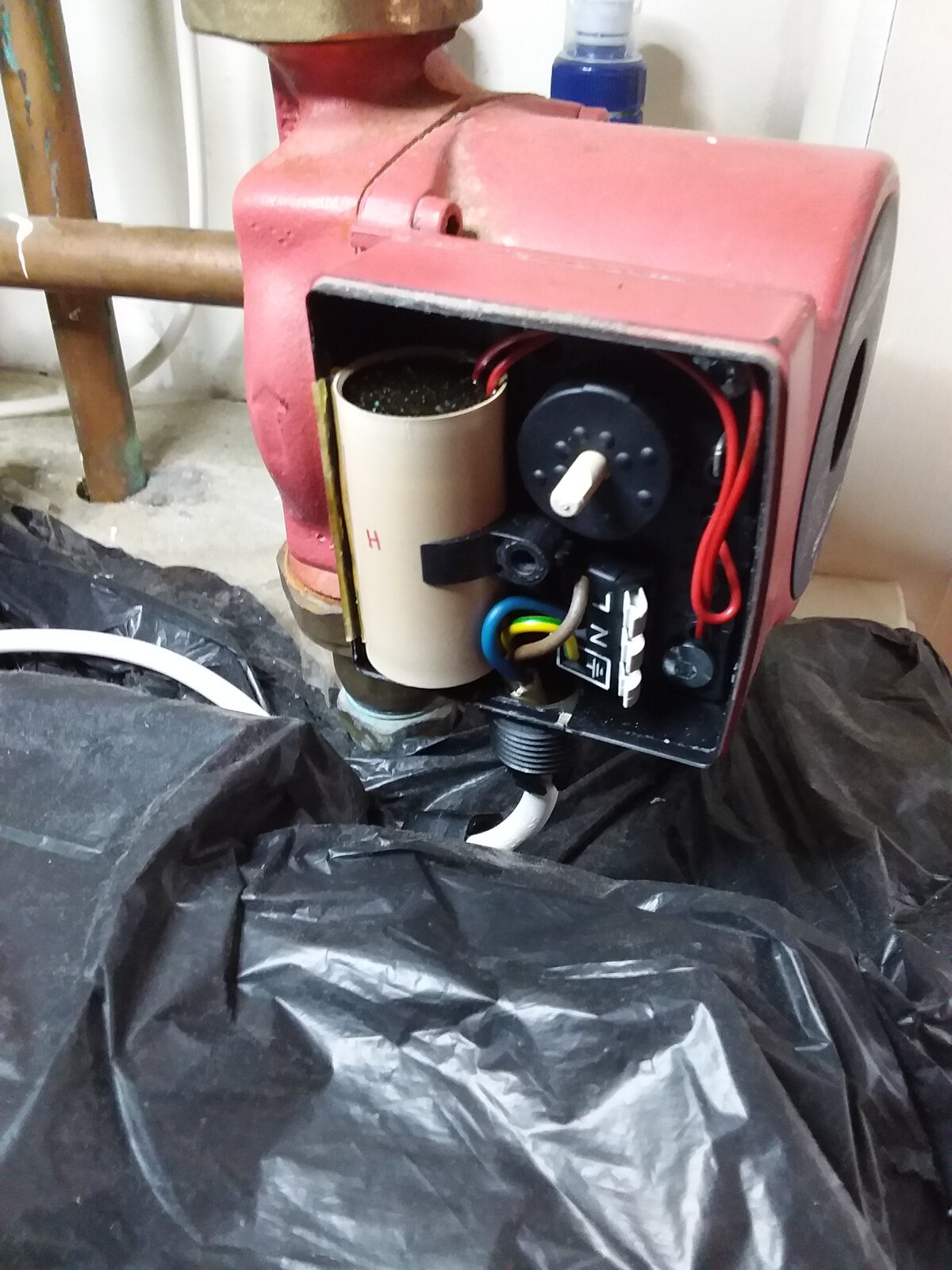

Had to remove electrics from old pump:
This wasn't too difficult, just push the clip and pull out the wires.

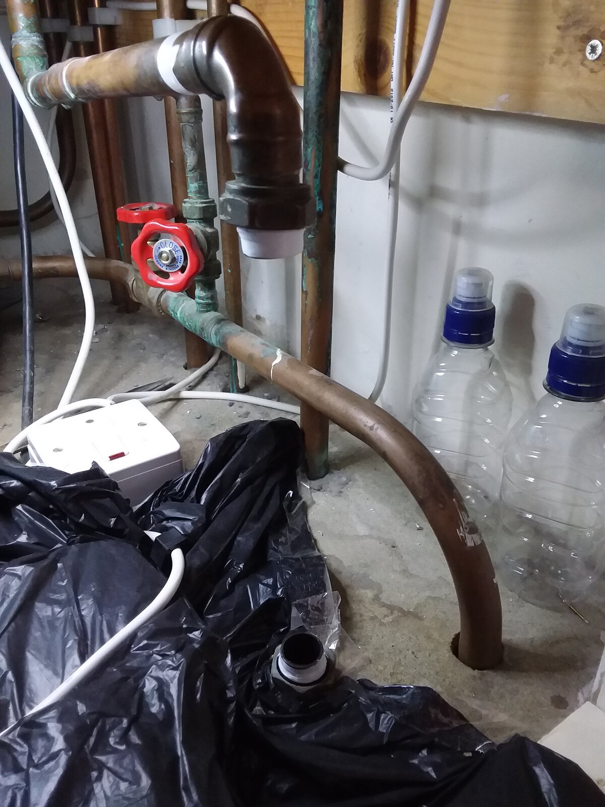

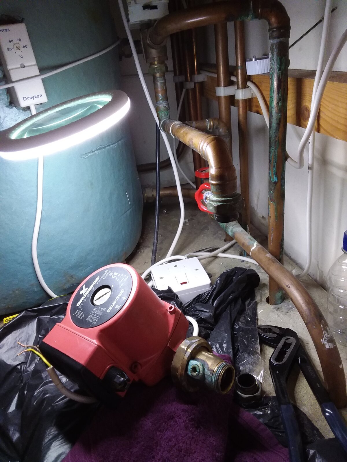

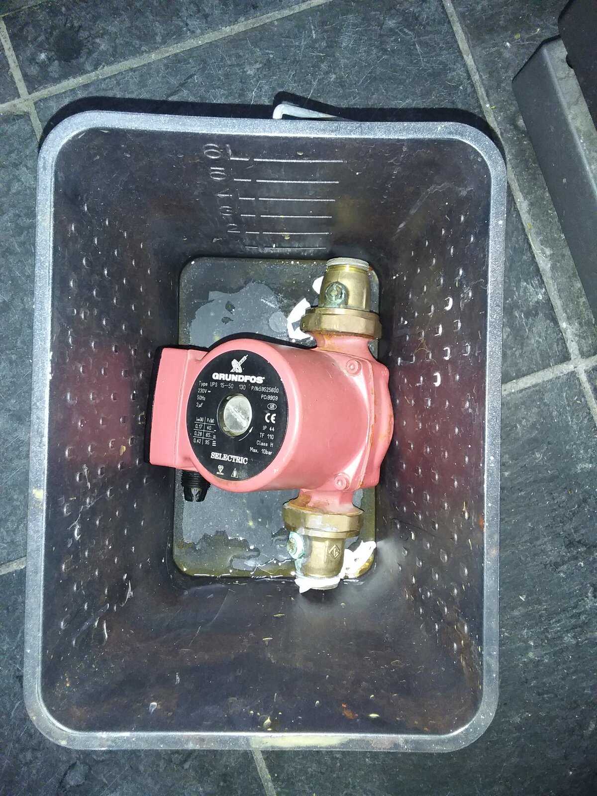

It was easy to loosen the top nut but the bottom one took considerable force using the largest long armed wrench I had. Once the nuts were off, by manipulating the pipe a couple of centimetres, the whole thing came off as a single unit.

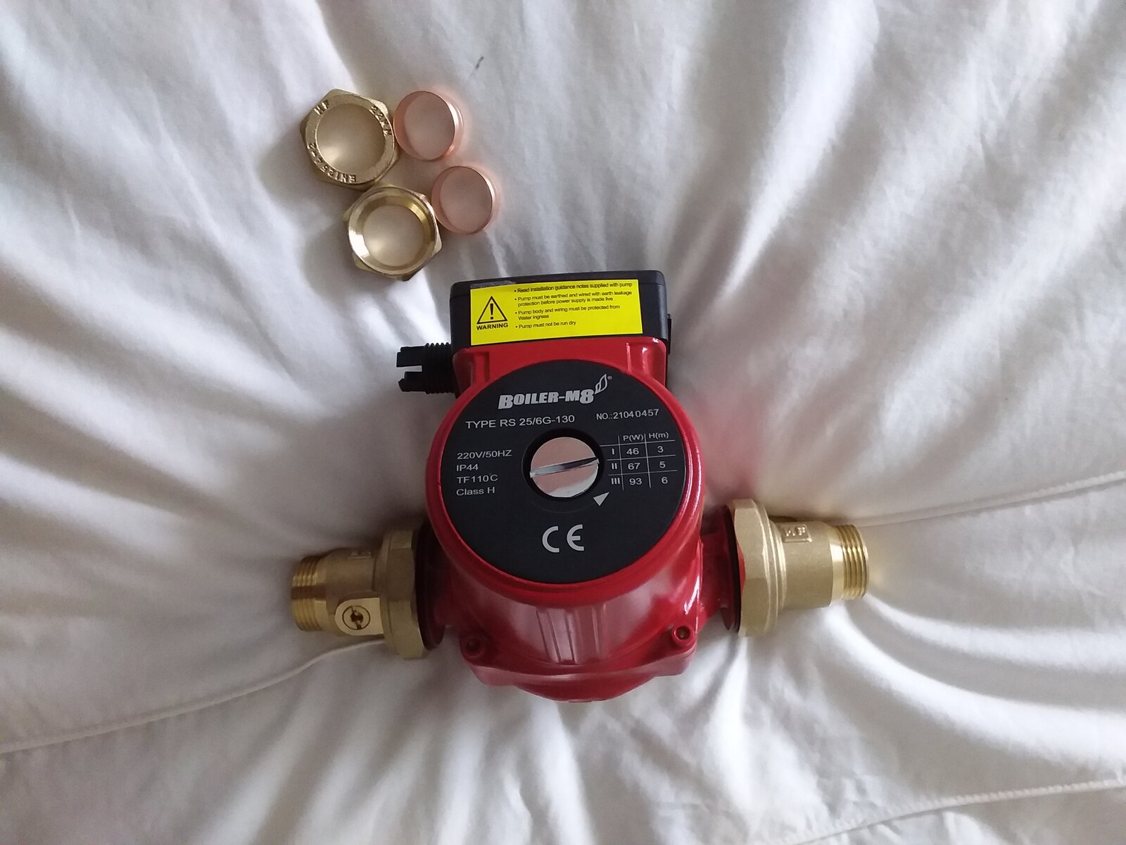

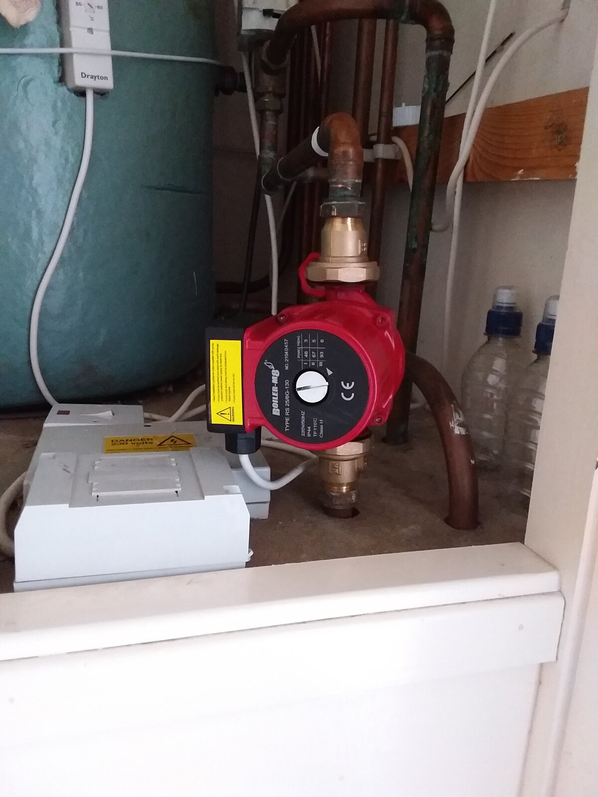

New pump with new valves fitted. The new olives and nuts, as advised, were not used.
It was difficult and fidgety to attach some PTFE tape around olives.

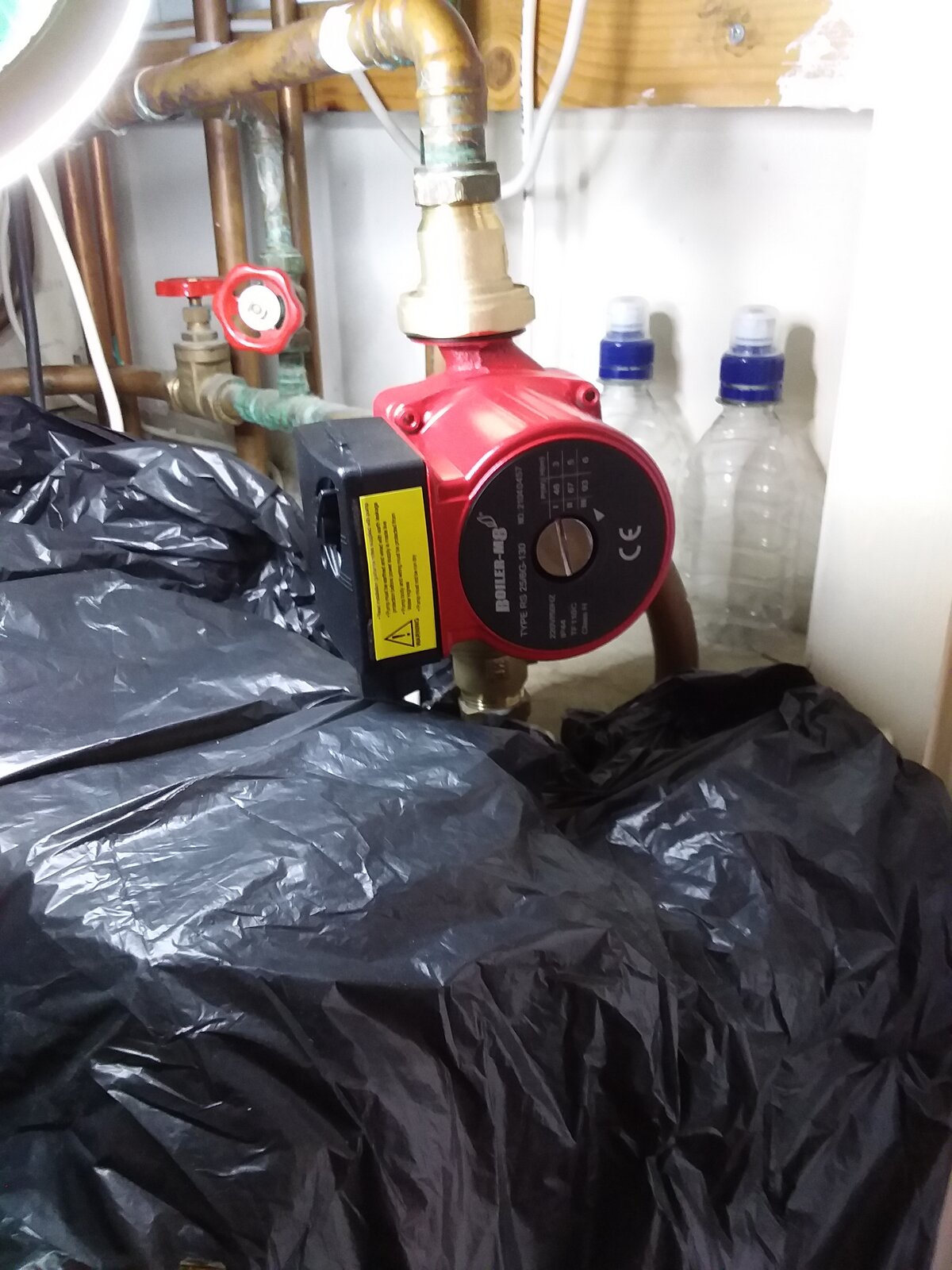

The new unit fixed very easily and tightening the nuts was no trouble. Though, I ended up with the valve screws not pointing front.
The electrics, easy enough.
The clips made it simple.
Job done!
I take it this can't go in a normal bin and needs to be taken to recycling/disposal ground?
After flooding the system and bleeding it; it was time to test.
No leaks, no drips - thank God!
Heated up the water perfectly.
The new pump appears to be more efficient than the last; I could put the new pump on setting I, and it worked well. At setting II, the entire system was louder, sound of water pumping through. At setting I, more a gentle action with the desired result of water heating.
I'll of course experiment with the settings.

Too late now for you, but I would have used gate pump valves because in my experience the quarter turn ones "always" leak !
I do not understand why you could not fit your valves facing forwards because when the nuts were loose they can be rotated as you desire.
I would expect to be able to rotate then even now on a gravity system by slightly loosening the two nuts without needing to drain the system.
Boiler M8 pumps do not last long in my experience. When you replace the pump next year, I'd recommend going for the genuine Grundfos pump and also having the valves facing the correct way(!)
But aren't gate valves a tad longer than ball type, making direct replacement difficult?
Also for ordinary isolation, consensus seems to be that quarter-turn ball valves are better than gates, but apparently not for pump valves (I appreciate there's more to standard ball valves than pump iso valves)
That's why I stuck with the ball type.
Boiler M8 pumps do not last long in my experience. When you replace the pump next year, I'd recommend going for the genuine Grundfos pump.
I hear you; though the consensus of opinion on the thread was that because I will only be using the boiler for1 or 2 hours per week, it was sensible to go for the cheaper machine, as I am unlikely to wear-it-out at that rate of usage.
The gate pump valves are a little longer but it only takes a few minutes with a pipe slice to shorten the pipes, ideally just one of them. Providing the pipes allow that of course.
The problem with the pump ball valves is that they leak at the gland and virtually all do that if they need to be turned.
The ball type isolating valves are mostly very good quality and very reliable indeed.
Quite likely all the old pump needs is a new capacitor!
