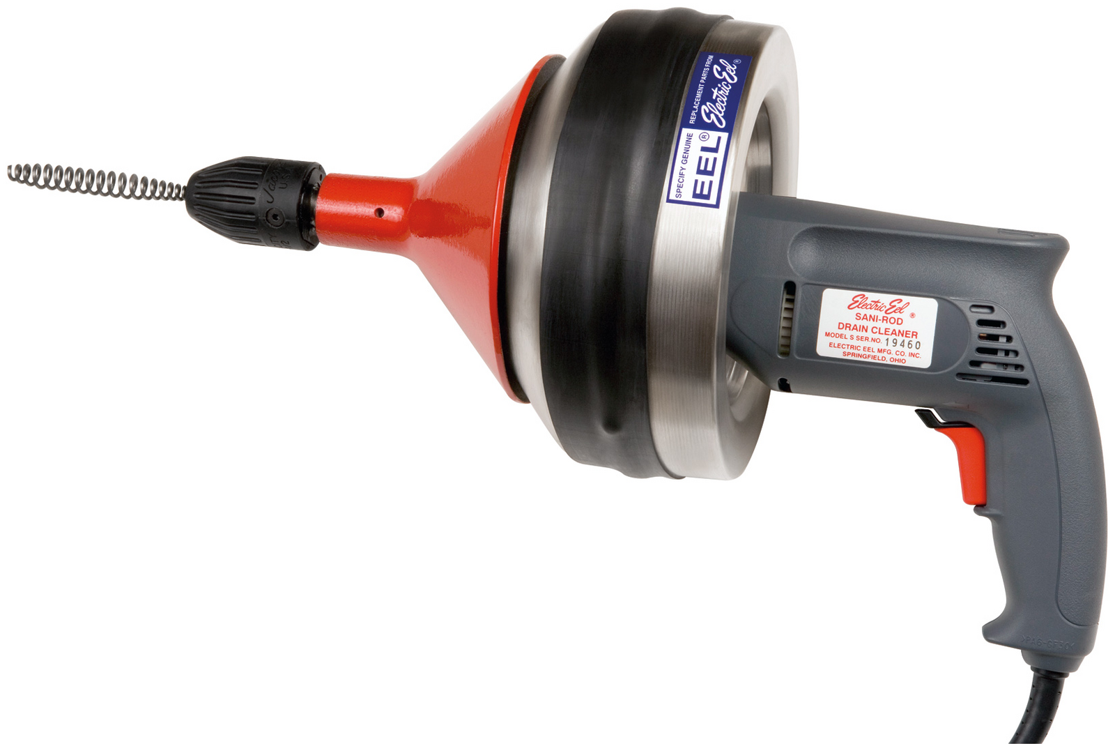

You need a plumber with an electri snake:

Well I have told you where the blockage is and what tool to clear it. Apart from coming round I can't do anymre. :ROFLMAO: :ROFLMAO:
