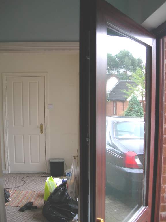

I moved into this house a month ago, and have had to do a lot of work. One of the first things I did was get complete new locking mechanisms etc fitted to the 3 external doors by a locksmith – the doors took a lot of jiggling and forcing to lock, then it took you half a day to get them unlocked again – and the handles were drooping down etc. 25 years old or so.

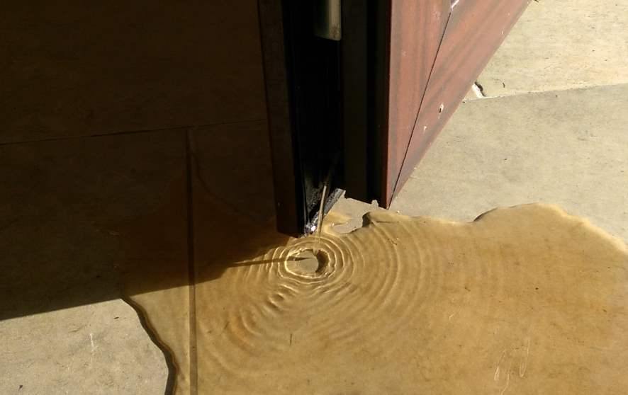

Anyway, all works fine now, except that water runs out the bottom of one of the doors when I swing it open, leaving a wet arc on the floor.
I expect (but don’t know for sure) it was like that before the locksmith came, and I just didn’t notice – or maybe it hadn’t rained in a while. I’ve examined it, and it seems somebody has drilled a little hole at the bottom to let water out, so I expect it’s been like that for years though.
Is this a common problem, and something easy to fix with a new seal or something? Please don’t include the words “new door” in your answers… this house is killing me :eek:

I opened a conservatory door, which swings out over a big step, and could see that there are slots cut in the bottom – presumably this one’s the same, and they’re full of dead woodlice or something, which is why somebody’s drilled a hole in the end of the door… so the door seems to have like an inch of water in it, and when you swing it open, the water sloshes to the end with the hole, and sprays out.
I’ll try a bit harder later, but I think I’m going to struggle to clear the damn thing out, which I suppose means taking the door off to do it. I’ve watched a YouTube video or two, and it looks like I’d mess up the adjustment if I unscrew the hinges…?

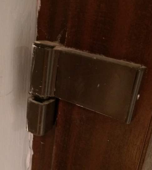

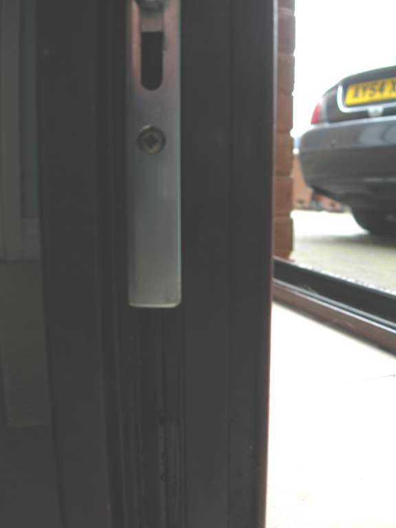

Going to need a pic of your hinges to help on that as there are dozens of different types.
Worst case scenario you could drill a couple of holes in the 2 ends of the door right at the bottom as it would do the same thing

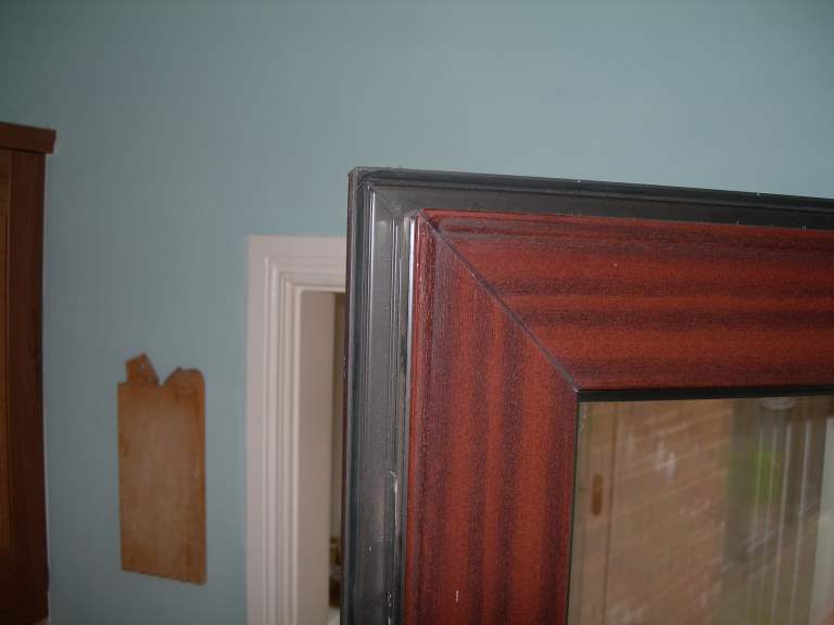

Yeah starting to think that. But actually, in common with everything else in this house, I think maybe some of the door/window seals are past their best... is it a DIY job to replace them, he asked hopefully...?
Yes seals on those should be easy. Find an end and pull it out a bit take a pic of the shape (cross section) and some measurements. Then go on ebay and search:
Bubble gaskets
Flipper gaskets
Which ever type you have you can buy a sample pack for 99p. Test the samples for the best fit and you will then know the code. You can just order it by the meter then.
As for you door that should just lift off (hopefully there is enough room at the top before it hits the plaster)

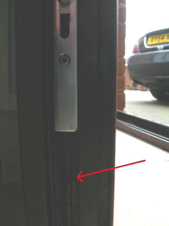

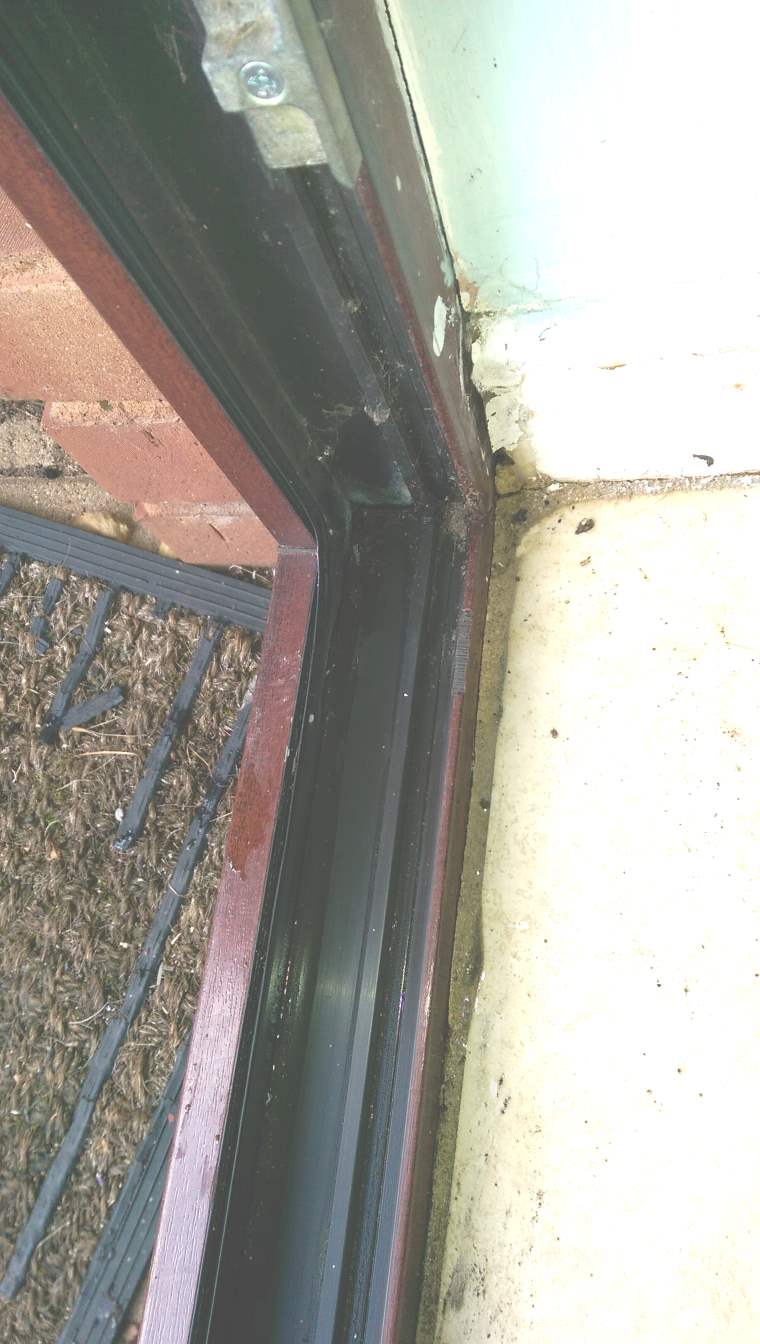

Still arctic here, so didn't want to chance it. I decided to drill a hole at the bottom as suggested:
Thing is though, there don't appear to be any drain holes in the bottom of the frame...
That was probably the problem then lol.
It can now drain into the threshold so should be problem sorted

Ummm... yeah... but if the "threshold" is the bit of the frame below the door (sorry I don't know the terminology), that's my point - there don't seem to be any holes for the water to escape from IT!
Thats a good quality door then (NOT!)

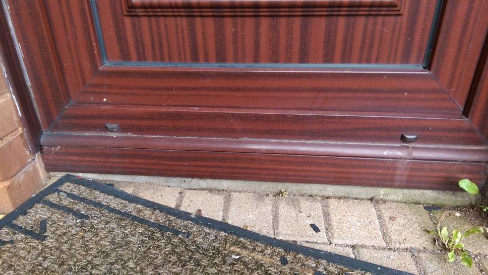

Can you post a pic of the outside bottom?
You may face to drill some holes down into the threshold (external edge) and then some in the front of the frame near the bottom which can be covered with drainage caps.
If you have a Google image search of "pvc window face drainage" there are some pics that will show you how it should be

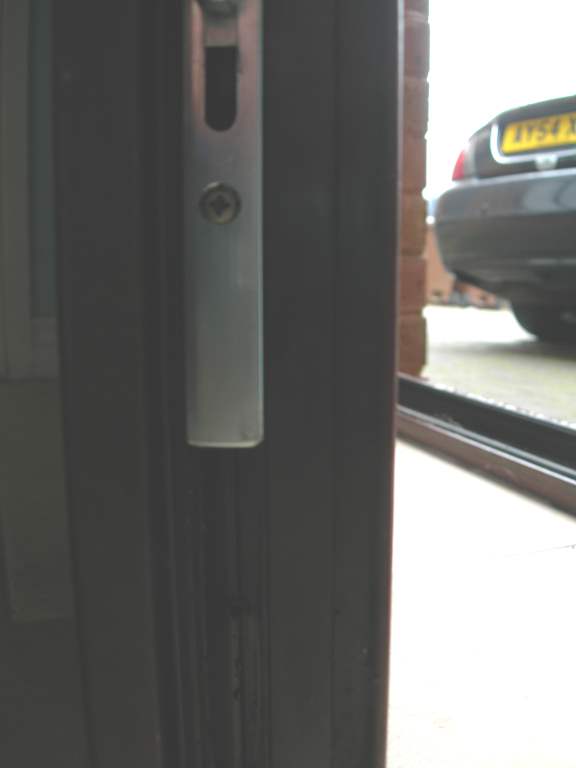

Well... looks like it has drains, but I guess they're not working...? Trouble is, I can't for the life of me figure out where they drain from on the inside. As I think I said, the door opens inwards, so I can't see underneath as it's too close to the floor - I can feel what appear to be a couple of little slots (maybe an inch long) on the bottom of the door, and have tried poking paperclips up through etc, but dry as a bone... but there appear to be no matching holes in the frame.
Yet, I assume there wouldn't be drains on the outside but not on the inside!
