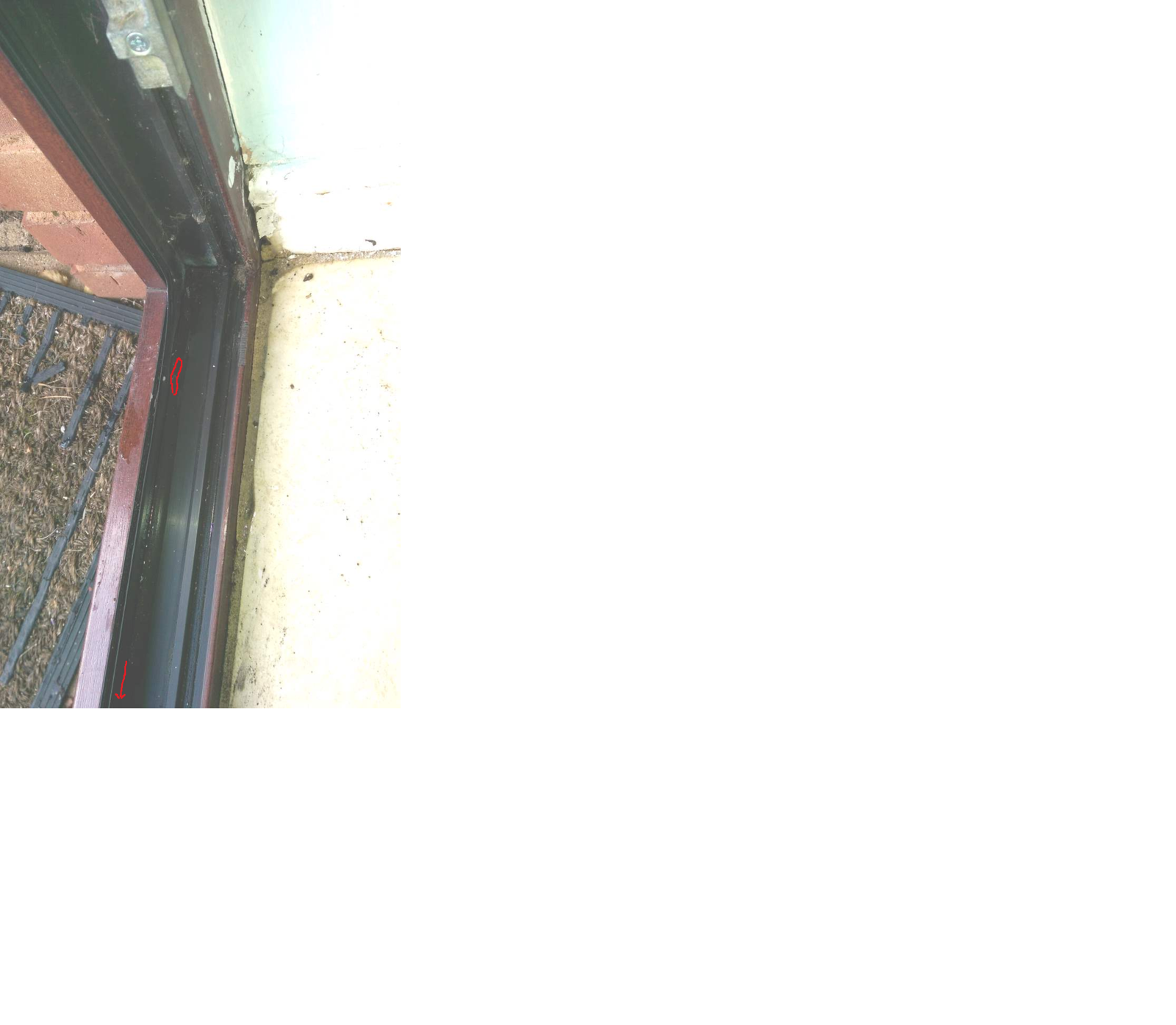

Water running out of uPVC door...
It possible that like the door sash the factory forgot to drill the drainage holes.
Pour a cup of water in the threshold to see if it drains out. If not you can drill some holes, 2 or 3 holes 3-4 inchs in from each side would be plenty
