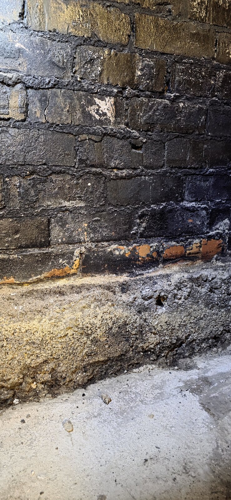

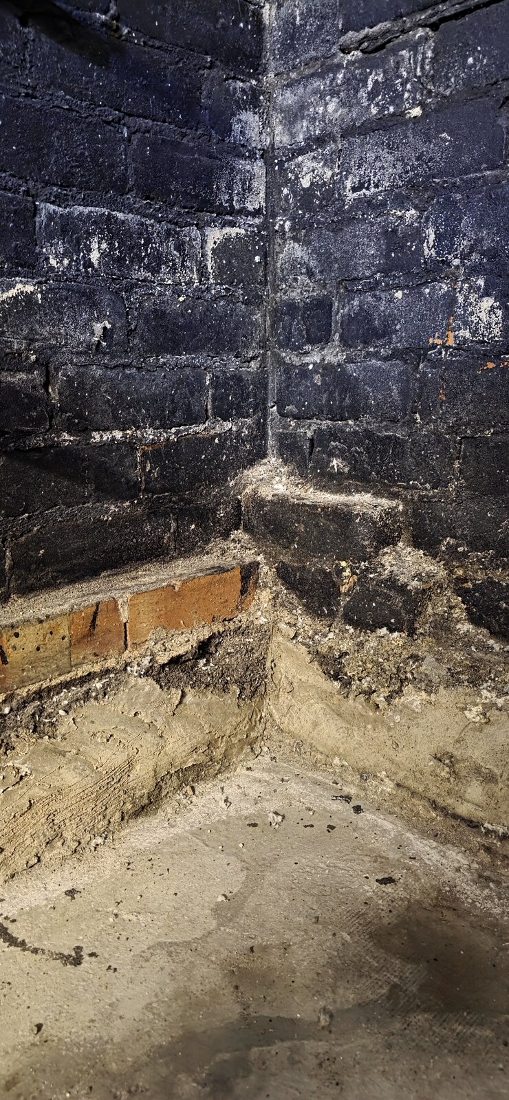

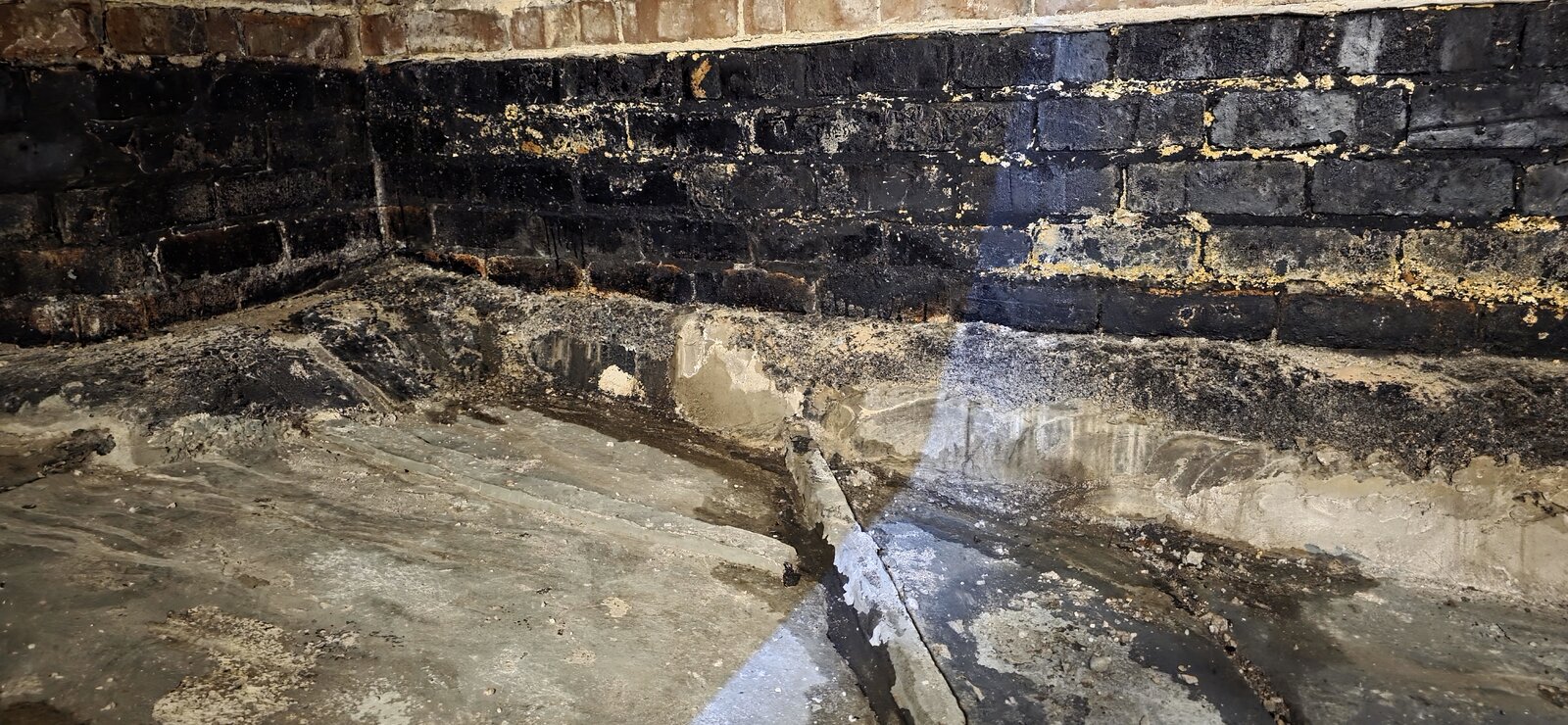

Good morning. I am not a builder and the photos are from an inherited property. This is the cellar that extends throughout the whole footprint of the 1934 built bungalow in Blackpool. Water runs through the cellar from front to back (the property is below street level and the cellar floor has a good fall from front to back). I am trying to understand the build method here as the bricks appear to sit on top of the material underneath which is falling away in little bits at various areas. I am also of course wishing to know if I should be doing something from a building perspective. Thank you

Is the material a cement render, are there bricks behind it? You could carefully dig some trial holes but if water is flowing freely it’s a bigger picture.
If the cellar is sloping, and water is running through it, it may be that you are on a hill and groundwater from a stream or other source is running in the ground. It would reduce in times of drought. It is possible to intercept such water and lead it past the side of the building.
However, if the source is a broken drain or a leaking pipe, it would be possible to repair it. Pipes and drains 90 years old commonly leak.
Do neighbours with similar homes have the same problem?
Dig some holes uphill of your house and see if they have water in them.
Does the water get worse after rain? Or after a bath?
Is the water worse close to to pipes, sewers, manholes?
Are you in an area of hard water, leading to lime scale in kettles? This leads to white deposits on bricks. Leaking sewers contain traces of soap, and organic matter.
Lime mortar is softened and washed away by long term water, but cement mortar and concrete are undamaged, and actually gain strength. You will be able to tell by scratching it with a fingernail. A house of your age could contain either or both.
Are the black bricks painted? It might be bituminous paint in an attempt to hold back damp.

Thanks for your response. I do not know what the material is but i would say it was concrete. There are areas around the walls where it is breaking down and coming away in bits. It is also soft and compressable in places. I dug a hole from the inner towards the out leaf and all i found was soil so the bricks above are unsupported. I am really worried about this and considering a structural survey now. A building survey made no mention not gave any concerns about the foundation, only mentioning that water passes through the concrete / screed cellar floor following mortar 'paths' that the previous owner had ade to direct it out into the back garden.

Thank you John. I am in the UK btw, so we get little in the way of drought.
The cellar slopes front to back. A buidling survey recommended an ACO drain at the front to reduce water run off to the outside wall. That has yet to be installed. The water comes in at the front about 4 feet below the ground level. It just comes / soaks through the ?concrete foundation in the photos / the bricks.
Post building survey I had 2 CCTV drain inspections and although there are joint issues, the drains are serviceable and do not leak in such a way that this could be the cause so I am content I only see the water during times of rain.
I assume your mention of lime mortar is that used to build the walls. I am unsure what it is but it seems in sound enough condition.
I think the black paint is regular brick paint as there has been some useage on the outside.

The water is not massive amounts but it just caused me concern as to its effect on the building materials. The channels work well so water is not sat in the cellar. There were some minor internal cracks in plaster but think this is old and / or due to temperature. There are no bulges in walls or zig zag cracking and everything to date points to the property being structurally sound. I think because I am an engineer I look deep into stuff, perhaps too much. I just want to assure myself hence my thought about a structural survey, but I have already shelled out over £1500 on building and damp surveys. I appreciate your comments that put my mind a little at ease. I guess also its about how I would stand with buidlings insurance in the event of something 'big' happenning.
