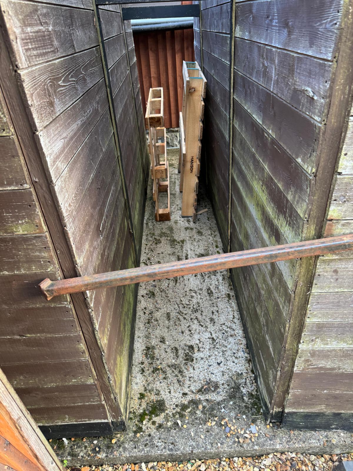

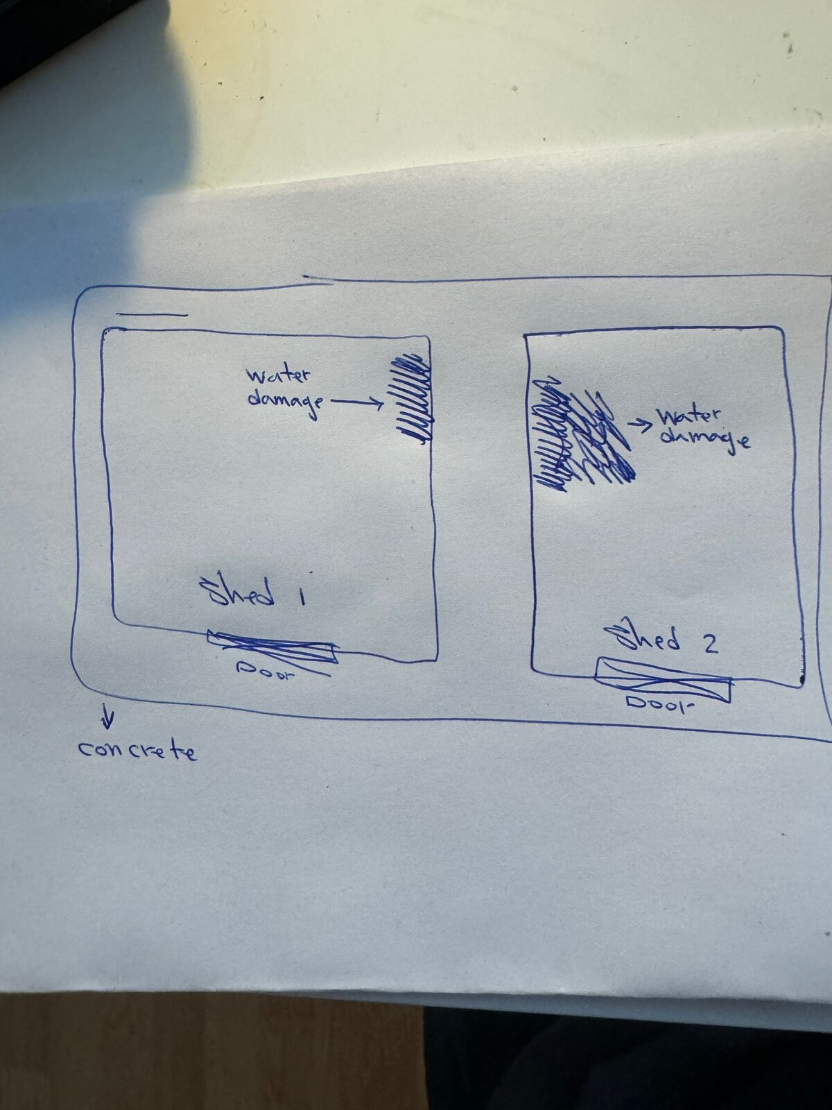

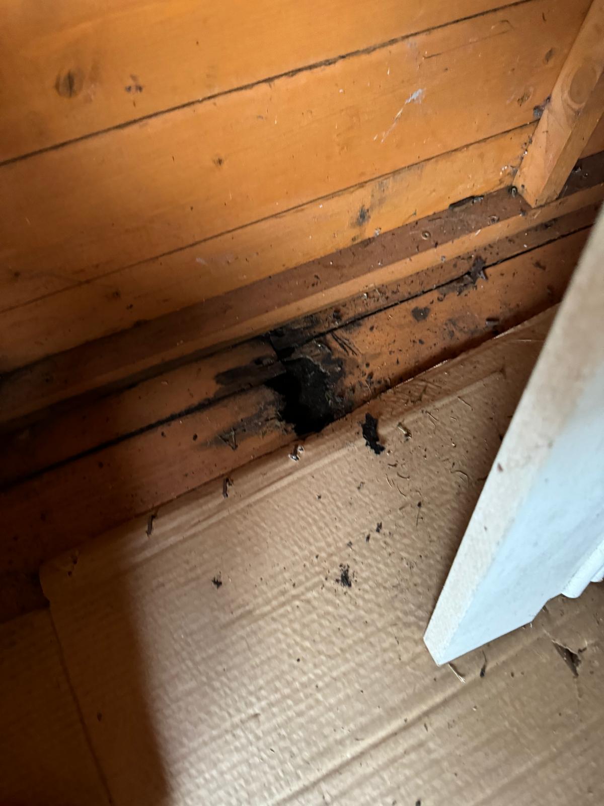

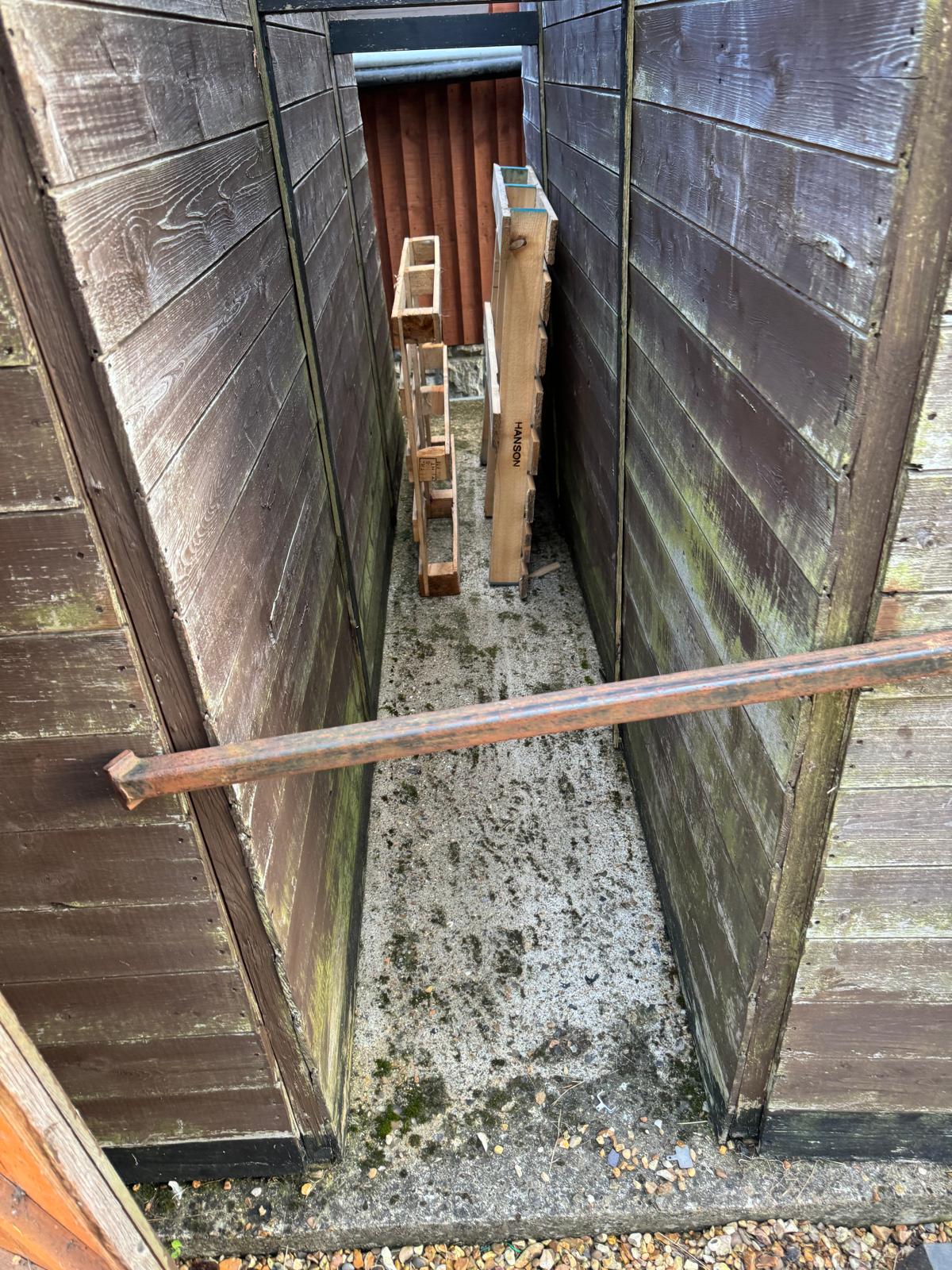

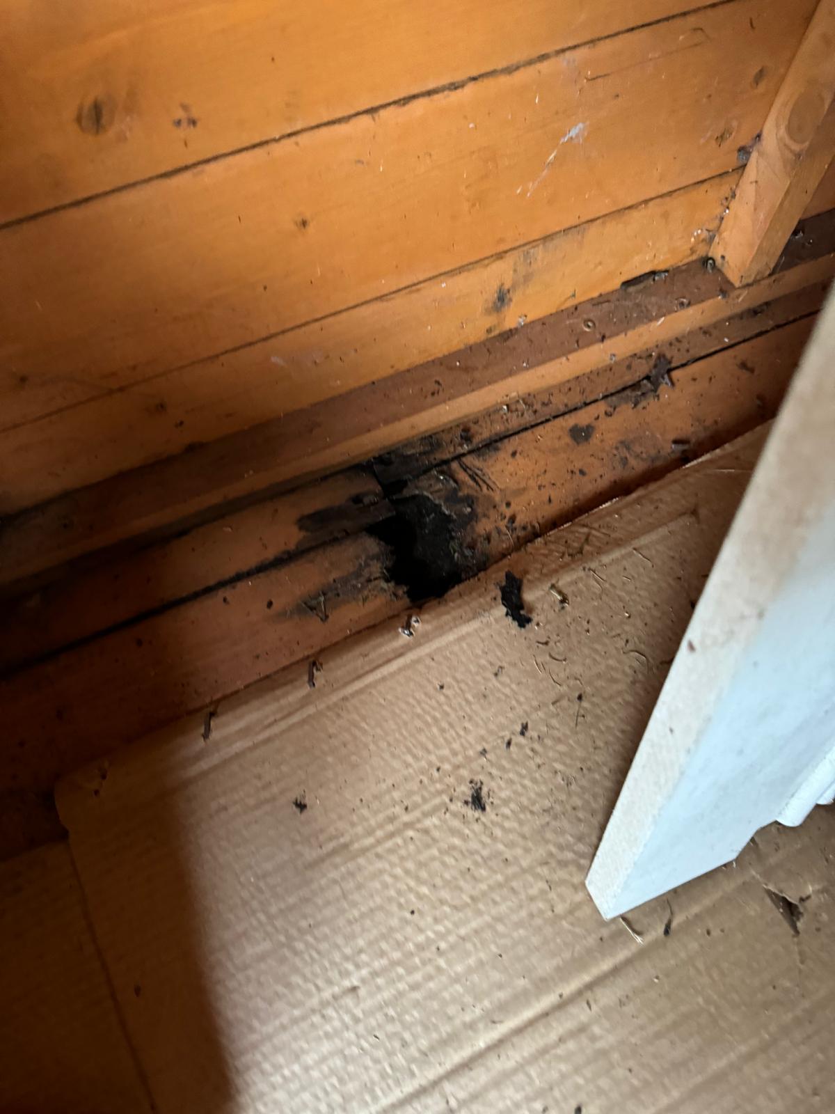

I have a problem with the drainage on my concrete base. It wasn't built with correct drainage slope. The damage inside is getting worse. I need to stop the water soon.
With a quick look online, I've found few solutions but not sure what would be the best considering the surface material and size and the total cost perhaps.
1) Garage Door Water barrier seal Kit. Piece of curved heavy duty plastic, guess to be screwed glued and sealed around the shed?
2) Flood barriers. They absorb water and creates a barrier. (like sandbags but with water instead of sand)
3) Creating a channel by using a dimond cutter across the shed? This is the option I want to avoid. It's going to be a lot of work , dust and I'm sure there are steel frameworks inside the concrete.

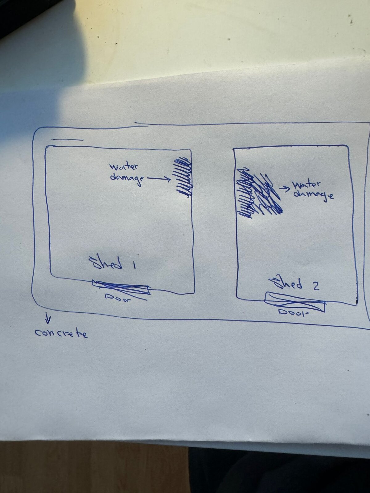

1)It'd be great to hear your opinion. What would be the best solution?
2) where exactly I need to put the barriers based on damaged area?

Lift each shed onto some paving slabs. The problem is the shed base is in contact with the concrete, it should be on something to raise it up, with a bit of dpm or similar in between.

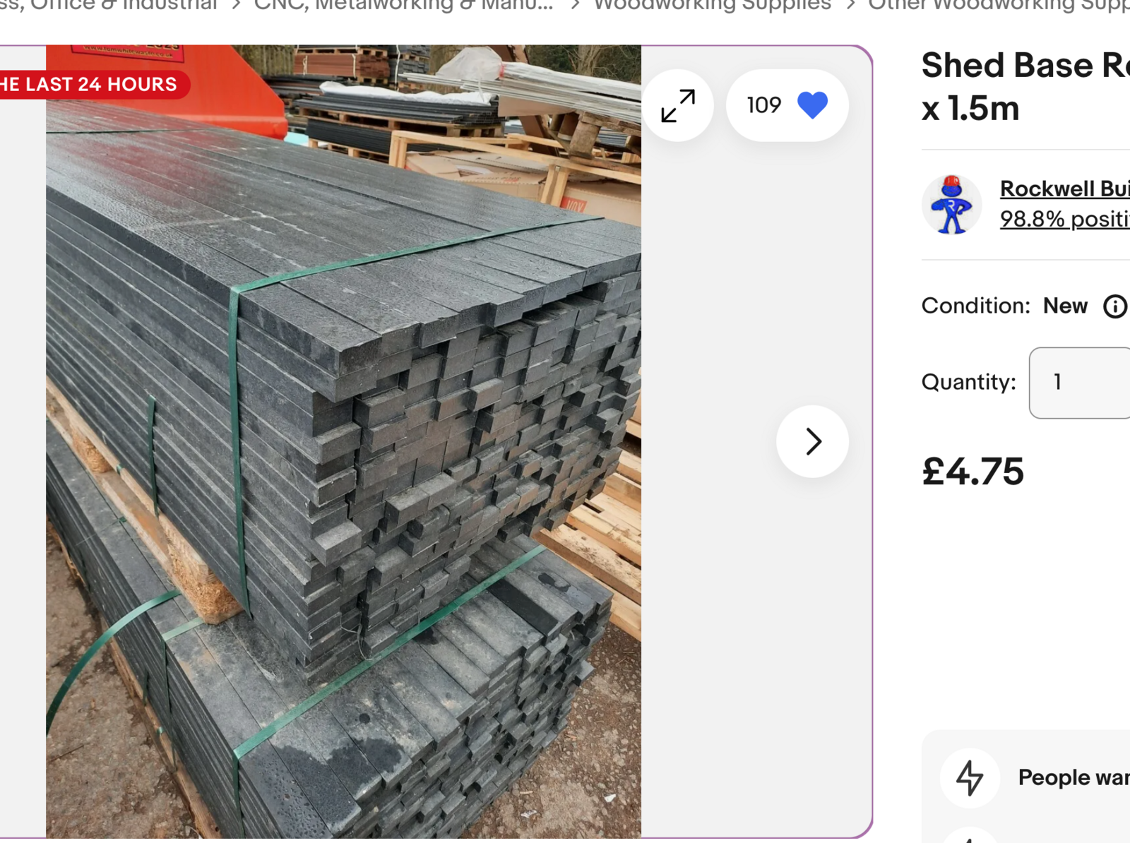

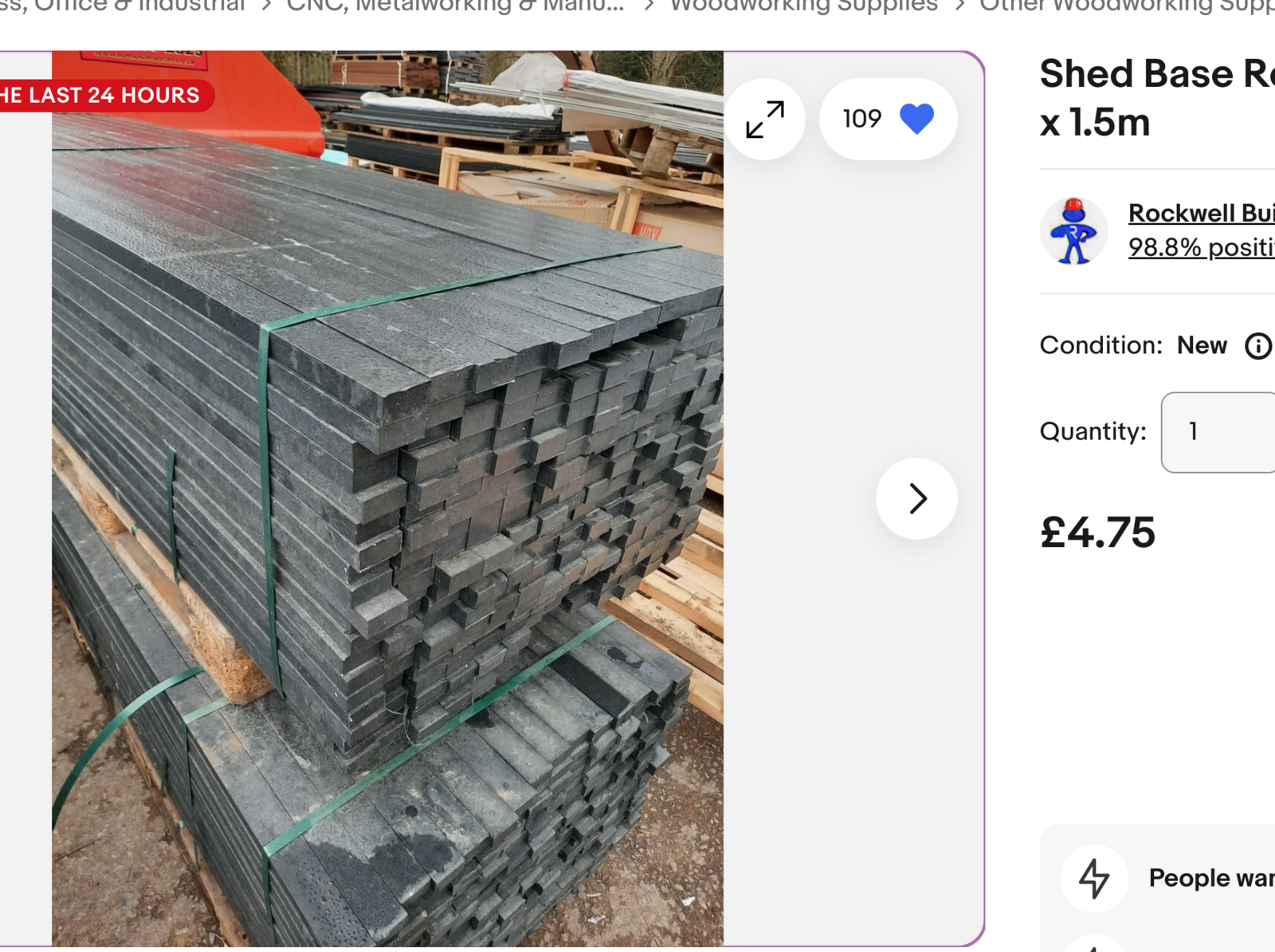

I found some recycled waterproof plastic slats that I cal lay under the shed or I can use treated timbers
Would something like this work?
Should I put the DPM under the slats on concrete or over the slats?
Thank you

With bearers lifting the shed up it doesn't matter if water sits on the concrete base that's the whole reason for raising the shed.

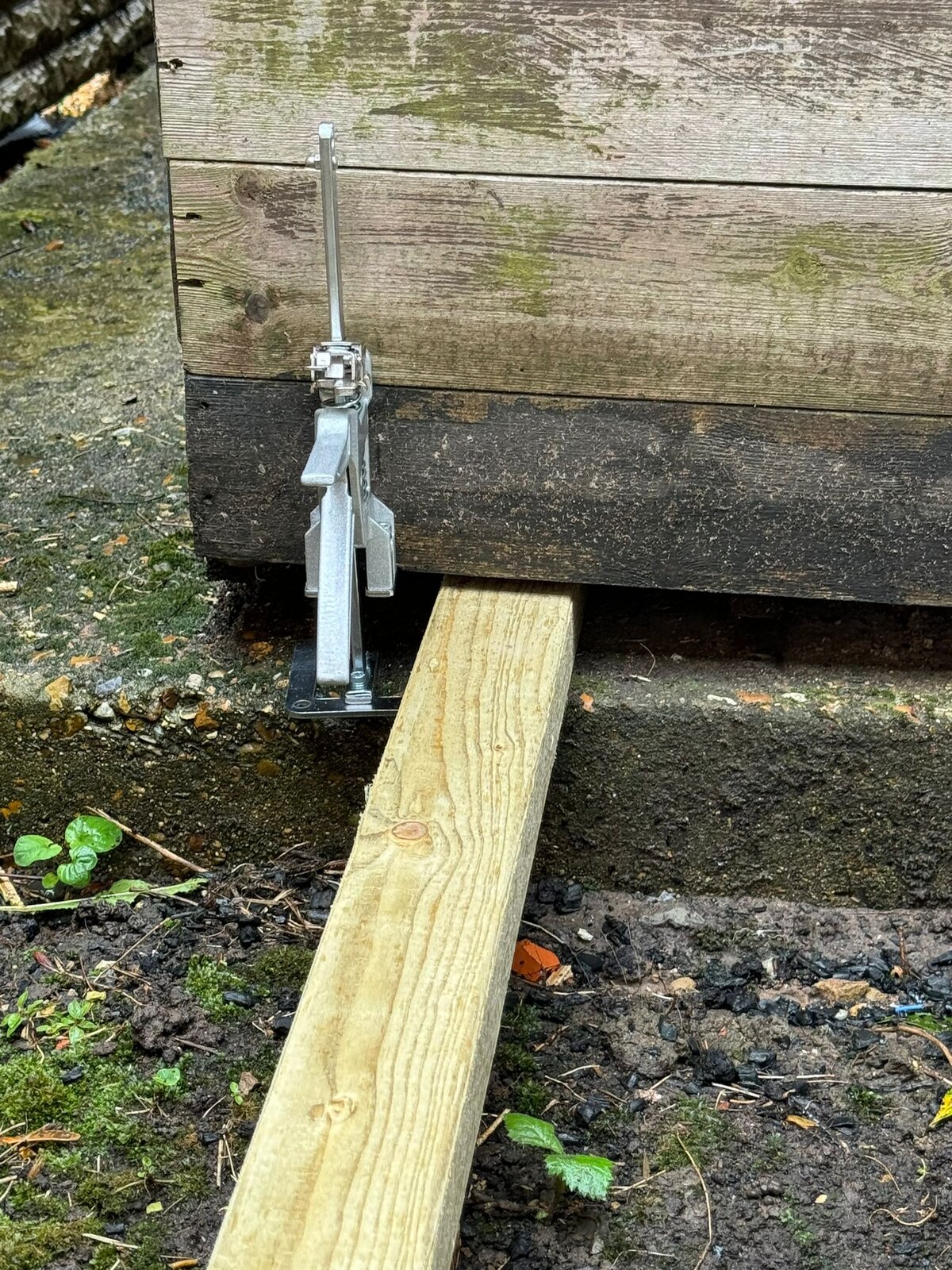

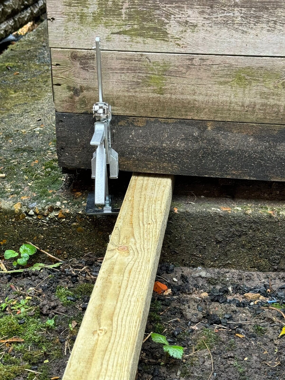

FIXED!
Thank you all for your help. Bought x2 jacks from Ebay for £30. There was no need to pay over £100 for Stanley.
Very easy to use. I didn't empty th entire shed only took heavy items out. Bought treated wood from Wickes, pressure washed the base and slided the beams across. Saved my shed
Thank you all again
