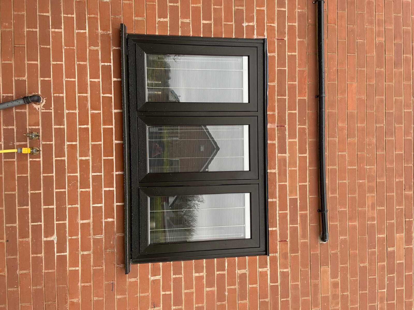

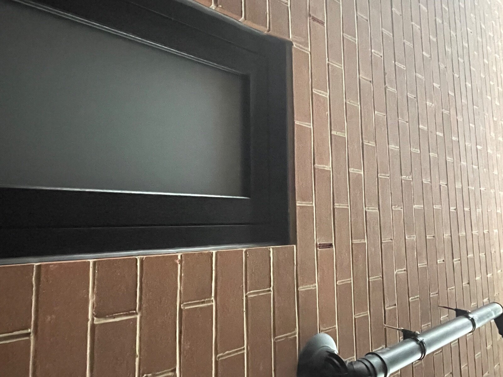

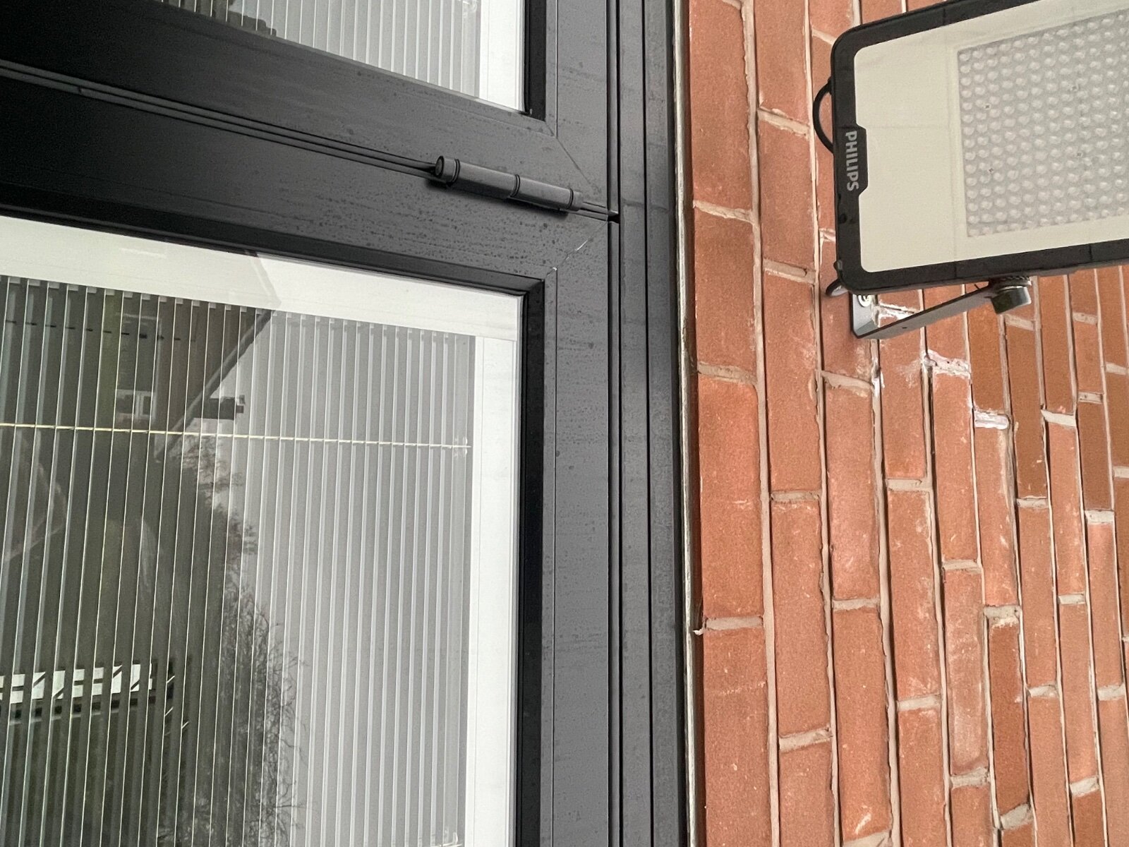

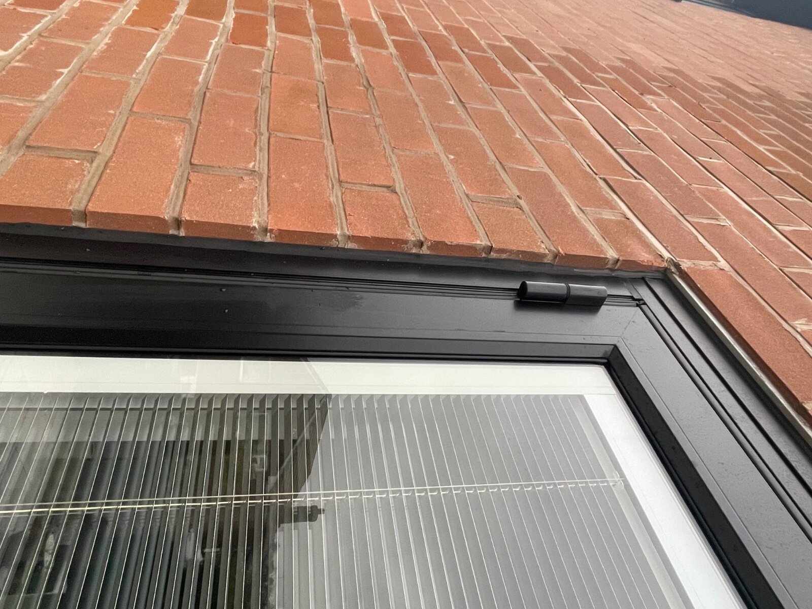

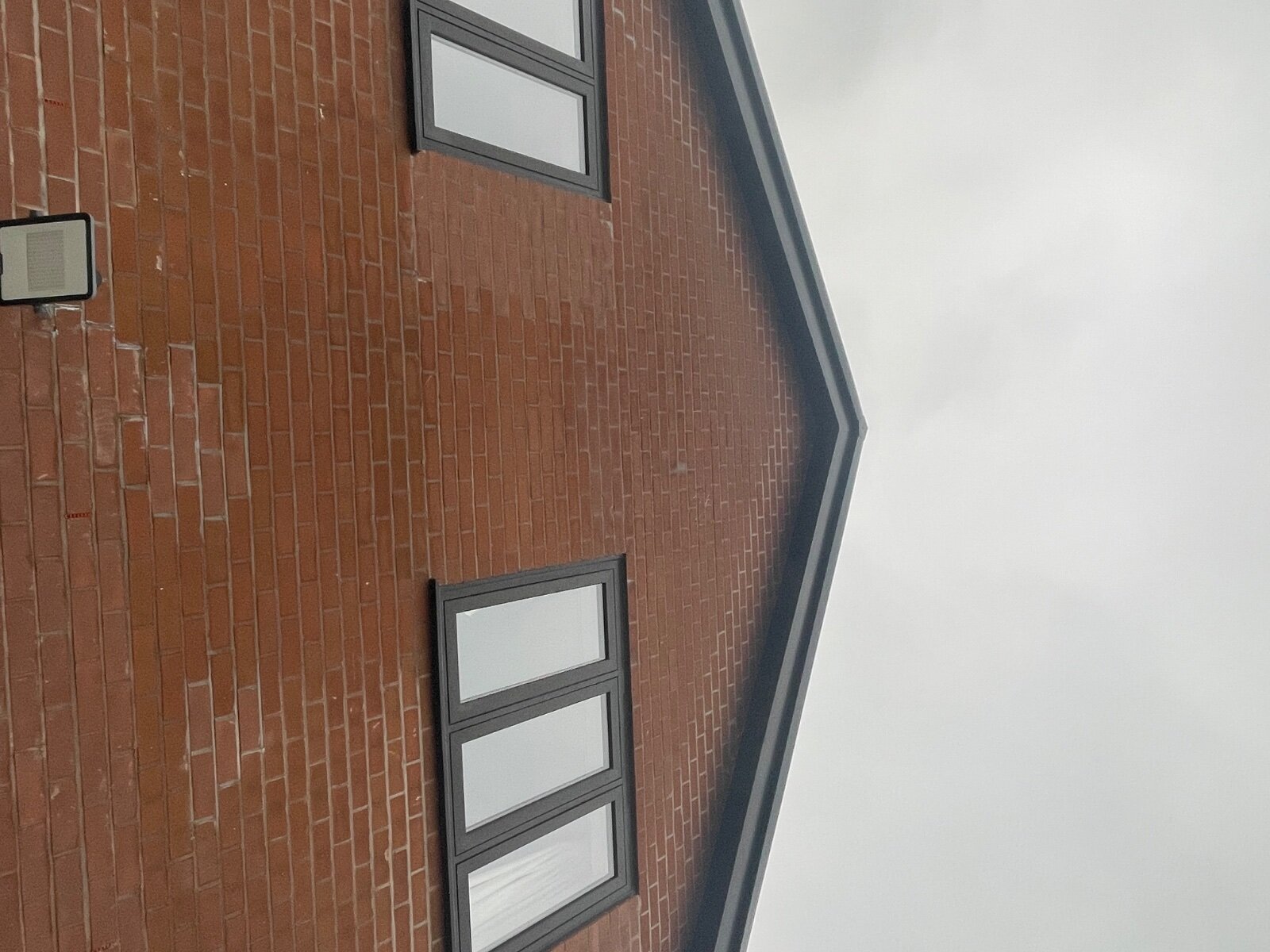

I'm still not convinced its a brickwork issue. Are the frame headers adequately sealed?
I will try getting a couple of photos tonight certainly ground level and my sons room is also affected too (all south facing)
I do agree at the front my windows are fitted in deeper if that makes sense and at the back they’re not I’m unsure why.
Images at the back of the house,
Bifold door kitchen window and utility on sise
Of house. Weep vents are present at ground level. Just no idea. Appear to be decently sealed

As has been mentioned, something's off, they're too far out as has already been mentioned and the weepholes where fitted (have you actually tried pulling one out to check its not a fake?) are too high for some reason. Whoever has built this has not grasped any good practices. The fact that you have three door/window heads showing up signs of leaking probably means.
Try some sealant around the frame if you want.
Then if that doesnt work try some brickwork water sealant.
If they don't work the problem looks like some kind of cavity tray issue. Even if rainwater was getting in at the roof a CT should prevent issues such as these.
We have tried sealing late last year in few places with ct1 but like you say I don’t think the installation is correct if any
Il wait for the bricklayer to come next month or so and take it from there
