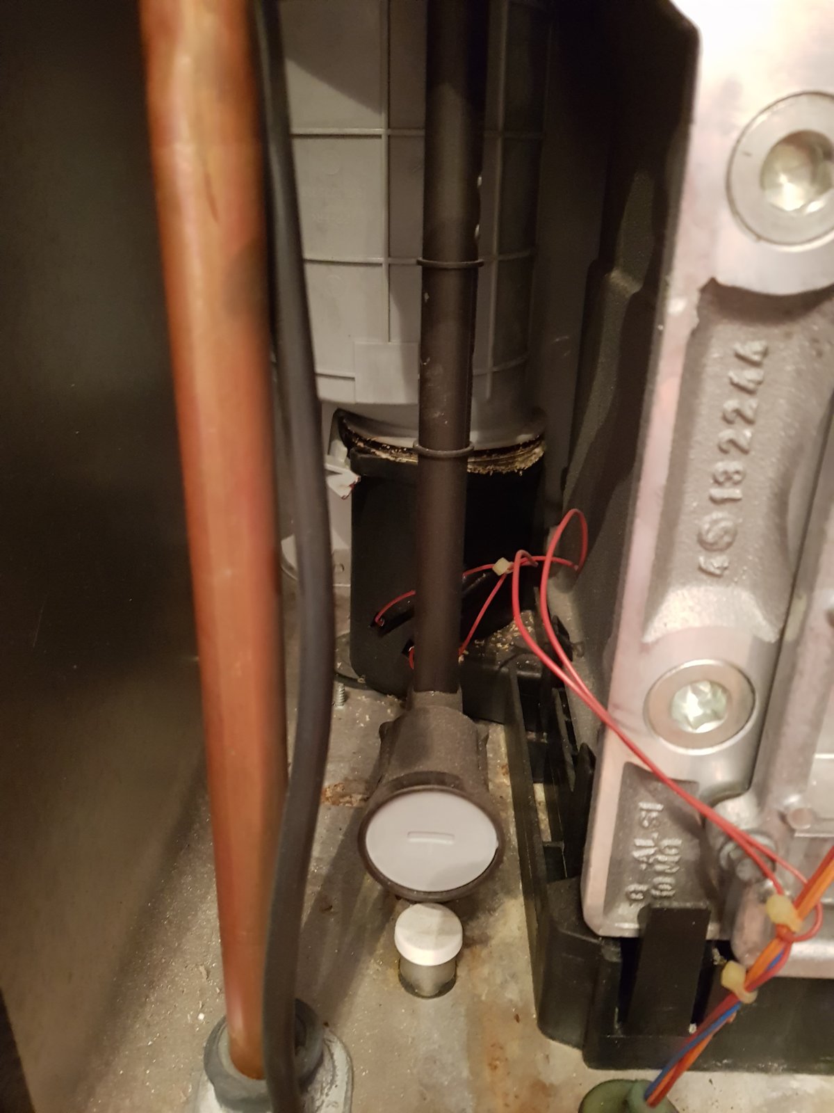

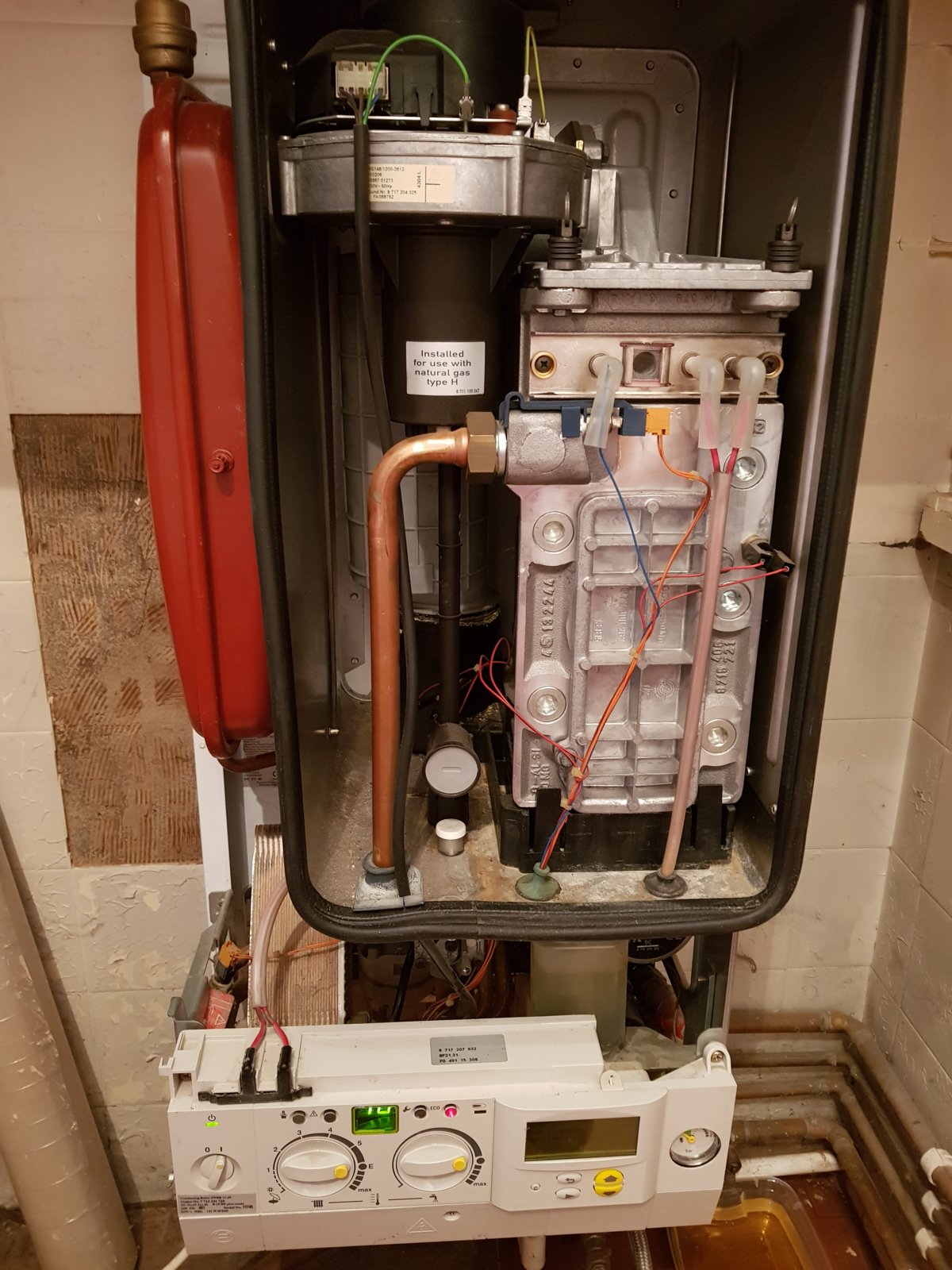

Couple of pics of boiler, some crud around flue join where black bit meets the grey plastic, not sure where that's come from.
