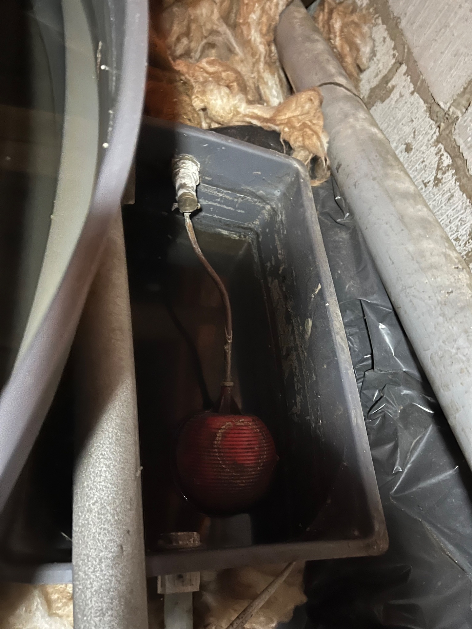

That might, or might not indicate a leakage from the hot water somewhere. If you look in the loft, and see if there is a constant flow of water going into the large loft tank, it suggests you are leaking hot water somewhere.

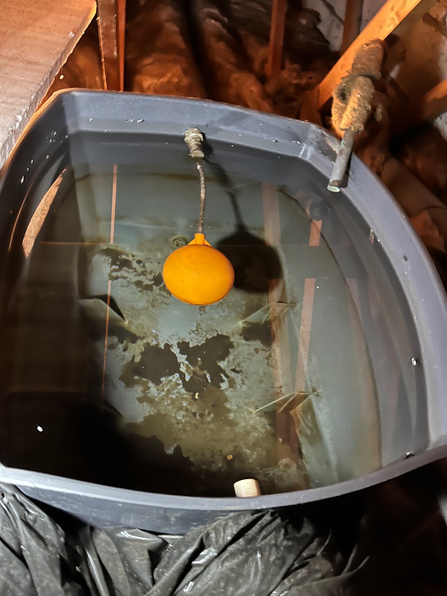

Tie up the float valve in the feed and expansion tank and the cold water cistern. You may find the water level in one or both of them drops even when you are not conscious of using water.

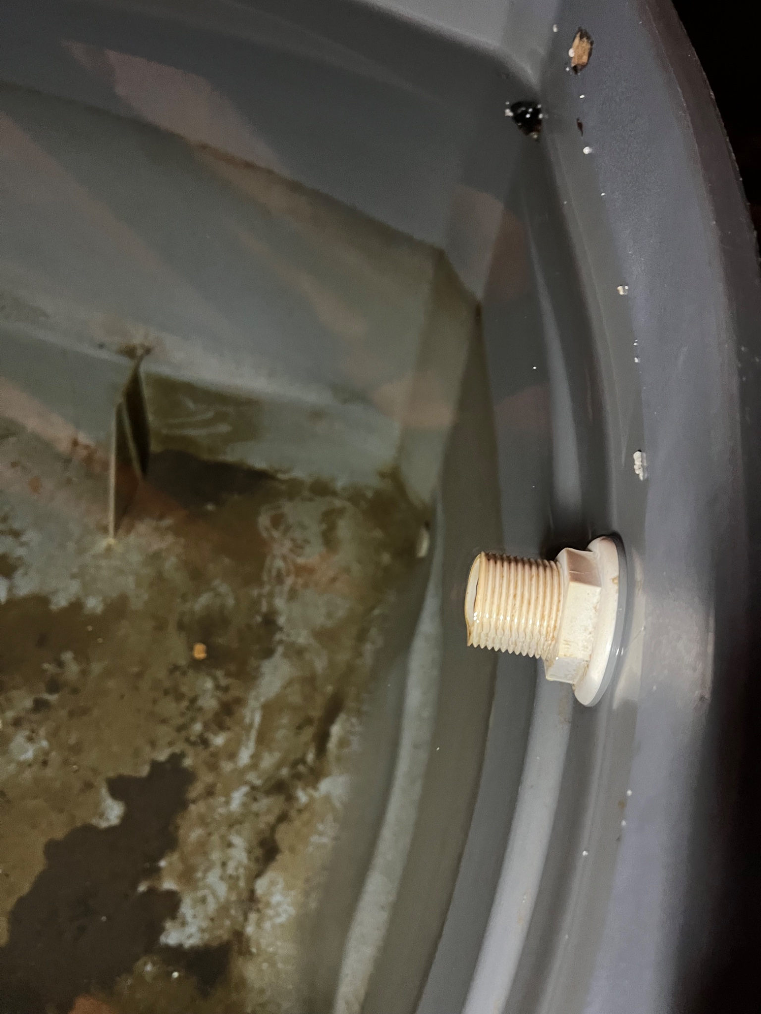

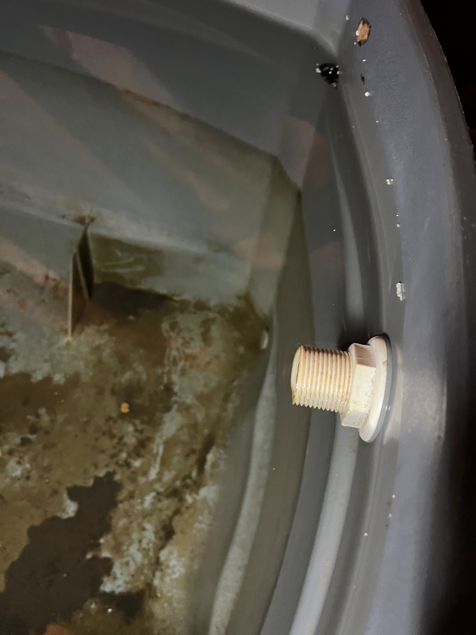

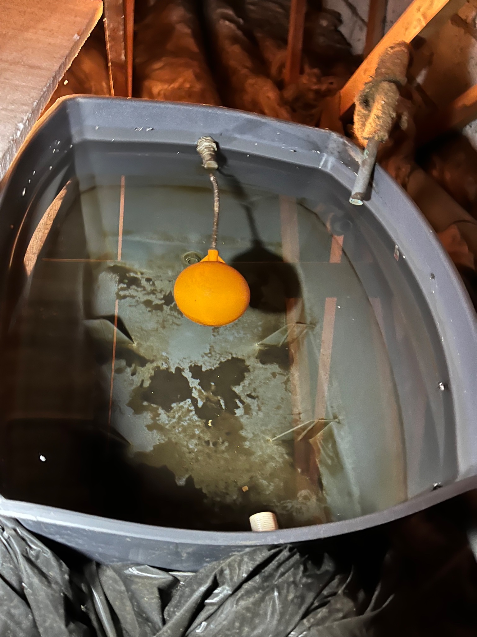

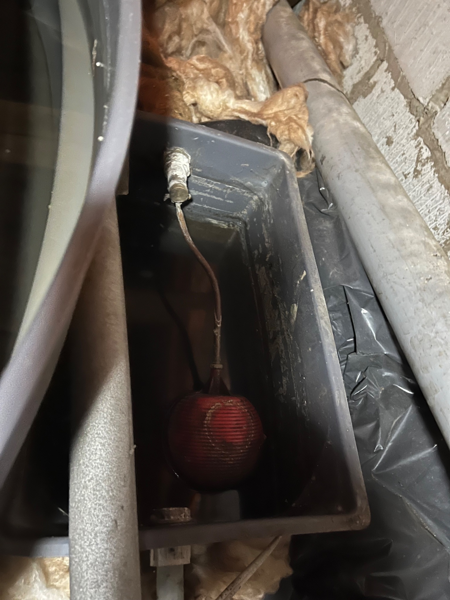

Hi, thanks for all your advice, I turned the water off last night and went into the loft.
One of the overflows on the tanks was under water so I guess I need to try to unblock it.
The only one that looked anything but full was the small one at the end, I’m not sure of the purpose of that.
I’m going to go back in a couple of hours and check the level again.
