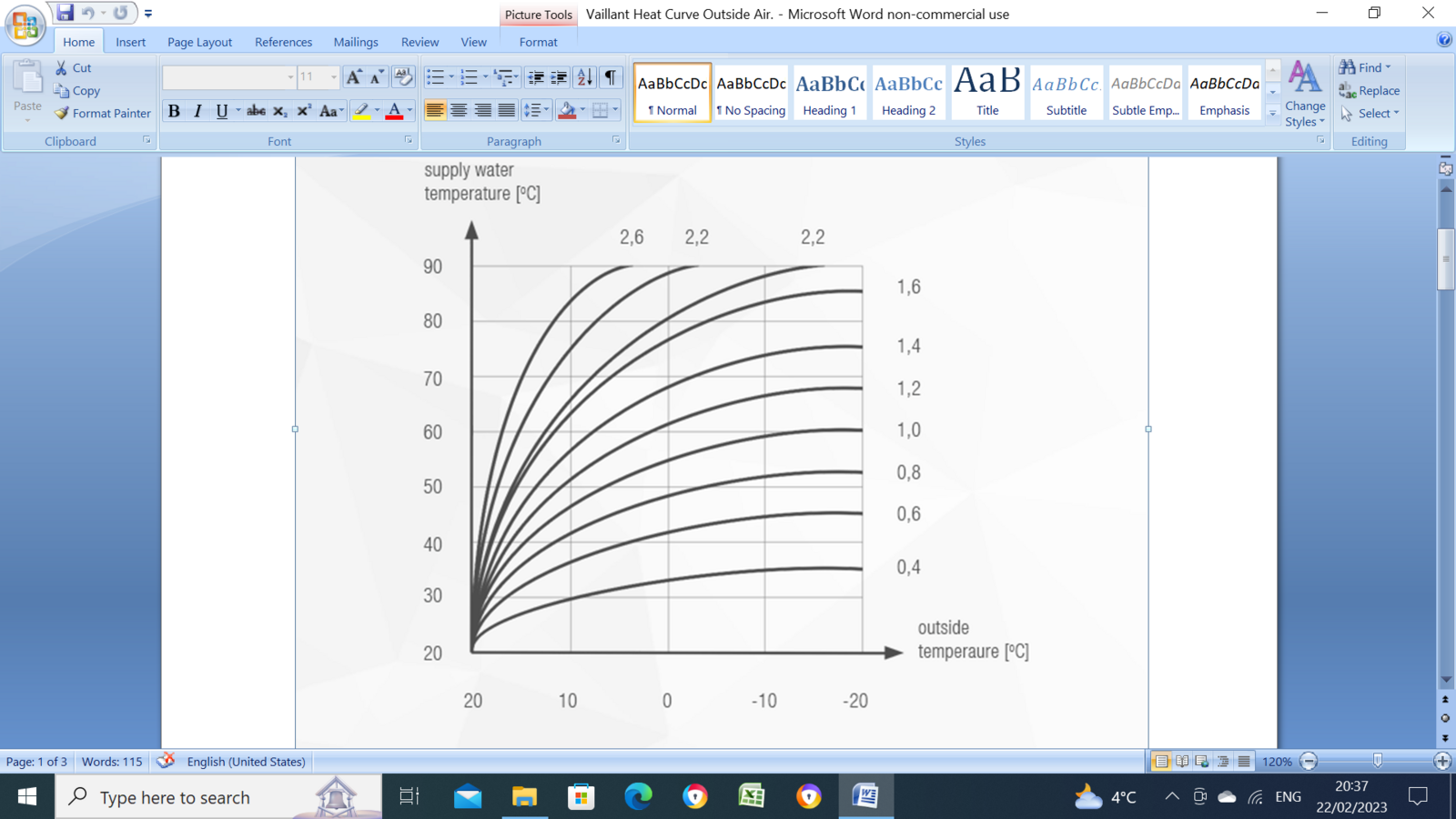

Don't know what particular set of curves its working off but taking the one below as a example then curve 0.8 asks for a flowtemp of 42C at 0C and 38C at 5C, assuming the boiler fires at 60% output or 18kw and assuming a system temp of 28C after anticycle then a flowrate of 1.11m3/hr is required to prevent the flowtemp exceeding 42C and 1.55m3/hr to prevent it exceeding 38C, if the burner is staying on for > say 2 minutes then I would think that the boiler is getting away OK and it will then keep firing until the flowtemp reaches 47C at 0C and 43C at 5C.

This is the heat curve it is working off set on the controller, can set two differet curves on my setup

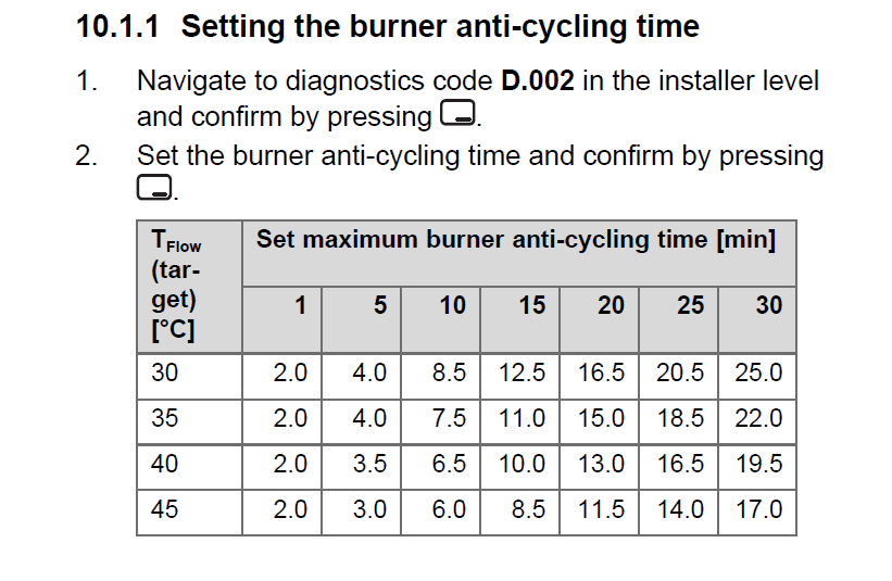

Thanks for the info, so hopefully the anticycling isn't too abnormal. The anticycle time on the boiler has been set to 11 minutes do you think this ideal or should I change it?
I don't think that 11 minutes anticycle time is allways set in stone, a lot of the vaillants use a lookup table where the actual anticycle time depends on the set anticycle time and the flowtemp, the lower the flowtemp the longer the anticycle time, you may find one for your boiler in the manual but if the boiler is performing OK then maybe leave well enough alone.
Yes you are right about that, I only was able to see it was 11 minutes because I went into the D settings while it was in anticycle mode but when in normal heating mode you are unable to change the settings. Thanks for the replies, I will leave it alone probably best not to fiddle too much
Was 11 minutes the remaining anti cycle time in the menu or was that the setting for the maximum anticycle "D.2"?
Essentially as has been said, the actual time spent in anti cycle is dependant on the flow temperature, lower flow temp = longer it can stay off for. Since your using weather compensation with reasonably low curves then the flow temperature will be fairly low thus the anticycling time will activate for longer.
Not necessarily an issue, its meant to do that, so long as the house is getting warm and its not cycling off so much that you struggle to maintain the correct temperature in the house.

11mins was the remaining anticycling time, I've been monitoring what the boiler does and as you say the anticycle varies. The last one I saw was 14mins from the beginning of the cycle
I've been unable to find the D.2 setting you mention on the boiler installer settings but I probably won't fiddle with it anyway
Good to know it's not abnormal. The boiler is functioning fine I just wasn't sure if it should anticycle so much

Here's a example of a Ecofit Pure 830 anticycle times.
On this model a target temp of 35C + 11min set anticycle time = actual anticycle time of 8.2 mins
and 45C + 11min = actual anticycle time of 6.5mins
