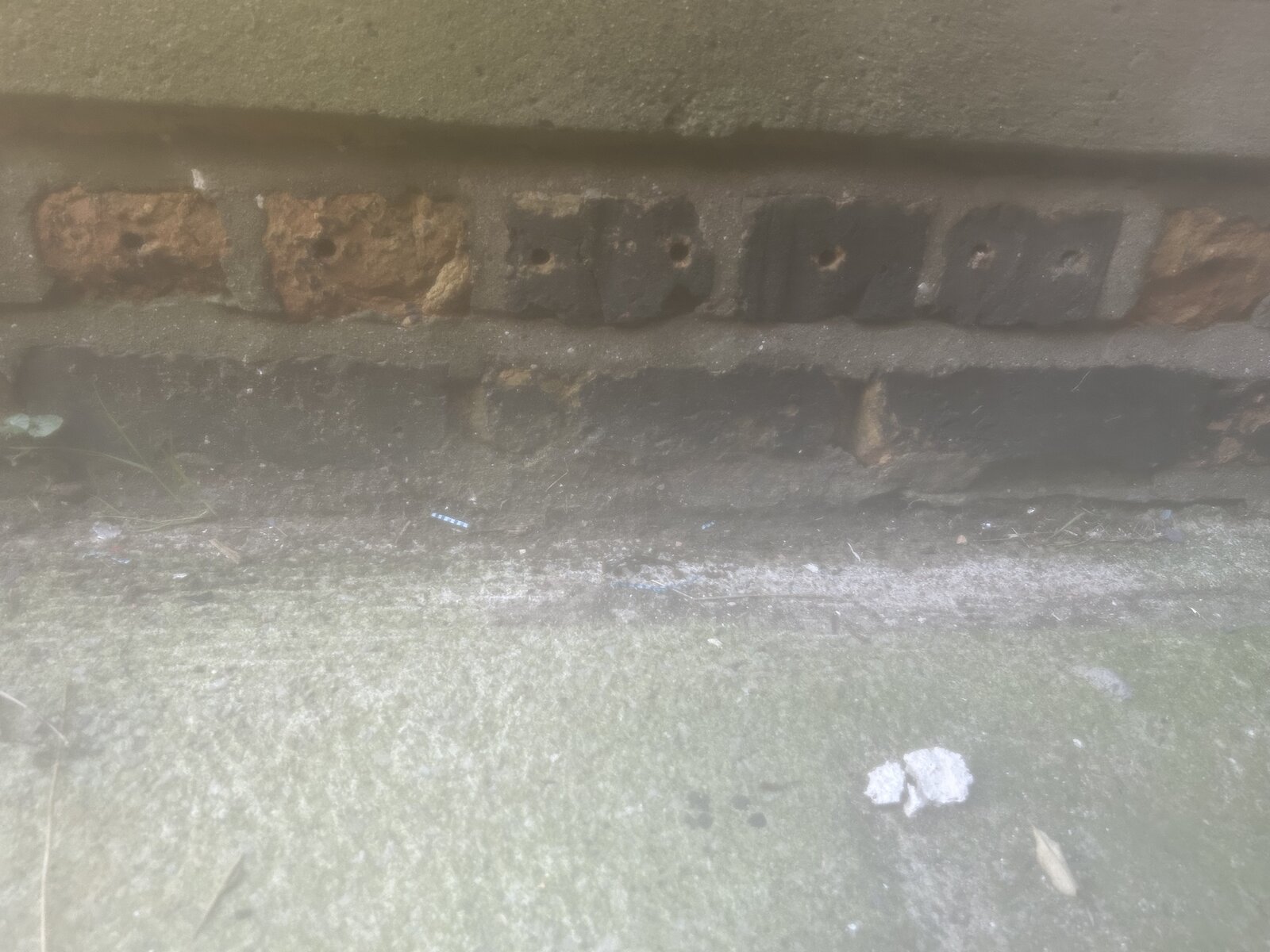

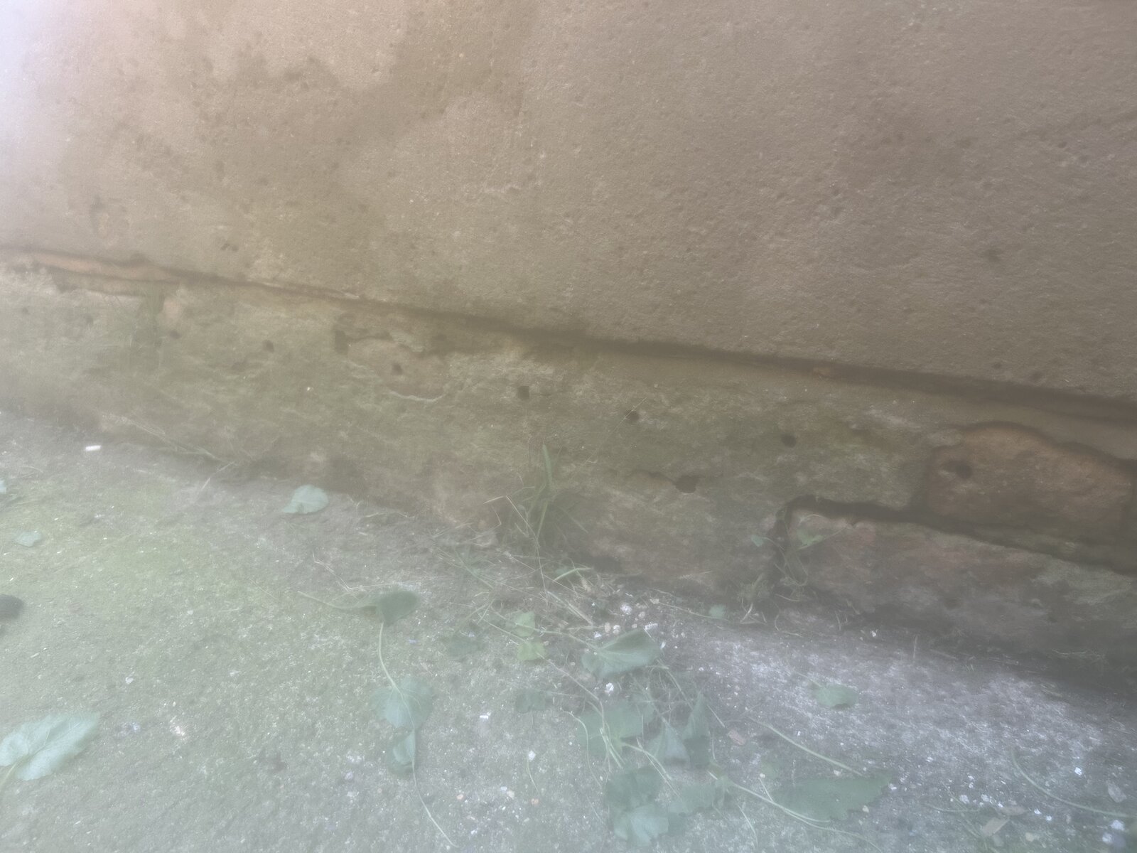

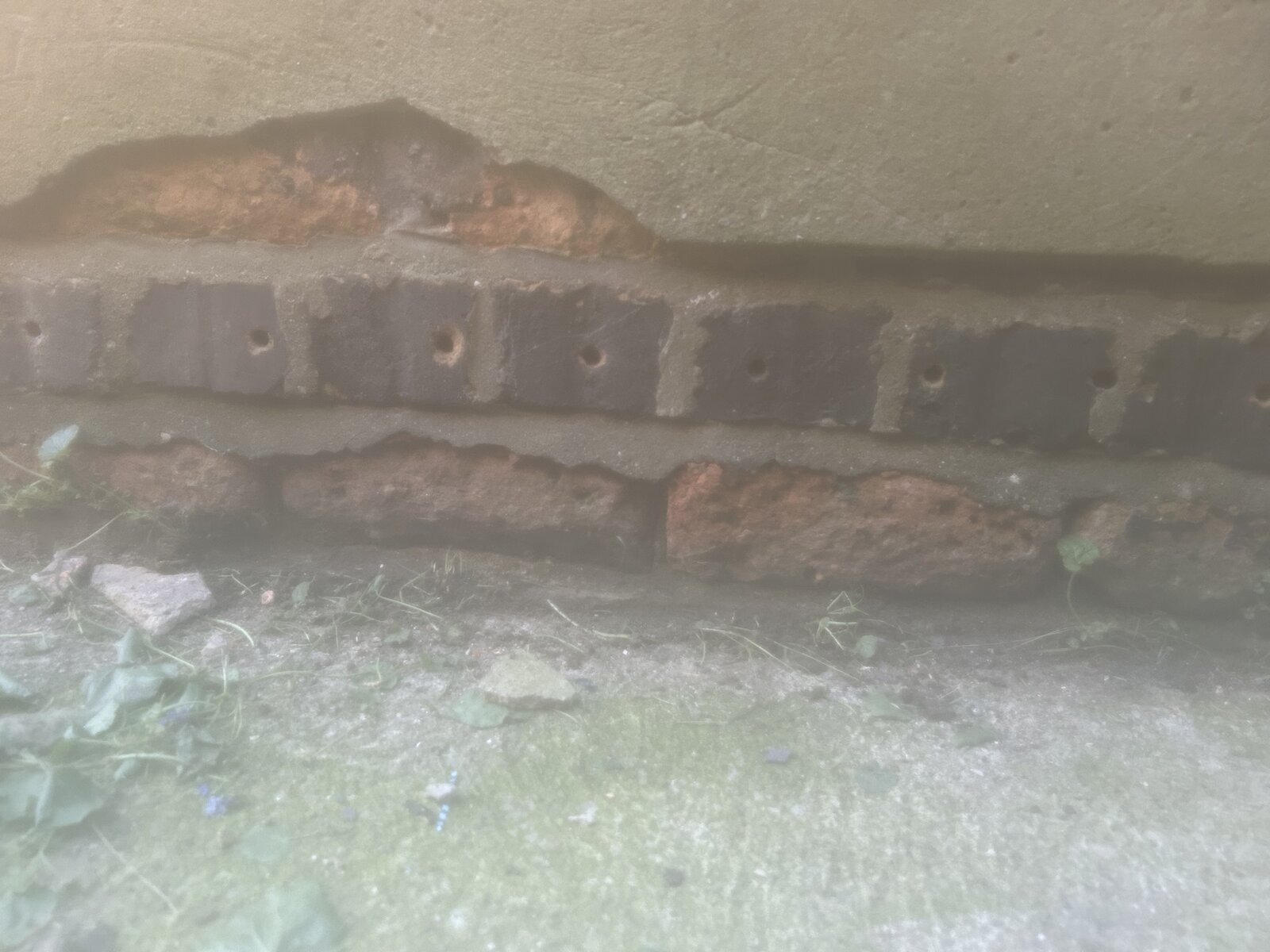

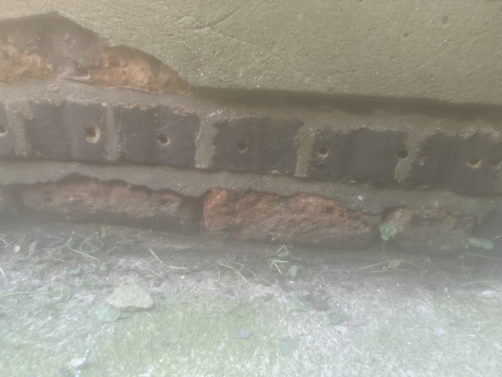

So I live in a house buuikt in 1890. It’s an end terraced house down the side of the house the bottom course of bricks is very weathered and the mortar is in a bad way. The side of the house is rendered above the DPC.
There was a an injection damp proof course done before we moved in and all the holes are left open.
We have noticed damp in both the back room and front room on the between the chimney breasts. The damp is rising from the floor up.
Could the weathered bricks be causing the water to soak in? And also do I need to cover the holes.
I have put some photos on apologies for the bad quality my camera is damaged.
Also we have a leak from around our chimney in the top rooms which are in the roof. I believe the soakers have failed I need to get up to make sure though. But could these be linked?

OP,
Using a proper camera:
1. A pic of the side elevation would help - from ground level to chimney stacks.
2. So would pics showing the damp signs inside the house.
3. Carefully examine the lower walls at the front and rear elevations.
4. The possible damp penetration of the chimney stack flashing will have nothing to do with your ground floor damp. Please post pics of the stacks & their flashings when you are ready.
5. Pics of the damp signs in the FF upper rooms will also help. Going into the loft might show you damp staining on the loft c/breast?
6. Are any of your fireplaces blocked off? When were your flues swept?
7. You have a 9" solid gable wall - the drilled injection holes are in the brickwork, that method has not been used for many years. Maybe the bricks were drilled and DriRods were inserted - but the holes are typically plugged after drilling. Measure the depth of the holes?
Sorry, can’t get better pics at moment, but think I have found the cause of the damp downstairs.
the path next to the gable wall is sloped from the middle of the house to prevent water pooling. But whoever put the path in built it up to level and slightly over the original slate DPC. I know this as I removed 2 bricks from the bottom course in the middle, they were bedded onto slate. From further inspection the share goes along that whole course.
I intend on digging a channel in the path about 6 inches wide and 150mm under the dpc. What I am u sure if is how to stop water pooling in the channel.
