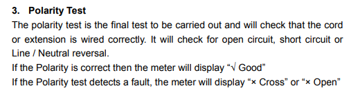

Page 16. ... Although as per some other things, it does not conform exactly to what the manual says.
I still don't fully understand. I presume that you are referring to ...
so, I presume ....
(1) if Polarity is correct (obviously implying that both L & N conductors have continuity) it displays "√ Good"
(2) if polarity is reversed (again implying that both L & N conductors have continuity) it displays "x Cross"
(3) if one or both of the (L & N) conductors is open circuit (no continuity), it displays "x Open"
... but it says that it also checks for a "short circuit", and from what you've said, it sounds as if that may have resulted in it displaying something like "x short" - is that correct? However, after you 'pressed the button' it will already have done the IR test (before the 'Polarity' one), which I think you said your lead 'passed' - did it display "√ Riso", indicating a IR of at least 2 MΩ? However, I see no indication of what that IR test is of - is it L-N or (L+N)-E, I wonder? If the former, then we're back to the question of how on earth it can be declaring a (assumed L-N) "short circuit" if the L-N resistance is ≥2MΩ.
Do I take it that you did the following (it doesn't say what it actually does, electrically) ...
The manual is certainly 'deficient'!

I think I would say that this machine (together with it's manual) is not just intended to be "idiot-proof", but is also "expert-proof". I can't see how anyone, no matter how extensive their knowledge and experience of things electrical, could be comfortable putting their name to the result of a 'testing' it had been used to undertake. The most they could really 'certify' would be that they had "pressed the machine's button and then it displayed 'Pass' (or 'Fail')", without any clear understanding of what the machine had actually done - and 'the cleaner' could have done that.
As I implied in post #5, way back on page 1, I would not be at all surprised if there is actually absolutely nothing wrong with the cable you tested.
Kind Regards, John
Well there is a list of what it is supposed to be testing in the manual, but the failure message the user reports doesn't seem to match up with any of the tests in the manual.

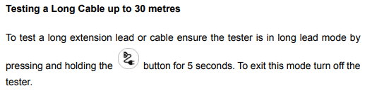

BTW I notice from the manual that the tester has a "long lead mode" and says it is for leads "up to 30m", were you using said mode. If not that could well explain a failure.
Quite - although the lead testing section (p16) does indicate that the 'Polarity test' includes a test for "short circuit" - so I imagine that relates to the "short" failure message matty said he got - even though the manual does include that one in the displays it describes (I suspect it's meant to be "x Short").
However, as I've previously implied, there are at least two crucial things that (unless I'm missing them) the manual does not appear to be telling us. Firstly, as regards this poorly-documented 'short circuit' test, is it talking about an L-N 'short' (I presume it is) and, if so, what is the (numerical) criterion for failing this test? Secondly, what is tested for the 'Insulation test' - L-N, (L+N)-E or what?
Those things are crucial because, since we've been told that the cable passed the IR test (which the manual says means ≥2MΩ) then if that's a N-E resistance measurement, then it would clearly could not also be a N-L 'short circuit' by any credible definition - so, if that were the situation, I see no alternative to the machine being faulty (or, at least, behaving incorrectly). Indeed, even if it's not N-L that is being IRd, we still need to know the nature and pass/fail criteria of the 'short circuit test', since matty's other measurements do not seem to be compatible with anything that could sensibly be called a 'short circuit'.
Indeed - as you will have seen, I've already asked matty if he pressed that button. As I also said, we are not told what happens (electrically) if one does use that mode and, if we did, it might give us some insight into what the machine is actually doing/testing!
