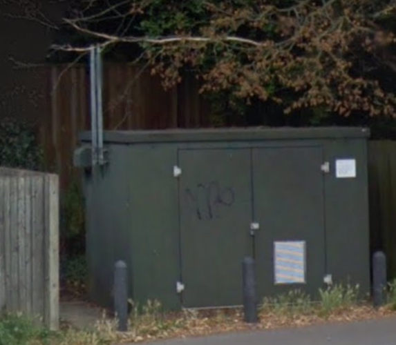

I did some subbing for a controls company who specialised in water treatment, we had a green 'cabin' in the workshop, this sort of thing:
Their own electrician, as opposed to controls wireman, had wired in a 5KVA 110V isolating transformer feeding 4 16A yellow sockets each with their own 16A MCB in a seperate ('110V') CU. It was powered by a C20 MCB in the 230V CU.
I instantly spotted he'd used SP MCB's for the 110v and queeried it with him. I was told to mind my own ******* business and go back to my 'little toy wires'. Bearing in mind I was only temping there and hoping to continue I dropped it until the following day when the the Contracts Manager came to the workshop and pointed it out to him. He advised it was normal and done by the qualified electrician so it must be OK. After that I spoke to MD who asked what the problem is, but he didn't understand.
I got a long (20m sort of length) piece of 1.5mm singles from the scrap bin and poked it in the 'E' & '-' holes of a yellow socket and waited. The MD switched it off when things started smoking and called the Contracts Manager for a demo. Then they called the electrician and asked him to come in, He wasn't happy as it was Friday and already finished for the day.
