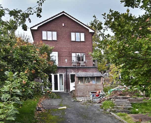

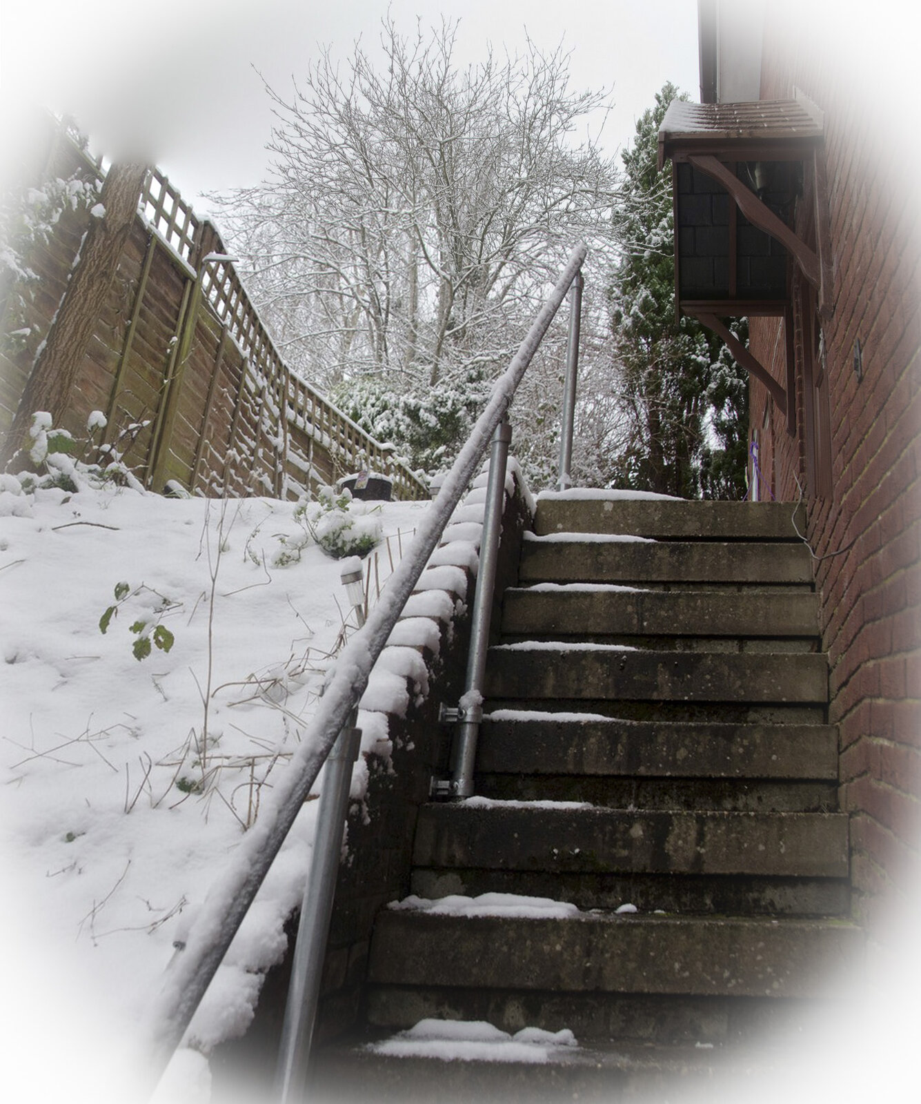

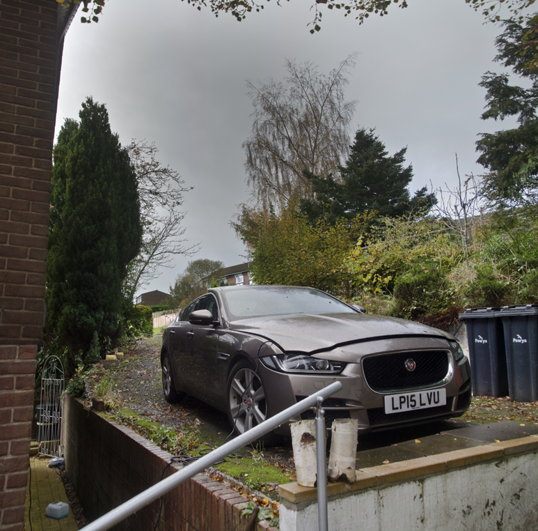

The house when I moved in had two quartz halogen lamps with PIR's, these needed removing to do repairs, but the PIR would turn off before I had reached the door, and would also trigger when not required, so aim was a light I could turn on before I get out of the car, and will stay on until inside the house.

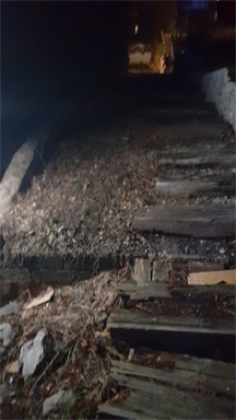

Steps up the side of the house are in poor condition, on my to do list, but the 9 watt bulb does a good job 1673913019752.png room for improvement, but now no need to use the phone as a torch. Still to fit a second one for steps other side of house, and one to fill in the gap between the lamps.

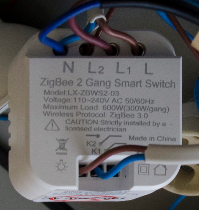

If it were me I'd probably look to just have normal lights switched in/close to the house using a wired in smart switch of some kind.

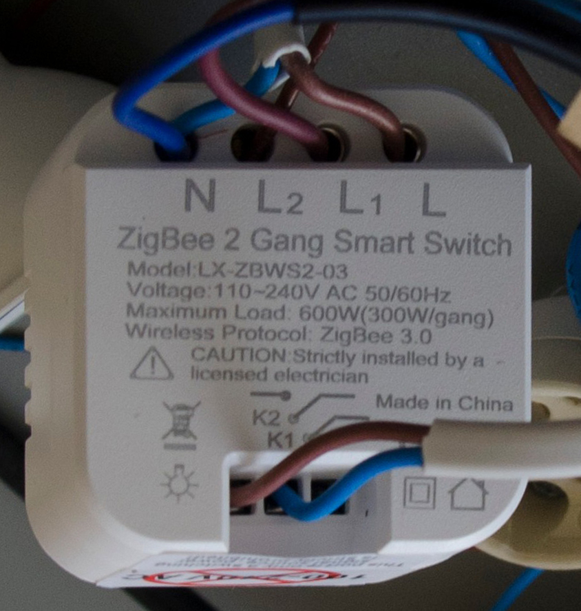

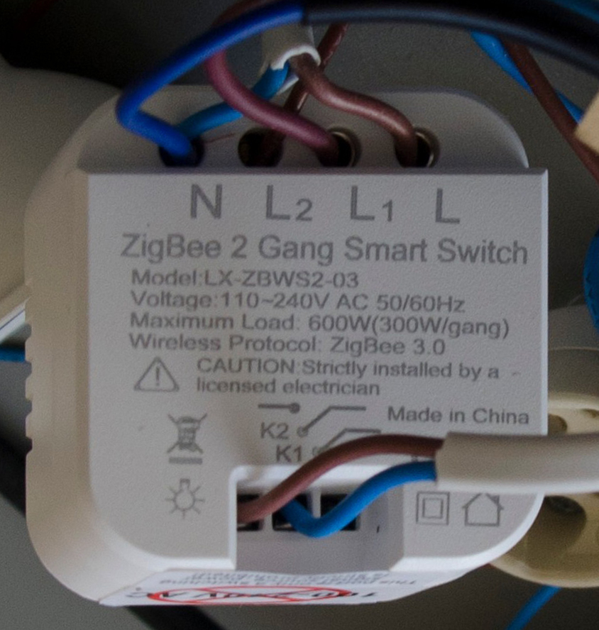

I did consider another smart relay, DSC_6061r.jpg however would have needed to order from internet, could not really pick one up last weekend, the bulb I ended up using was zigbee so it has the hub a lot closer to it. I hope down to phone being 5 GHz and the tablet 2.4 GHz it was all well and good the instructions saying set to 2.4 GHz but there did not seem to be a option on the phone to switch to 2.4 GHz and the router is always running both.
Going out not a problem, can turn outside lights on/off from main house, returning is the problem, when we bought the house it had quartz halogen lamps with PIR's on them. The distance from where car is parked to house Railings Small.jpg means the PIR's did not see me park the car, so first section was in darkness, the shed does not help, and doors into main house are up steps either side, so as we started on the steps the lights would switch off.
So switching on lights with the phone seems the best option, also smaller wattage so we can leave lights on for visitors. The steps to left are steep but have hand rails, DSC_4477-9_1.jpgto the right tend to get slippy in wet, but not as steep, my preferred route, and wife parks at top of house, 1673955145693.png which also has lighting problems, hardly any light from street lights, so she turns on her bedroom lights to give just a little light, OK if we remember and turn on outside lights before leaving, but if we intend to arrive back in daylight and have not turned them on, it is a case of using phone to light the path, tried a solar light, but depends on the cats, if they have been walking past it and triggering it, likely flat when we get home. And the slope tends to get moss on it, and easy to miss edge of steps, so regular weed killing and lights required.
Never mind intruder lights, we want lights for us an visitors. The latter we can set time for milkman, and others tend to arrive in the light, so lights only for leaving. The trees mean PIR at top of house with wall lights is on/off all the time, even without cats, and still does not see us, until after first step, so smart lights seemed the way to go.

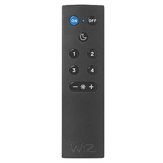

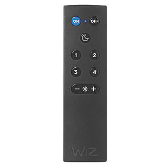

I look at the smart remote 1674122710492.pngat £11.74 so you can switch bulbs without using phone or voice so you can get bedside control for around £25, some 5 years back, I needed a hub and smart switch, plus the remote, I paid over double that when I set up energenie, OK remote also worked sockets which the extruder alarm was plugged into, so other reasons for that route, but the smart bulb is a cheap option. OK table lamp was easy option before, for years we each had table lamps by the bed, and they did get knocked over trying to find them in the dark, I still knock my remote onto the floor from time to time, but I can simply pick that up again, it does not smash. And I can revert to Hey Google turn on lights.
I will admit the switches and lamps at the side of the bed in the old house was better, but that was a lot of work wiring up them, the smart bulb is so easy, once one learns how to program them.

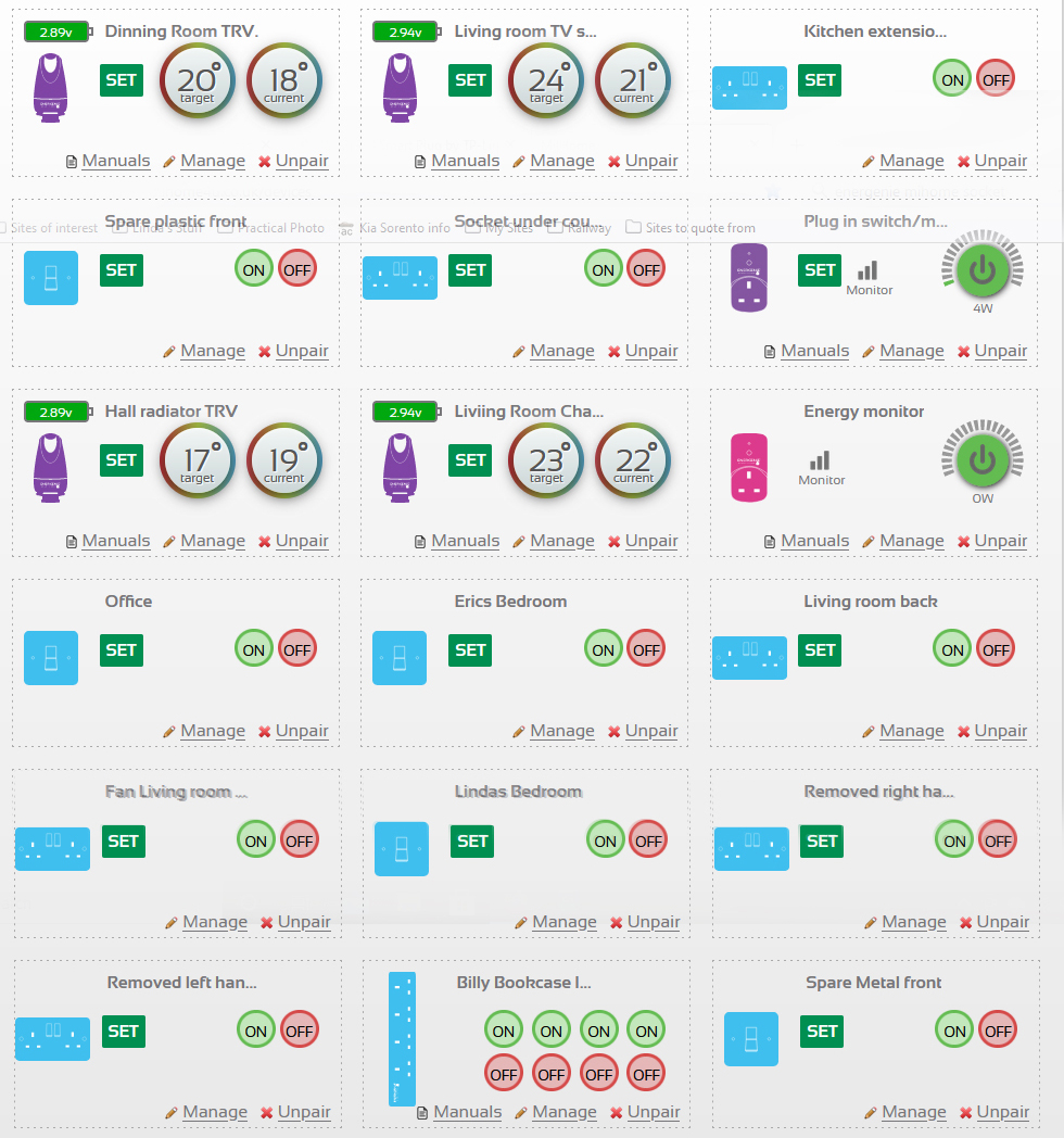

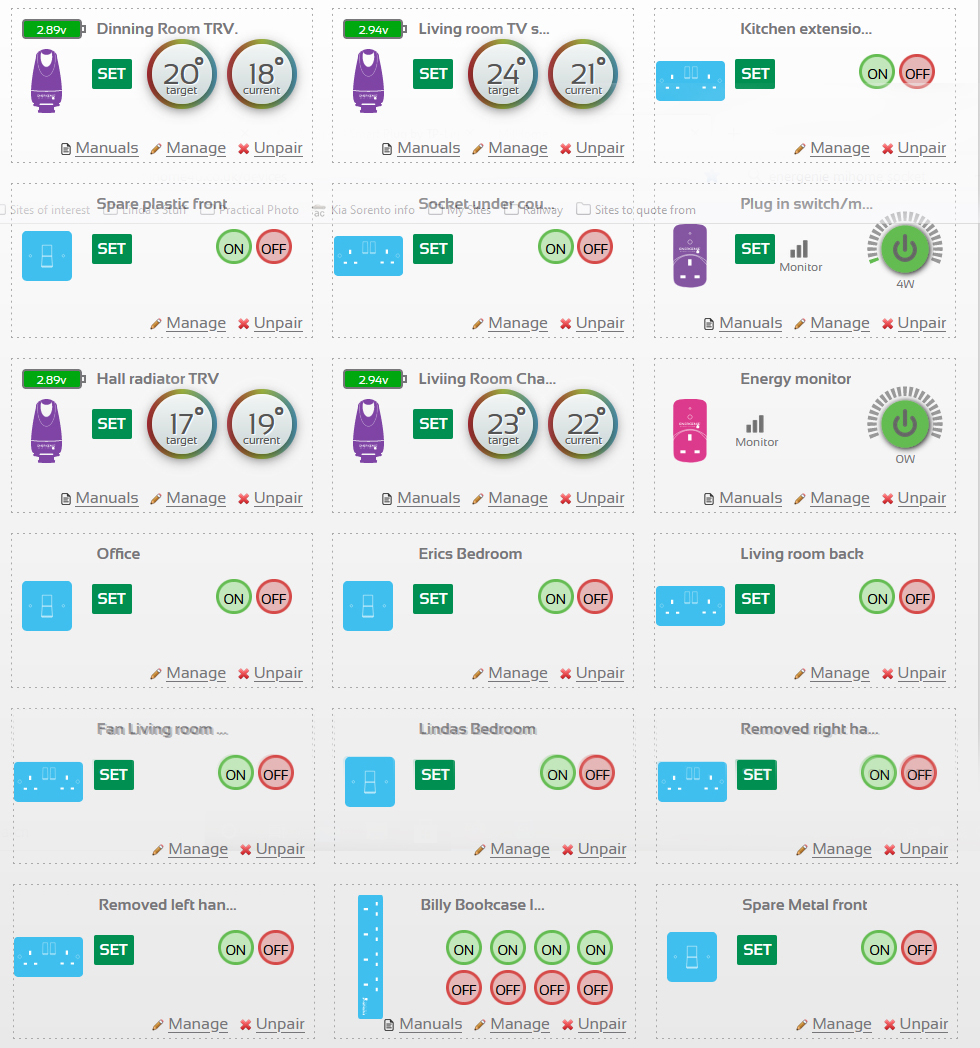

I also started with one make, in my case Energenie Mihome, it was some time ago, and I had a problem, seems not allowed to lock my late mother in the house, she needs to be sectioned before one can do that, unless it a care home when they it seem use different rules!
So I knew when she had gone on walk about, the social services installed an alarm, this was upstairs between my wife's and my bedrooms, so before answering the door to visitors we had to run upstairs and turn off the alarm, not really a good option. Plus we also had a problem with heating, had one wall thermostat go faulty and turn house into a sauna, did not want a repeat of that.
So we fitted 4 programmable TRV's, a smart socket which the alarm was plugged into, and a light switch so I could turn lights on/off when in bed. These worked well, specially the TRV heads, the rooms once set were spot on, and had I been asked to write a report my only complaint was the socket only had three built in timers, and when we wanted a forth we needed to use IFTTT to get it.
When my mother died, the new owners did not want the electronic TRV's so all the Energenie stuff was removed and came to the new house, and Homebase had a sale of Energenie stuff, very cheap, so we did a trip to Birmingham and bought a load more, so know up to 5 light switches, and also a load of smart sockets, including some which plugged in, with energy monitoring, so the control page looked like this Mihome-used-crop.jpg and now the problems started, I have removed 3 light switches and one double socket, touch wood all now seems to be working OK, but it seemed it was due to how much I had on the same system.
Next was Lidi and I got some lamps being sold off, then realised I needed a zigbee hub, which I got from the internet, and the devices worked well, but Lidi don't stock them year round, so realising how well they worked, we needed a supplier who could supply the good year around. The Livrno flexible strip light worked well, I had one in the centre of our display cabinet, but the two Ikea units either side were a bit dated and not smart.

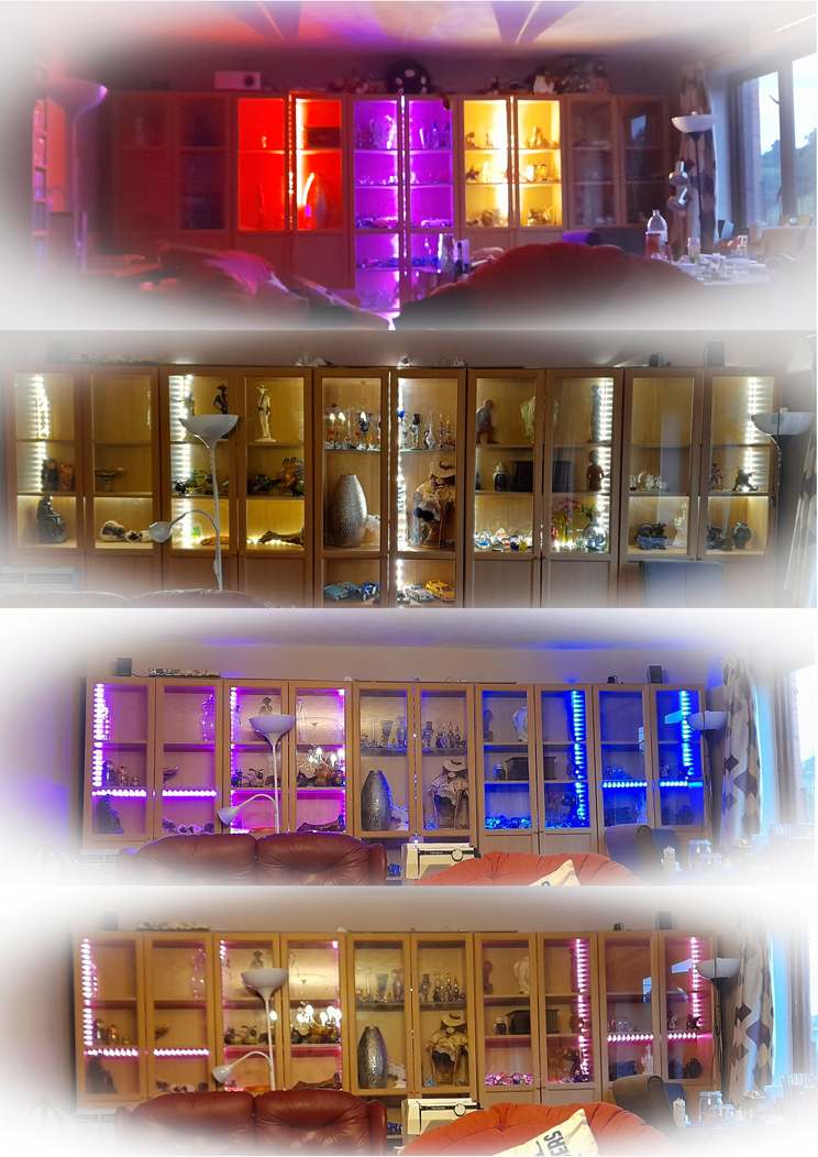

The top picture was with Ikea Display-cabinet-lights-small.jpg but there are 5 units, and only 3 lit, so went with Screwfix, TCP 5m LED Smart RGBW Striplight 17W 1500lm (576PK) which when one of the wallmarts failed replaced it FOC so glad I went with them. And 5 meters was enough to do two display cabinets so TCP either side and Livrno down the centre, the Livrno does seem better made, but TCP easier to install around the corners.
So now three makes, not set out to have three makes, it was just what I could buy at the time, added a relay DSC_6061r.jpg for landing lamp DSC_6799.jpg and then got some cheap outside lights £2 each, to replace the quartz halogen with PIR as did not want to run tungsten any more, and the PIR did not really work very well, turning lamps off at most inopportune moments, so in all 7 outside lights, 3 existing still with CFL bulbs, plus a bulkhead lamp and integral lamp both run using plug in smart adaptors, and 2 with smart bulbs in, one smart bulb was in stock had been used on the landing before new lamp.
