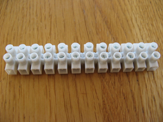

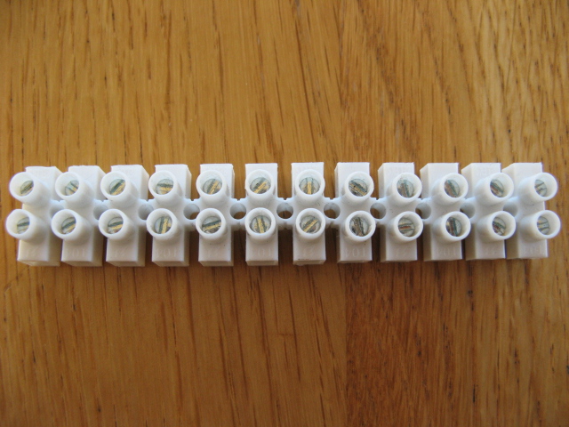

Hi
I've got some choc block I want to use but it doesn't say what amps it is rated for... It does say 450V, and 2.5 square. It's white. And a strip of 12 measures 94mm X 17mm. Any ideas?
Cheers
Thanks rsgaz. So would make mine good up to 24 amps if I'm reading that right???

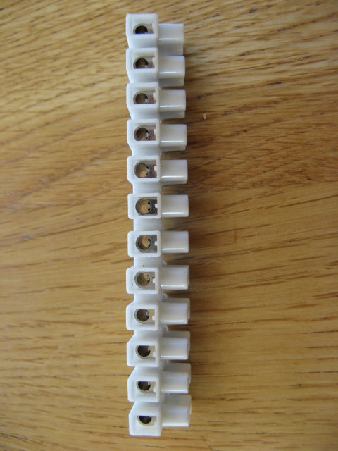

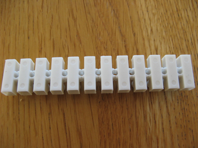

In case it helps, here some pics of what I've got.
Cheers
The amp rating, is more a guide not of current rating, but of the cable sizes you can get into them.
Best current rating is achieved by having the wires overlap, rather than rely on the connector to pass the current. If joining two cable poked into the same end, ensure both push in for the full connector and both screws tighten onto both wires. Likewise, if used inline, push cable in so they fully over lap and both screws tighten onto both wires. That minimises the resistance of the connection and prevents in becoming the weak link.
