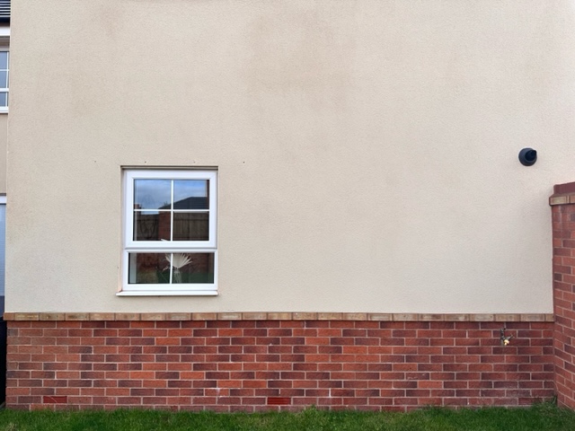

Hi All, I'm looking to replace a window with bifold doors, so will require a lintel fitting and a significantly bigger hole cutting out of my wall. I've been informed that patching it back up is likely going to be a different colour, due to the colour of render I have (ivory) so I don't want it to look a mess. I was hoping to get some inspiration/suggestions of alternative ways to solve this problem without having to try and blend it in to the existing render. Thanks
Paint the whole wall afterwards in a colour match, then stop at the corners, any slight colour variation will not be noticeable at changes of angle.
