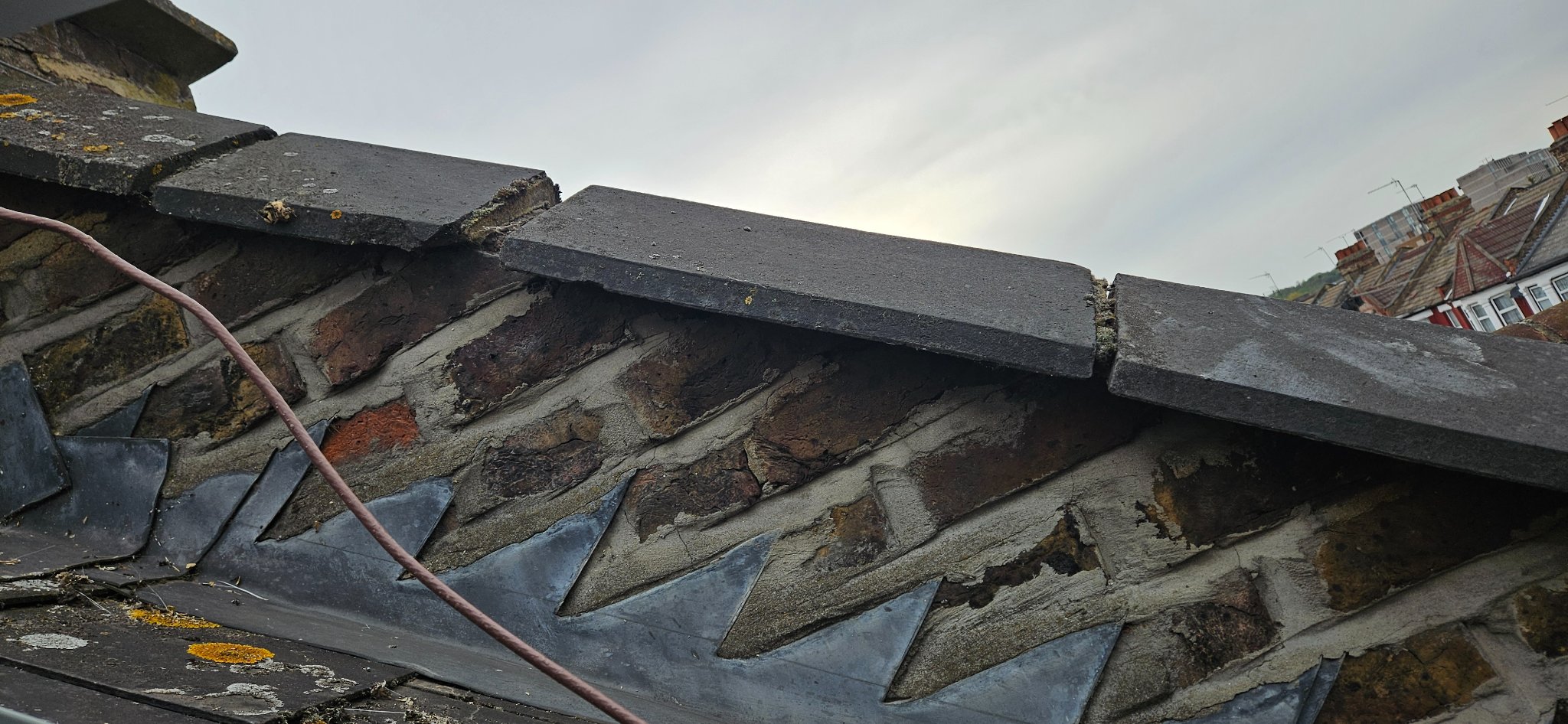

I have some scaffolding up because we're having a loft conversion and I noticed these coping stones that separate our house from next door. They look loose and I'd like to get them repaired or stabilised. But I don't know what the right name for them or what the process is to repair them. Any advise please?

Saddle back coping stones. Just like what you put on garden walls if you want to watch some videos
They look a bit light for that location, so make sure you do a good job sticking them down, and jointing them together.

In the loft & the rooms below are there any signs of water penetration on that party wall?
The parapet in general is in a poor condition.
The roof cover & the flashing appear to have been wrongly fixed.
While the scaff is still there perhaps you could contact the neighbour & work togther on both sides of the parapet?
It would pay you to correctly fix the roof before any dormer is built.
I could ask the builder to re-lay them but I'm pretty sure he'll get the labourer to do it and he's a bit slap dash for my liking and that's besides the charge and VAT.
If I can muster the guts, I should be able to do this. There a make shift roof ladder in place.
Is it a 4:1 mix? I have a bit of cement that claims to have lime in, might that be better than standard stuff? Do I take them all off or one at a time? Start at the top rf bottom?

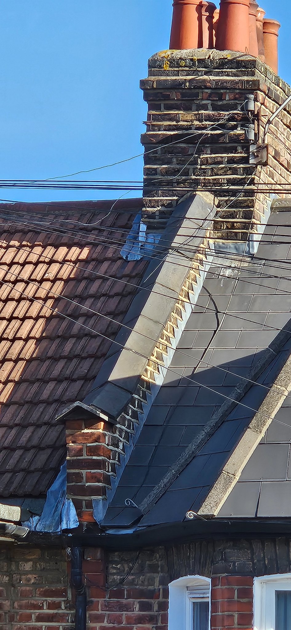

This is what my the hiuse opposite looks like.

Do yourself a favor and hire a roofer. One fall would be your last.
Andy
No to the mix and lime
3:1 sand/cement, and the sand ratio needs to be at least 1/3 sharp sand.
The wall and the copings need to be thoroughly clean and dust-free and then well bonded with full joints.
You would do them all at once and you need to line them through with a string line.
Don't underestimate how hard and awkward it is to do this work.
FYI, if you instruct the builder to do work, that implies that it is done by a proper tradesperson for the work. But if you like, all you do is say that you expect a bricklayer to lay the copings and the labourer to do the mixing and bring the stuff to the bricklayer.

I presume that both pics show the same front elevation of the same roof?
The fibre cement slates & the flashing in the new LH side pic are correct - the RH side parapet flashing and slates should be re-done just like the LH side.
Why not check out the two parapets on the other rear elevation of the roof?
FWIW: The copings in the new pic also need re-bedding.
In both pics all the pointing on parapets & chimney stack is very poor - merely smeared on for a few mm's depth.
