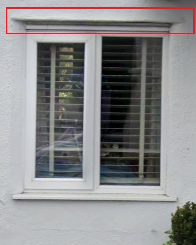

What are these details called and what are they made of?
2 Feb 2020
20
Hello, in the picture below, what is the highlighted detail called? I don't think it's part of a lintel (but I may be wrong). And what material is it made of? Thanks
14 Mar 2006
18,630
2,179
Kent
Are you referring to the rendered Bell drip on the lip of the reveal?
