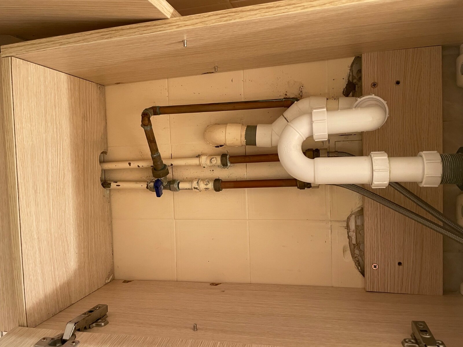

I want to redo the downstairs loo.
I’m have zero plumbing skills but a lot of time and patience.
what is going on with these pipes though? Why isn’t there a hot, cold and waste? Is there an extra cold pipe?
Ah sorry. That’s loaded on its side. It’s like that but vertical….
Looks like a feed to something on the other side of the wall. Outside tap? Appliance?
  • Thanks
Reactions: NRS
That’s exactly what it is! Thanks very much
If it’s an outside tap, if you’re going to re-do everything then you should consider installing a non-return valve. This is a legal requirement to prevent water from e.g. a hose pipe from re-entering the fresh supply.
(It’s possible that you do have a valve, but it’s incorporated into the outside tap itself.)

Thanks for this. Will look into it. I would not be surprised if there is no valve.
