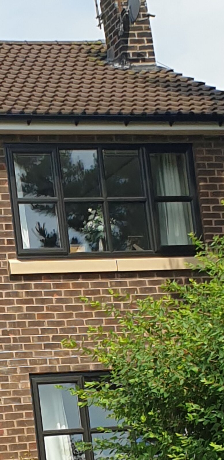

Can anyone tell me what these stone cills are called, and are they easy enough to install retrospectively? I assume its just a case of removing two courses of brick.....

I know they're external stone sills, but what type are they when they are stooled at one end and not the other, so two can be joined together like these two
composite stone cills -over a certain length they are supplied in 2 parts

pleaser note your existing windows probably have a cill projection -that will need removing for a stone cill -and if upvc you need face drainage
