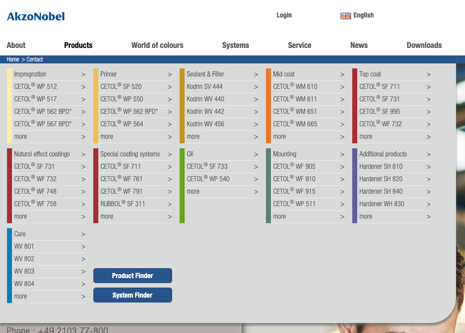

I get lost when I look at their product page: https://www.sadolin.co.uk/products/ so many! I THINK I want a penetrating water prevention product but when I look on their garden furniture section they only seem to have woodstain products.

This is precisely the problem... a page of links longer than my arm is information overload. I want the manufacturer (or a professional) to tell me the right product for my project. I looked at a couple of their case studies on timber cabin type buildings and they didn't use the same products despite seeming very similar!

At least Sadolin have people... this is the Sikkens website:
Their only phone number is seemingly in Germany for technical questions, I have found a local dealer so we'll see if they can advise. Unless anyone here knows what type of product is suitable for smooth planed exterior spruce and can advise?
