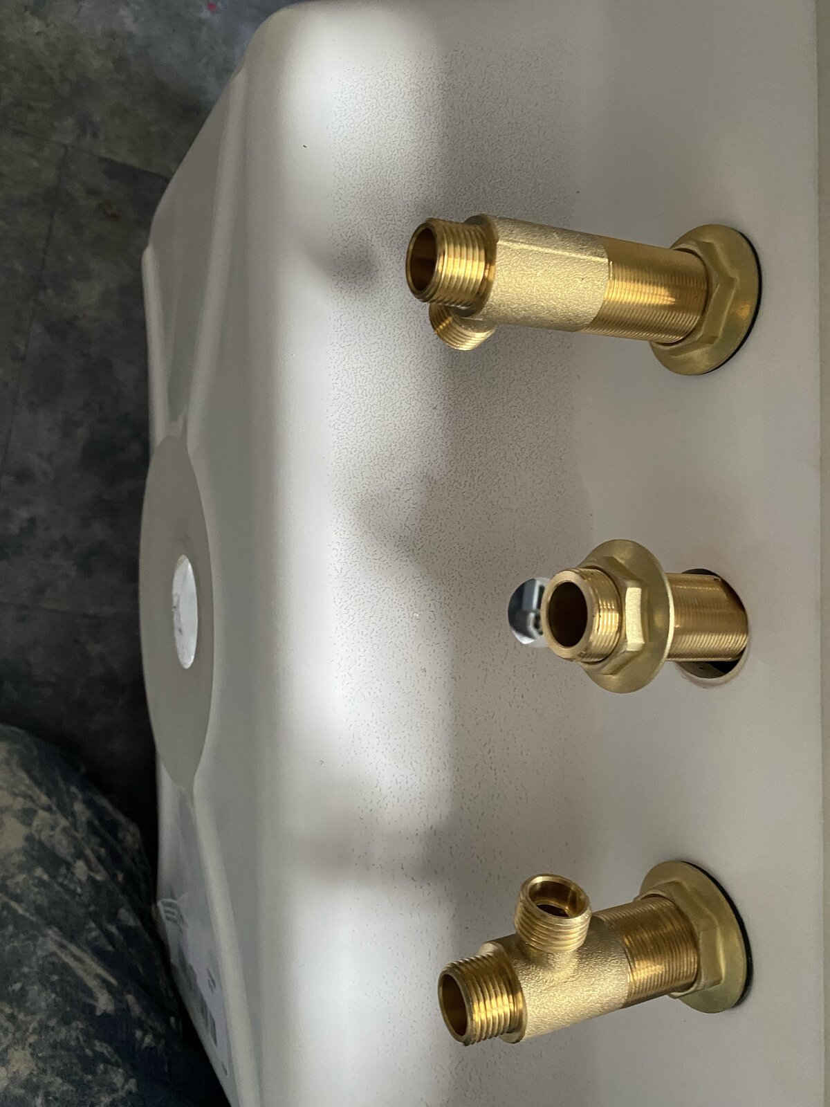

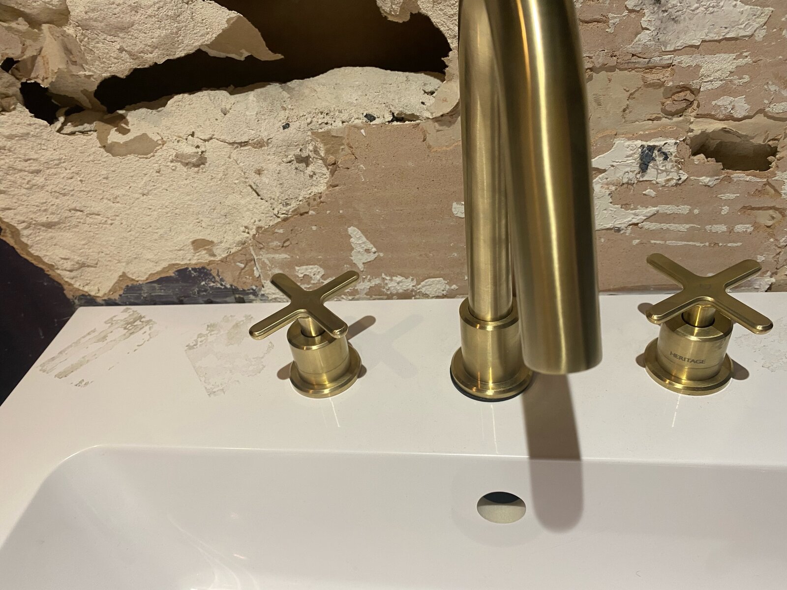

Can someone be kind enough to tell me what fitting(s) are required to connect the basin taps in the pictures which show the taps and the underside of the basin - what fittings go here?. The person who bought this got it in a sale and did not get those vitalparts Any advice ofwhat and where to get the parts will be greatly appreciated

Tap tails could probably use tap connectors. For the mixing part, unless you have the same one, or can source one online, I would say a tee and nut/olives or again, tap connectors or nuts and olives.
