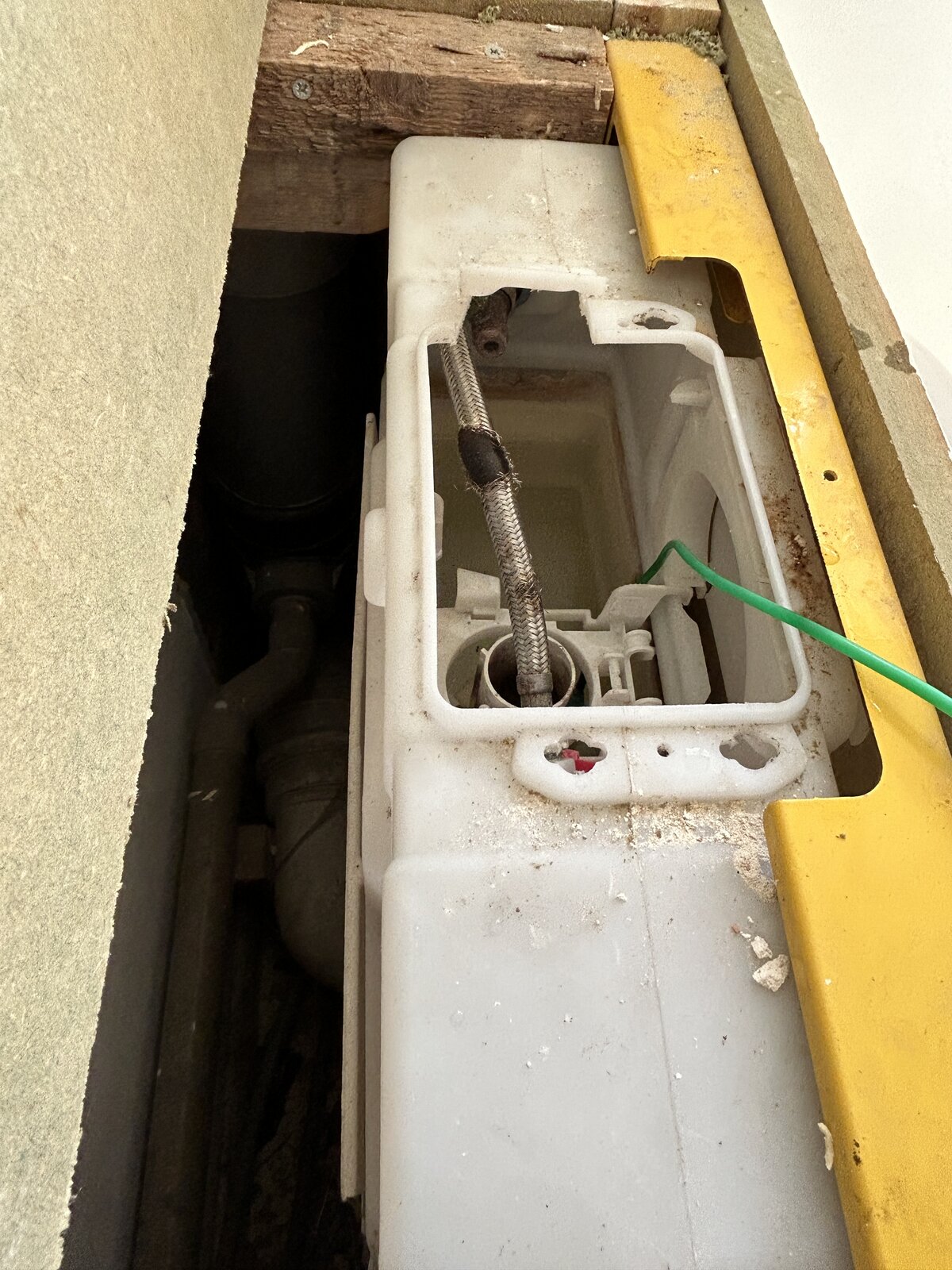

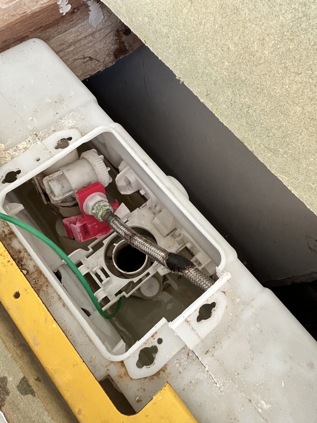

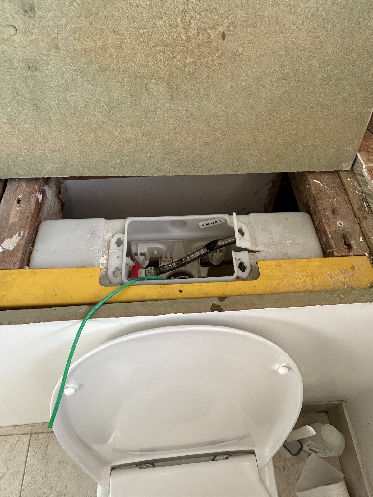

Afternoon,
I need to replace this concealed cistern.
Does anyone know what it is and is it simple to swap out?
Cheers.
AE48F1DA-A269-41DE-8999-8C03D8CC12FD.jpegAE48F1DA-A269-41DE-8999-8C03D8CC12FD.jpeg4C9A421F-3D42-40CE-8D1A-DA3EC1444C9E.jpegA70286F1-74A6-4C12-A231-4A2906FEC8CE.jpeg3580FA99-4A12-4BF1-9CE5-1E39AE70C05B.jpeg

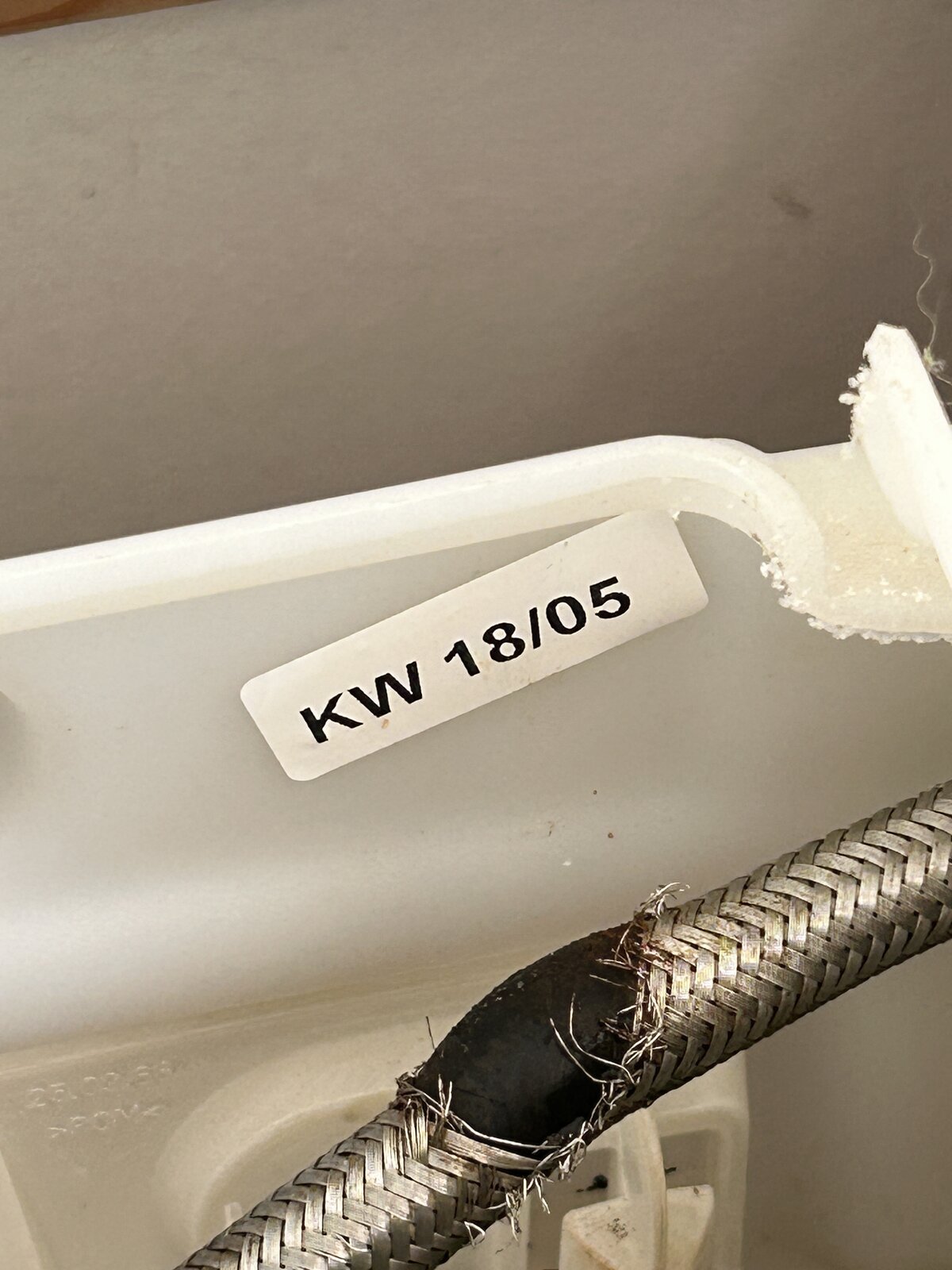

1. Sorry, can't help on what make it is, but have a look at KW bathrooms web site.
2. If you are only replacing because of the damaged flexible pipe, you can probably just replace the pipe.
Are they all compatible?
I'd like to install a Viva as I like their product's.
I would say so, only thing you need to be aware of is the outlet size for the flushpipe, if it has one, if it’s close coupled it might not be compatible.
