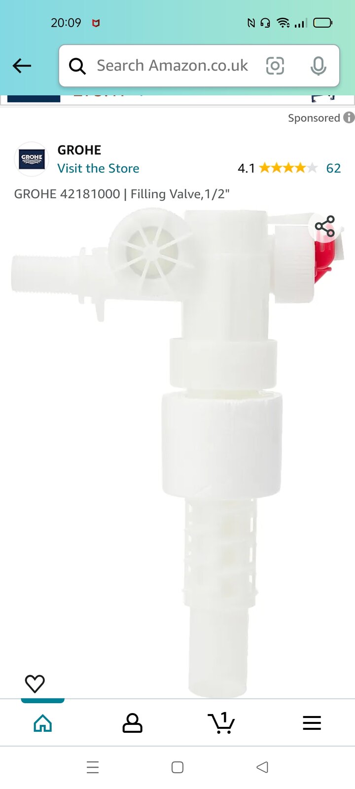

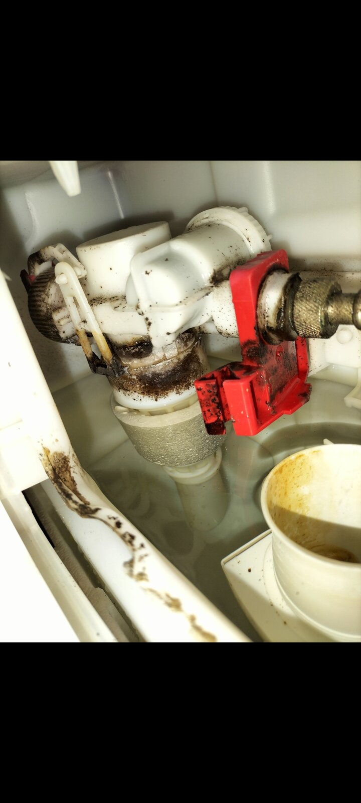

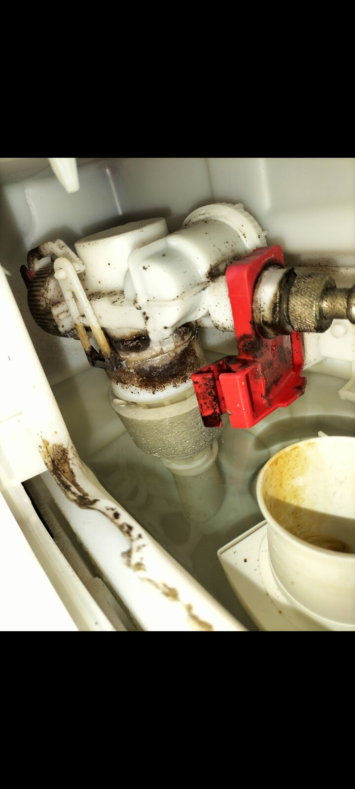

Hi does anyone know which grohe fill valve this is for a this concealed cistern. It's constantly filling needs swapping. Thank you
Yes, you can cut the water supply in the cistern, remove the fill valve and fit a new washer.
Andy

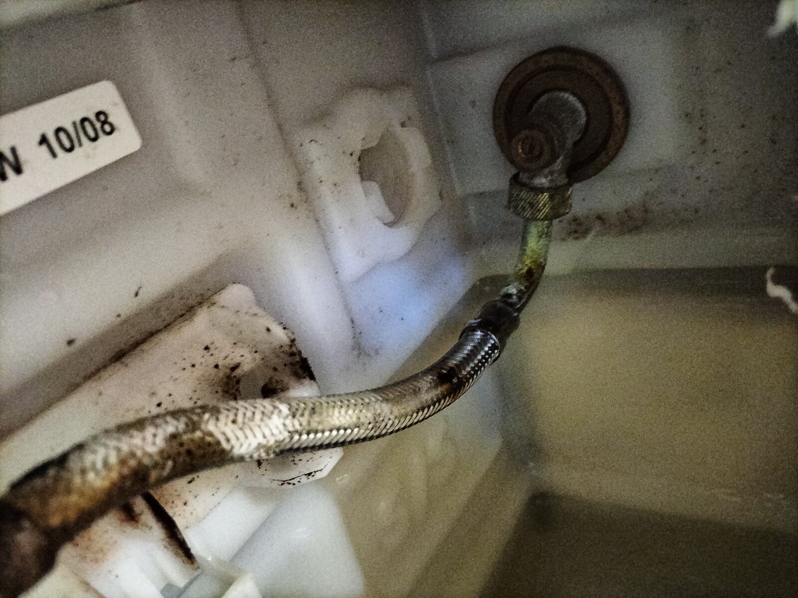

The Flexi also doesn't look the best

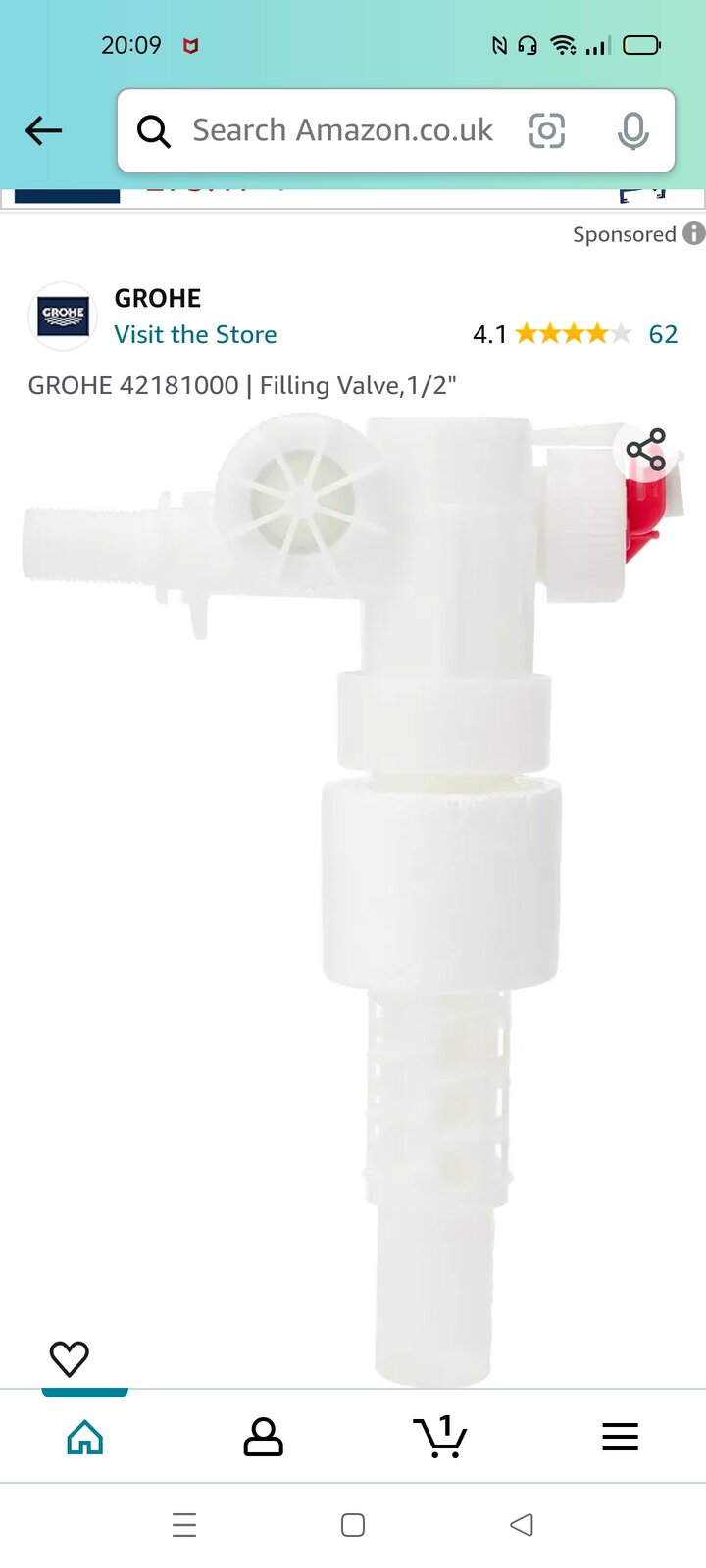

And this would be the fill valve? The one that in is 1/2 inch?

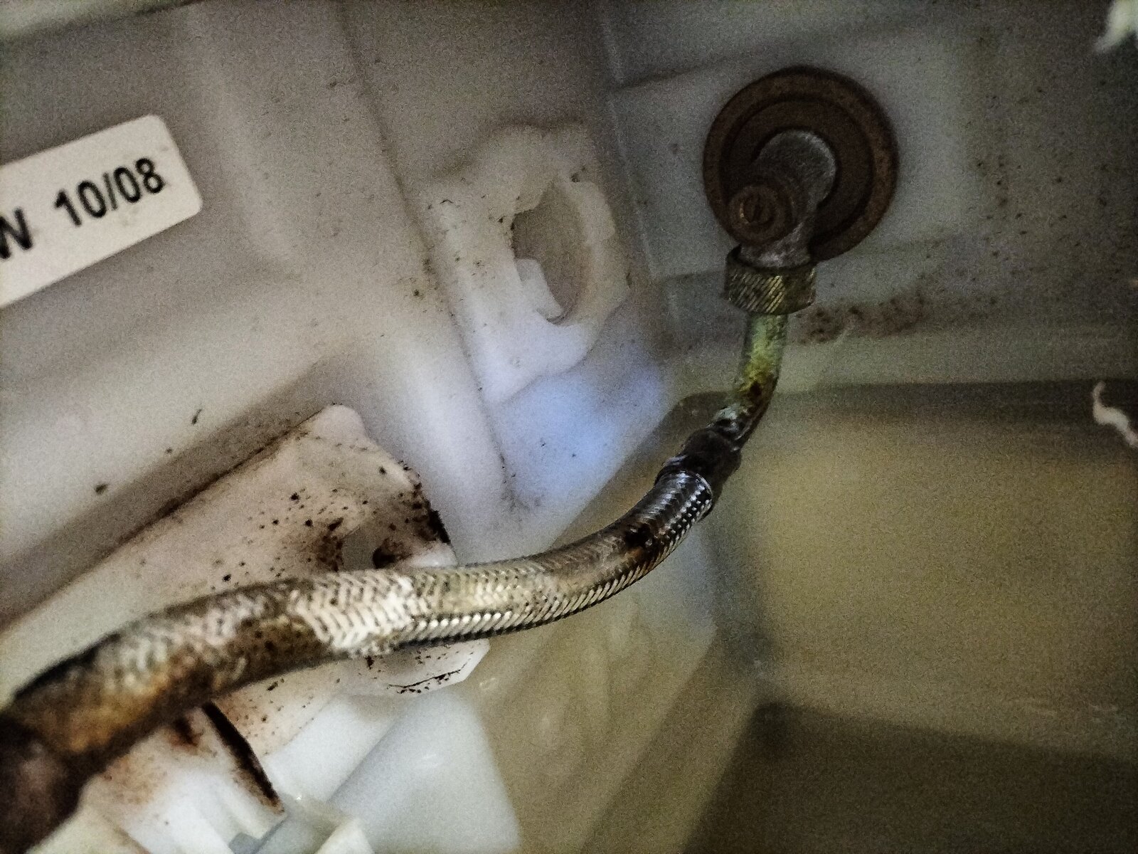

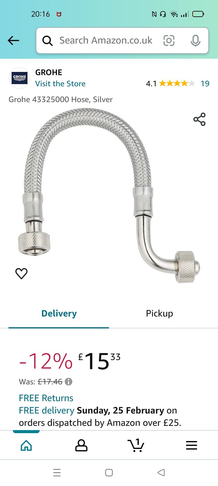

Thanks and that would be the Flexi?
I wouldn't worry about flexi. That just a bit of waterborne gunge of the water. Bit of bacterial growth in hot weather etc.

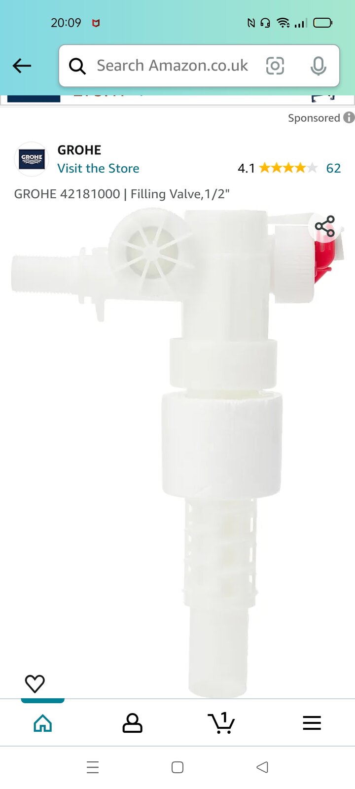

Also can I ask are this fill valves adjustable height? If so how do you adjust? Thank you
