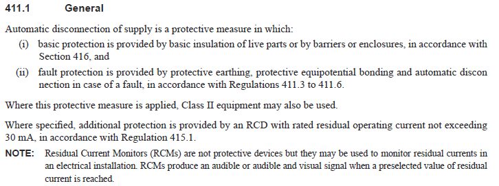

Well I think we understand each other, your position is that if it's what they think it is it should be called EEBADS or ABCDEFG or something else random, and not misleadingly call it ADS. ... My position is that when I mentioned it in my post, I was meaning according to the iet definition ...

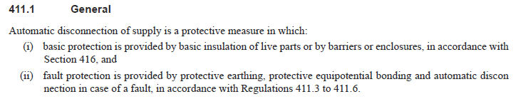

Fair enough, but I still struggle to understand what this 'definition' (there isn't actually a definition in Part 2 of BS7671) is trying to say. I presume you are referring to this ...
It surely can't be intended to mean ...
Automatic disconnection of supply consists of the following ...
  • basic protection
  • protective earthing
  • protective equipotential bonding
  • Automatic disconnection of supply
... can it?
It just doesn't make sense to say that <something> consists of three other things plus that <something> (particularly when those three other things appear to have absolutely nothing to do with the <something>), doses it? So, what on earth IS it trying to say?
That list seems to be a list of all of the main measures required by BS7671 to provide 'Protection Against Electric Shock' (i.e. all of Chapter 41 of BS7671), so to call it "ADS" (which is just one of the many measures) seems just plain daft to me. Should it not simply be called "Measures for Protection Against Electric Shock", or something like that?

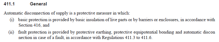

It is perhaps being overlooked in this discussion that "ADS" does not appear anywhere in the current version of BS7671 (and maybe never has in previous editions). It does have a good few mentions of "Automatic disconnection of supply", but I would like to think that "Automatic disconnection of supply" means Automatic disconnection of supply.
That's what the protective measure encompasses.
Wrong way around. 'Protective measures" (against electric shock) encompasses 'Automatic disconnection of supply', not the converse. Hammers are tools, but it would be ridiculous to describe all tools as hammers.
