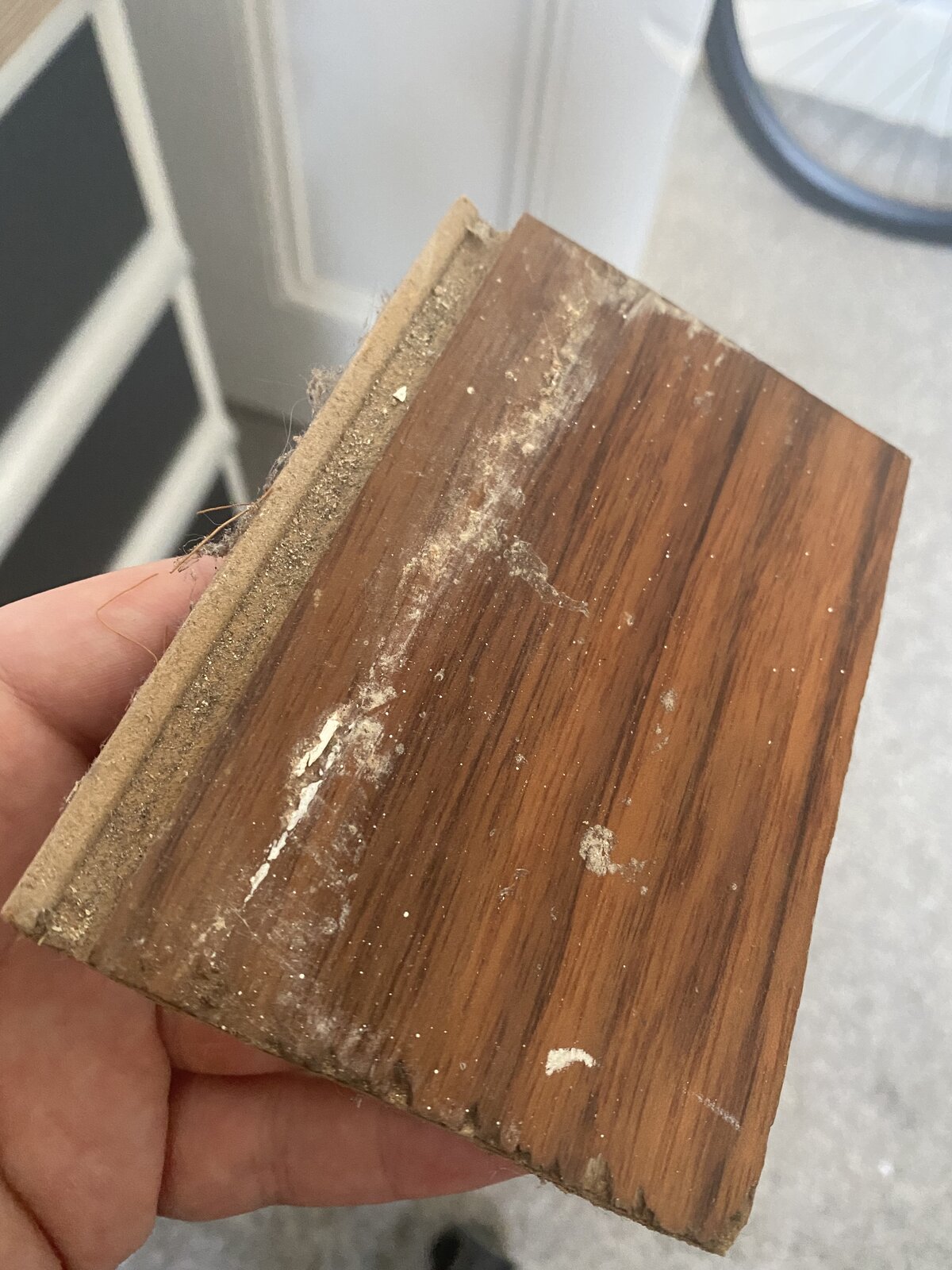

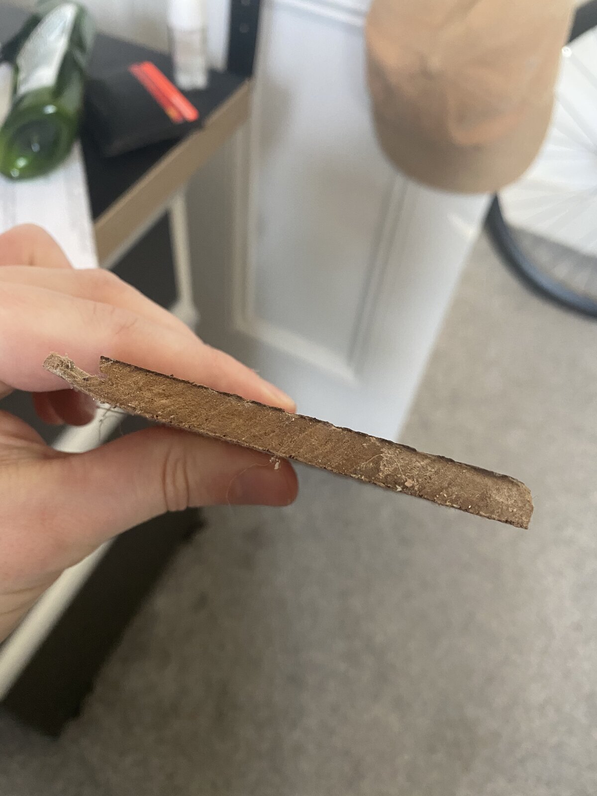

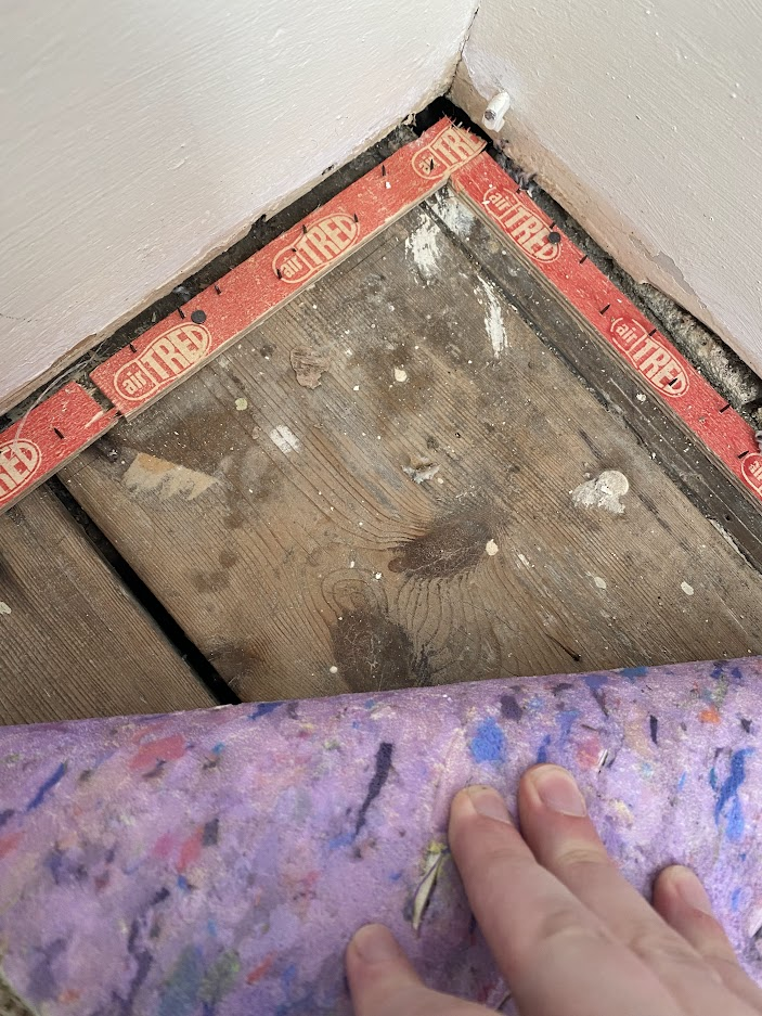

I’ve attached photos of a loose ‘board’ which I think is ‘engineered wood’ or laminate?
As far as I can tell I can’t stain or paint this.
From the other photos it looks like it’s on top of traditional wooden floorboards (which themselves are on top of a wooden subfloor).
We want to change the floor but what are the options? My worry is the eng wood / laminate is glued to the original floorboards and therefore impossible to remove?
Any help would be much appreciated.

Given the foam underlay, it isn't glued down.
It looks like a floating floor. It looks like a MDF click laminate.
Correct, you won't be able to paint it.
of course! can't be glued if there's an underlay there... thank you

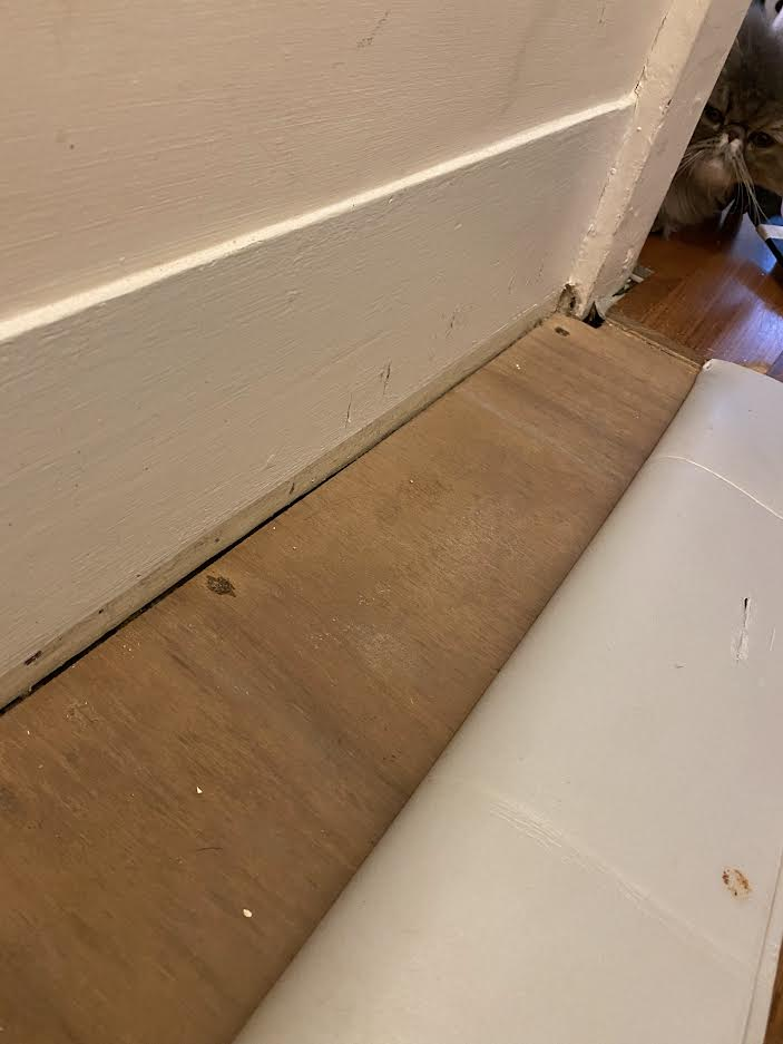

Are you absolutely sure that the sub floor is timber? The bit in your photo almost looks like plywood- but I may be wrong...
I think you need to lift a sizeable section of laminate before you can workout how to proceed. If your existing boards are in a pretty poor state, you may need to match the timber at a local reclamation yard.

Judging from the manky edges of original floorboards actually visible in the 3rd photo, I'd hazard a guess that the iriginal boards really aren't that wonderful. Possibly why someone laid lami ate o er the top of them in the first place!
The only way to tell if the floor is recoverable is to lift the laminate and underlay completely, vacuum out and thoroughly examine it. Matching replacement boards are probably not going to be readily available, and it is highly likely that there are other plumbing and electrical installation "repairs" lurking beneath that laminate, so you might be opening a can of worms

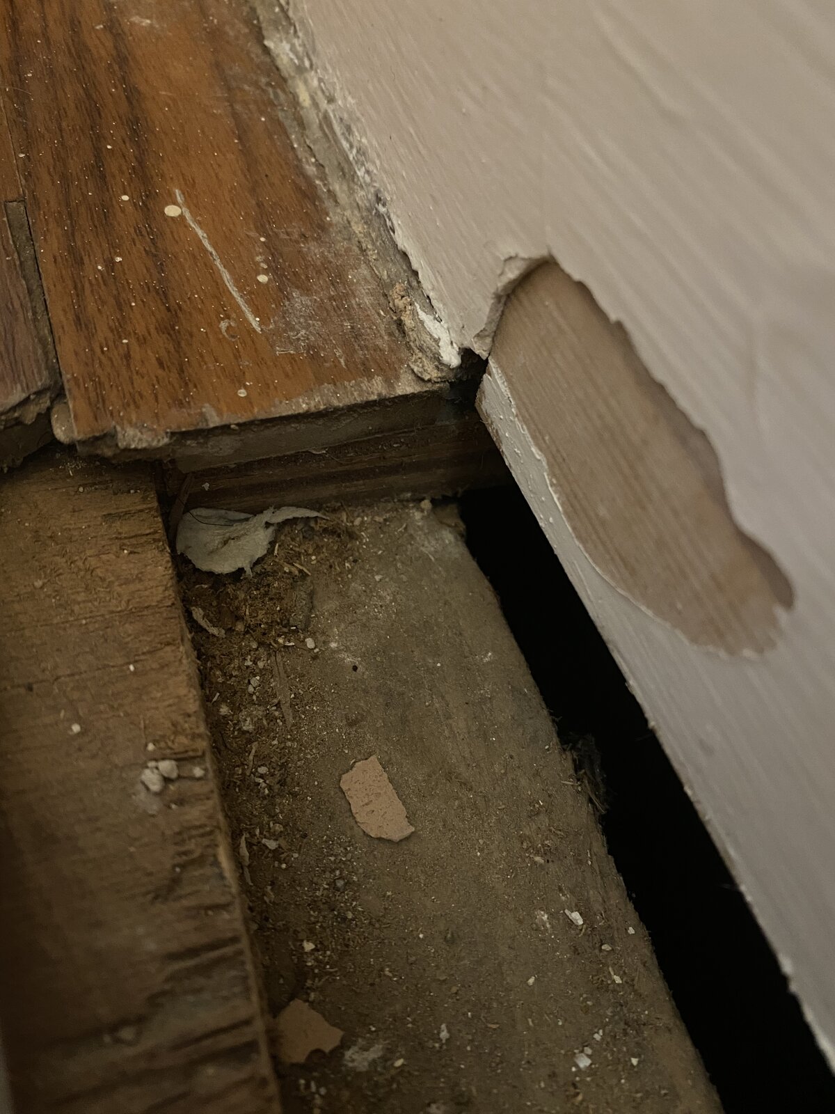

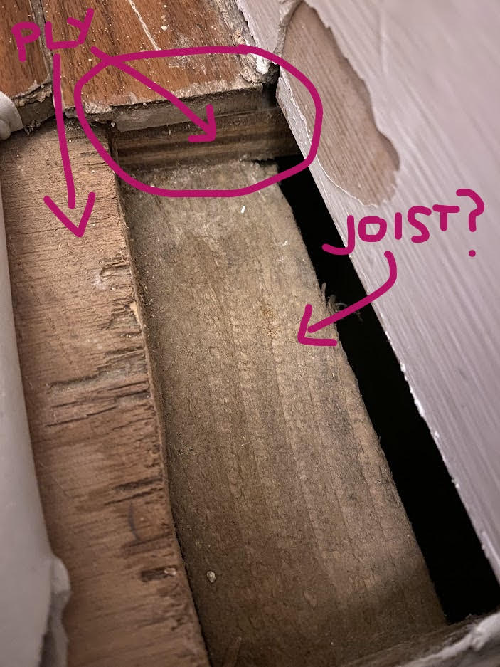

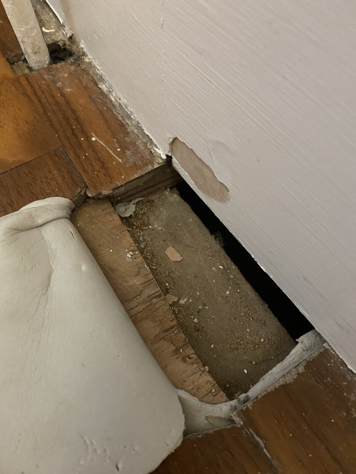

Thanks for all the replies on this. I had assumed there were original floorboards under there because that's what we have upstairs:
However, having removed some of the laminate, and inspecting the existing 'hole' further, I believe the downstairs has had the original floorboards removed and replaced with a plywood subfloor:
If anyone more knowledgeable than me was able to confirm that I'd be grateful!

I think you were right about the plywood! (see my previous post)
