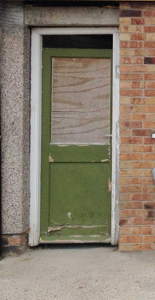

Hello all
I'm going to be re-instating the old outside loo/bootroom.
As it was left in rough 'n' ready state it needs work.
I'm going to fit a new door, which will be higher off the ground, (should have been before) a brick higher than the level of the render on the left.
The floor level inside will also be coming up to match.
What is the 'proper' method for making the threshold/footing?
