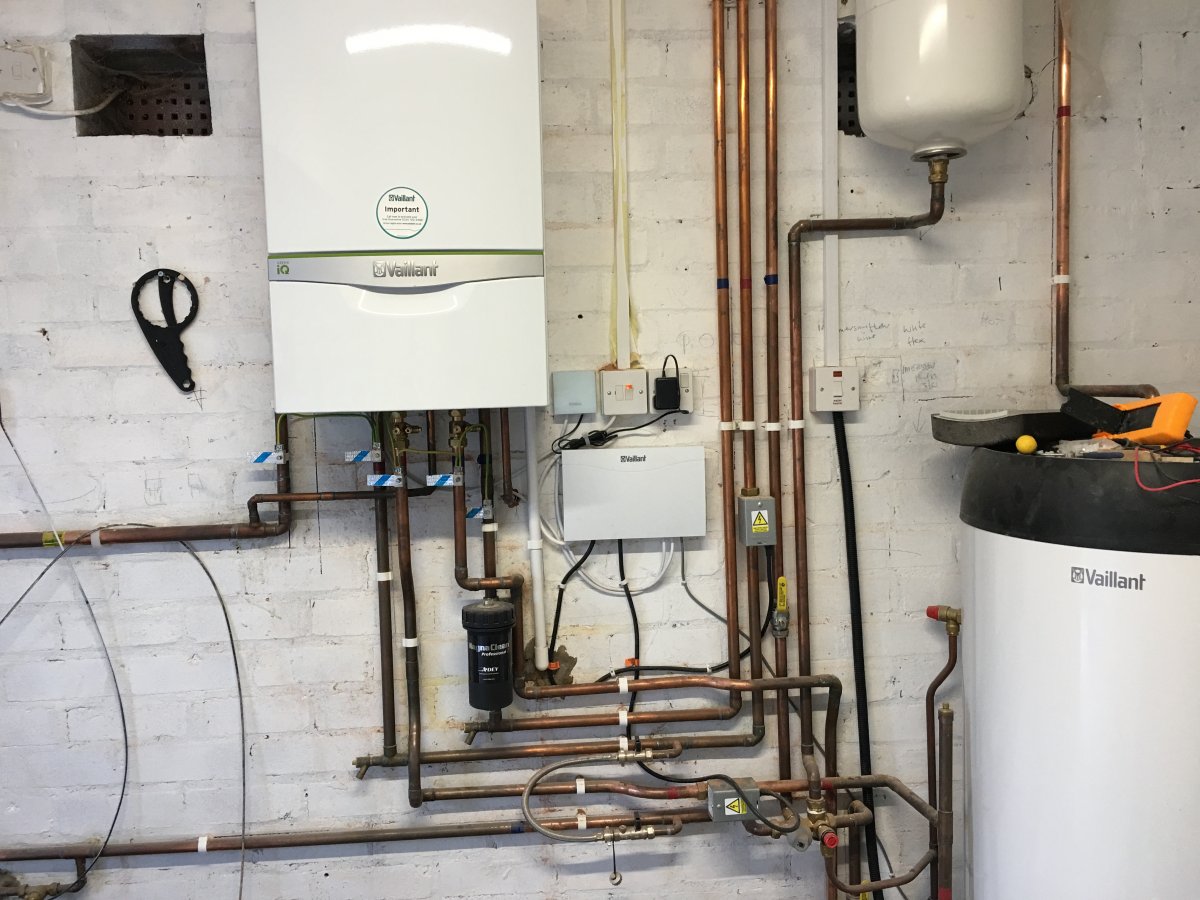

Also another question. Is it possible to know via the boiler what tempreture the the cylinder thermostat is on?
My hot water is not hot enough. I think it's to do with the thermostat. I changed settings to the highest in boiler setting
Solved it.
The thermostat was connected to the control panel. It should have been connected to the boiler
I assume you are talking about the thermostat on the cylinder. The cylinder thermostat is not normally connected directly to the boiler
1. Do you have a vented or unvented cylinder?
2. How many motorized valves do you have, and which type? (see in pics)
Can you post pics of the cylinder and "control panel"
This is a new 627 boiler. It didn't even need the control panel! It has 2 motorised valve which are not even controlled.
It wasn't set up in the ideal way.
I was told by vaillant advance to take the NTc wire directly to the boiler. They said the thermostat wasn't connected properly and it was just getting tempreture from boiler
