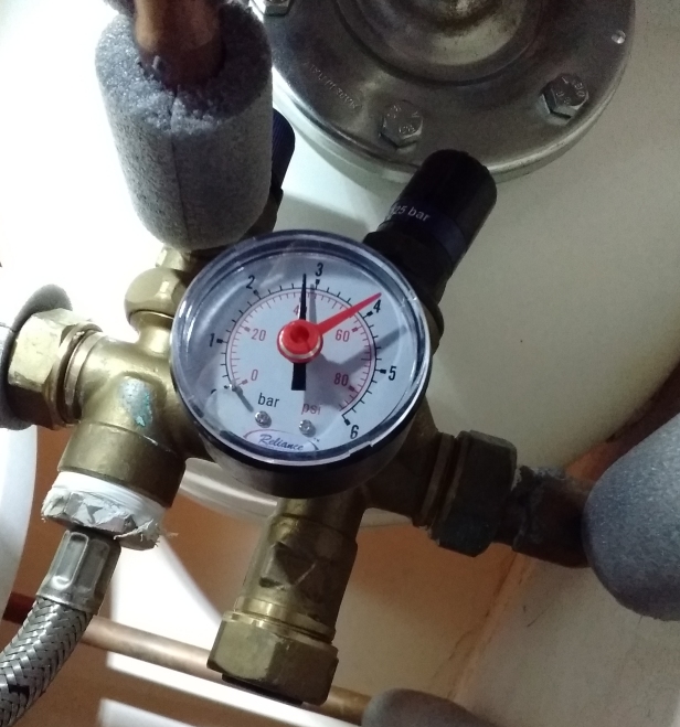

What has gone wrong with my unvented system?
Status
Not open for further replies.
Is there something that shows me the pressure of the cylinder? Nothing is jumping out at me...
Just found this underneath the expansion vessel - that's looking good, right?

Looks about right, what does it go up to when the tundish is running?
It will slow down, yes; and it will stop if I turn off the immersion heater(s) and after having run some hot water off.
My money is that the pressure needle will go up to 4 then it will start running. Probably lost some charge from the expansion vessel so you've only got limited expansion capacity left. Ree charging is a simple job for a pro, and is more likely than a faulty vessel.
How hot is the hot water after its been running? Hot then it usually is off the heating? Scalding hot? Or just very hot washing up water hot?
When it was gushing down the tundish at quite a flow it was very, very hot. I would say scalding hot, yes.
If I put my finger in the tundish space when it's just starting to dribble, then it's merely very-warm! I don't even know what I'm describing there - do I? But you get the idea, it's a lot hotter when there's a lot more of it, which makes sense. I've obviously been turning the immersions off when it starts to release water now... there's no point watching it allow loads of hot water to exit the house (I want it!).

It sounds like around 60c to me? So maybe no fault on the thermostat. Maybe the normal heating never heats it that hot so you didn't notice the expansion vessel loss.
