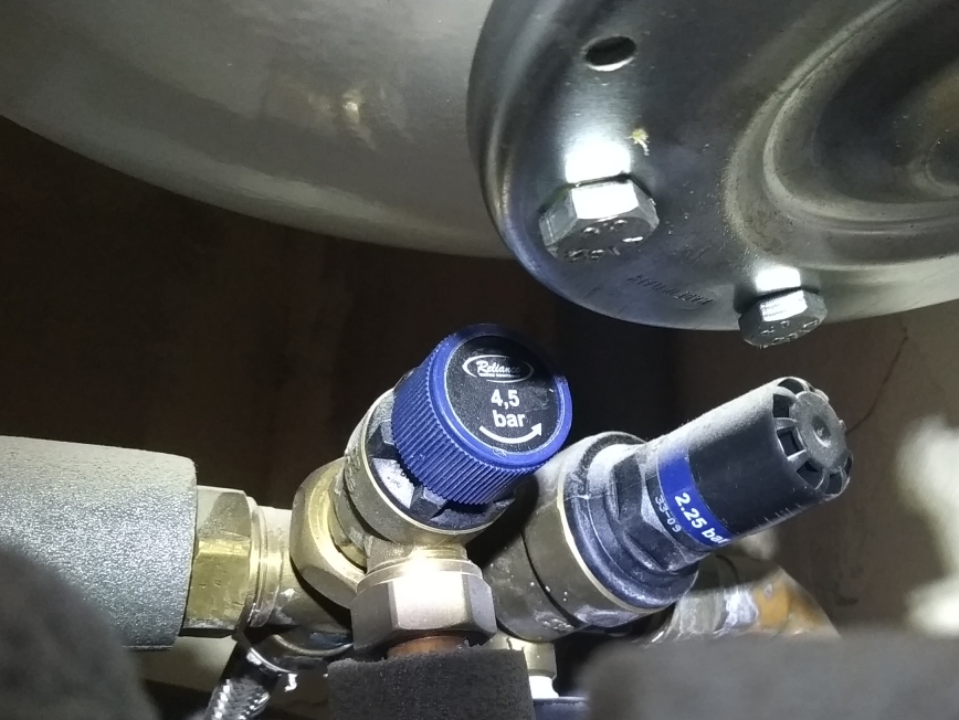

    Do I have one? If not, do I need one? Should I get one fitted? Can you tell? Don't be so gnomic... I see 2 things that look like valves near that dial - both are black, one has 4.5 bar written on it, the other has 2.25 bar.
    The only thing that I find interesting about those (as they seem pretty static) is that the figures are kinda like where those needles are on the dial. Spooky.

    So, do I have both a PRV and a TPRV? How can one tell if they're kaput? Look like the same brand name as that dial.

    So, 1 hour after both immersion heaters were turned on, we still have what you could call a cold dribble.
    But the water from the same tap I tested before is now a lot hotter. Pleasurably so. I'll leave it a little while longer... but not alone (don't trust it).
    The dribble down the tundish stopped when I ran off a bit of water from the hot tap.
    The black needle on that dial is now at 2.4 rather than 2.6. Remember, it was at 2.8 in the first picture... so at least the dial works! Yay!

    You had the answer on the first page. All the rest has been useless drivel. The expansion vessel will be completely flat, I'd bet money on it. The pressure gauge you're reading is on the inlet as far as I can tell so the rising pressure won't be seen as it's after a non-return valve. TPRV or PRV *may* be passing but usually they're either gone or they're not. You should be able to use both immersion heaters once everything is working correctly, that is not part of the fault.

    The assembly includes a pressure reducing valve as well as a pressure relief value (seriously)
    The first reduces the incoming supply to 2.25 bar so that the cold starting point isn't too high, and the second releases the pressure if it goes too high.
    There's always a possibly that the pressure reducing valve has a fault, because after running any notable amount of water from the tap, the pressure guage (which is after the pressure reducing valve) should reduce to match the set pressure on the reducer. However it could well be the guage with the issue.
