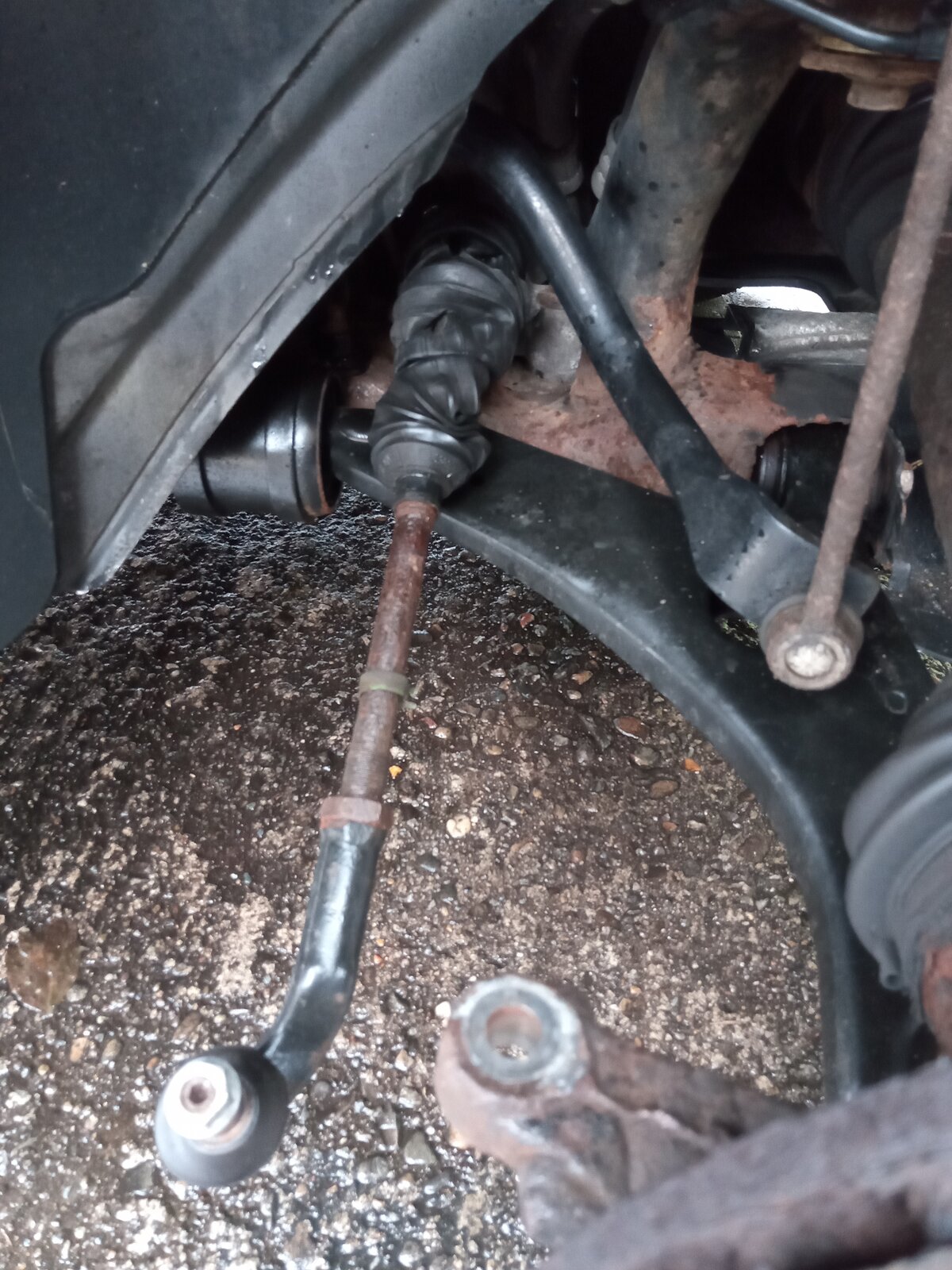

What has happened here,,,???

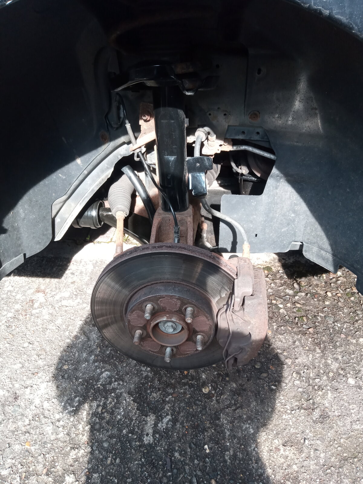

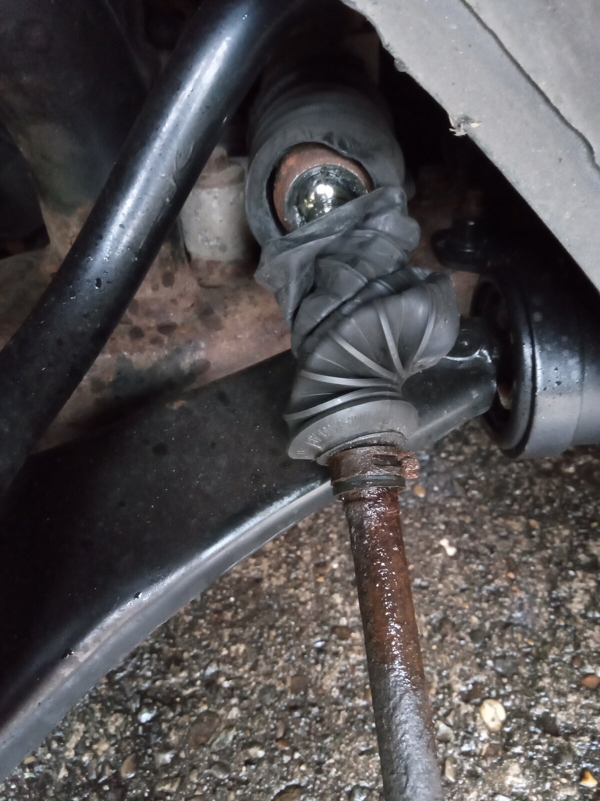

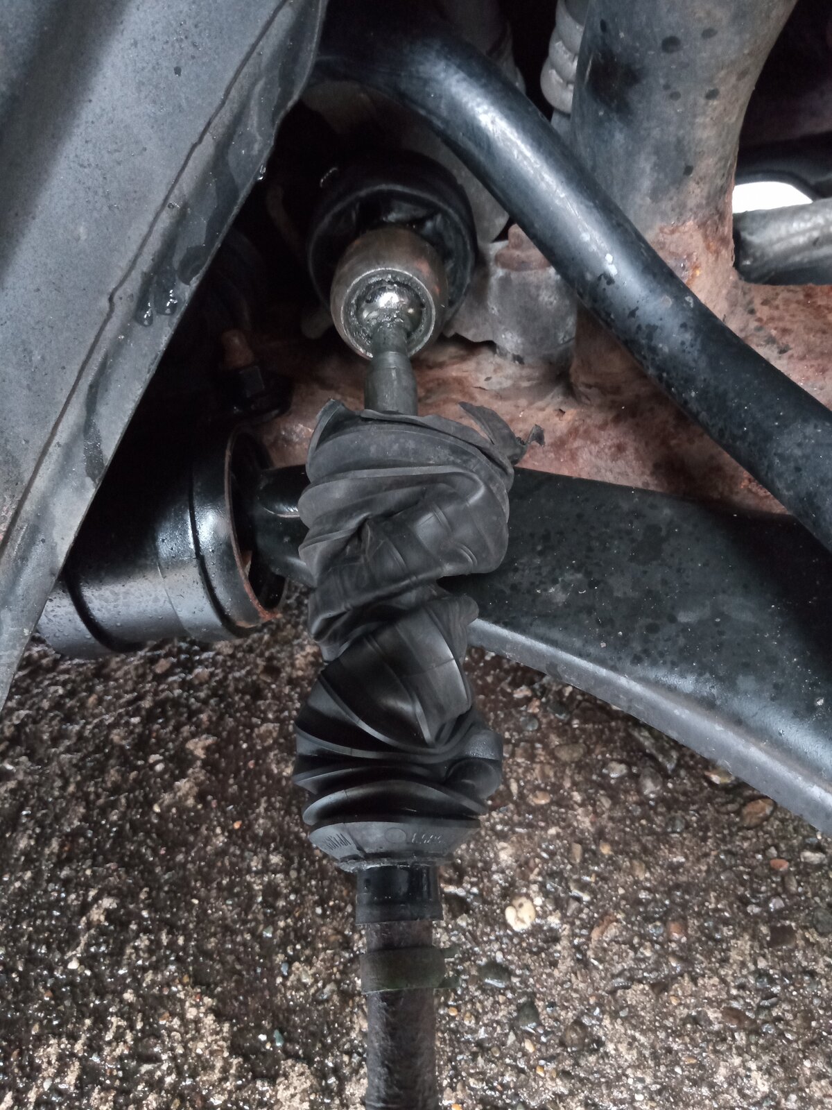

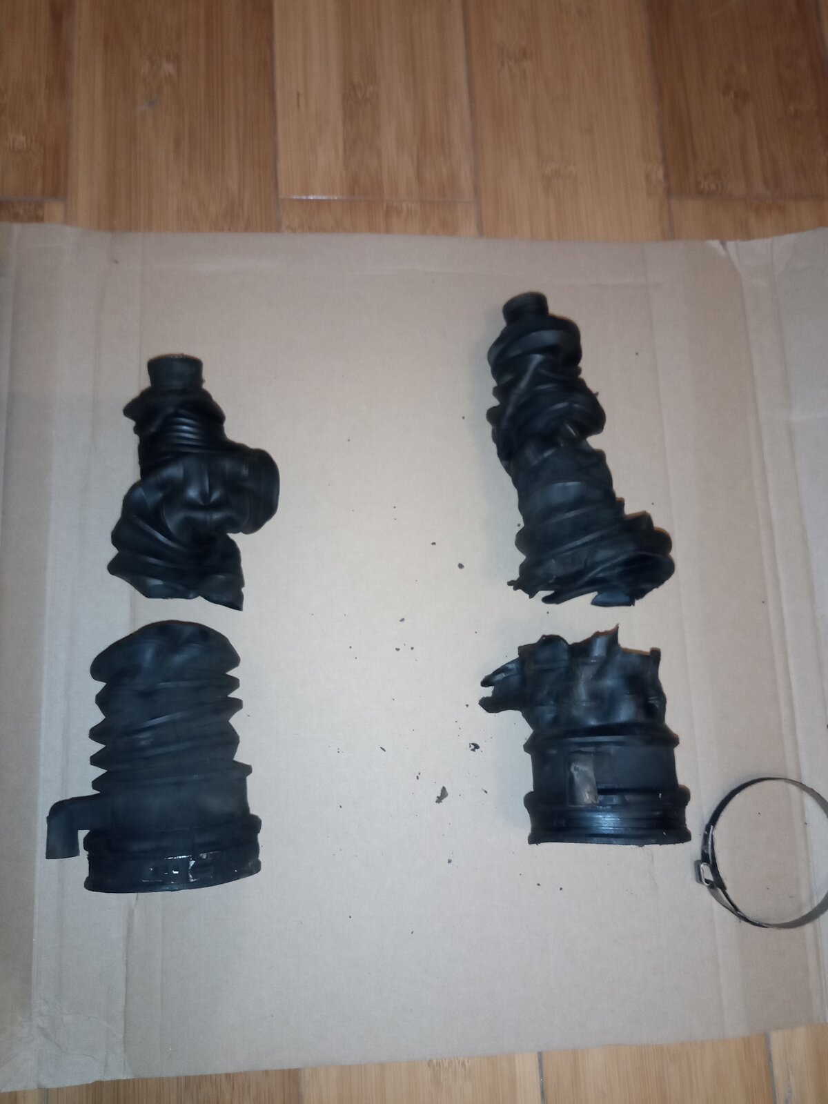

Hello,,, I recently fitted new struts, bottom arms and track rod ends then took the car to a garage for new tyres and tracking,,,today I've taken the wheels off for a quick inspection before its mot,,,see before and after pictures,,,it looks like the boots have been turned and turned till they have split,,, how is this possible,,, I'm mystified ... They were in excellent condition before going to the garage for tyres and tracking,,, ???
Yep, they've totally ****ed them by adjusting the wheel alignment without loosening the clips. Idiots and they've given you an instant MOT failure. Go back and show them the before and after photos and demand they put it right - preferably by paying someone else to do the job who knows what they are doing. Based on that evidence, I'd be surprised if they got the wheel alignment right in the first place!
And do not accept clip on/half n half boots, they must be the same as you fitted.
How incredibly incompetent.
As mattylad - insist they use the proper boots, it shouldn't take them long, if you have pulled it apart recently..

Hello,,, I recently fitted new struts, bottom arms and track rod ends then took the car to a garage for new tyres and tracking,,,today I've taken the wheels off for a quick inspection before its mot,,,see before and after pictures,,,it looks like the boots have been turned and turned till they have split,,, how is this possible,,, I'm mystified ... They were in excellent condition before going to the garage for tyres and tracking,,, ??? View attachment 254843 View attachment 254844 View attachment 254845 View attachment 254846 View attachment 254847
That just beggars belief. They must have known what they had done, and thought they could get away with it.

If they were turning the adjuster, the winding up boot would be right in front of them - impossible to no see what was happening. I have never known those boot clamps applied so tight, that they couldn't be turned by hand without releasing them. They are only intended to keep dust, dirt and grit out.
