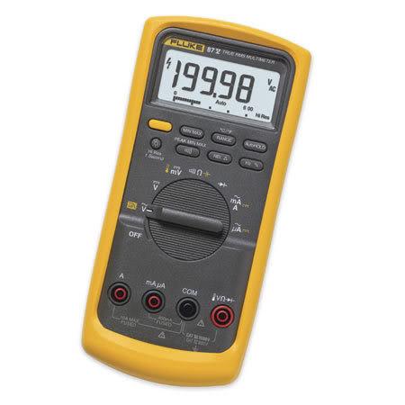

What should this orange wire be connected to?
put the ch only on the valve should move over fully to close the hw port ch open.
the orange wire will have 230v on it.
if it hasn't its either only going to mid position or the micro switch is not being activated.
check the orange wire for 230v.
the orange should be in the same connector as the call from the cyl stat.
and sw/l to boiler.
i just said check the orange if it is giving 230v its being activated.
is not giving 230v then its not moving to ch only port or its not activating
the switch.
check for power at the orange.
