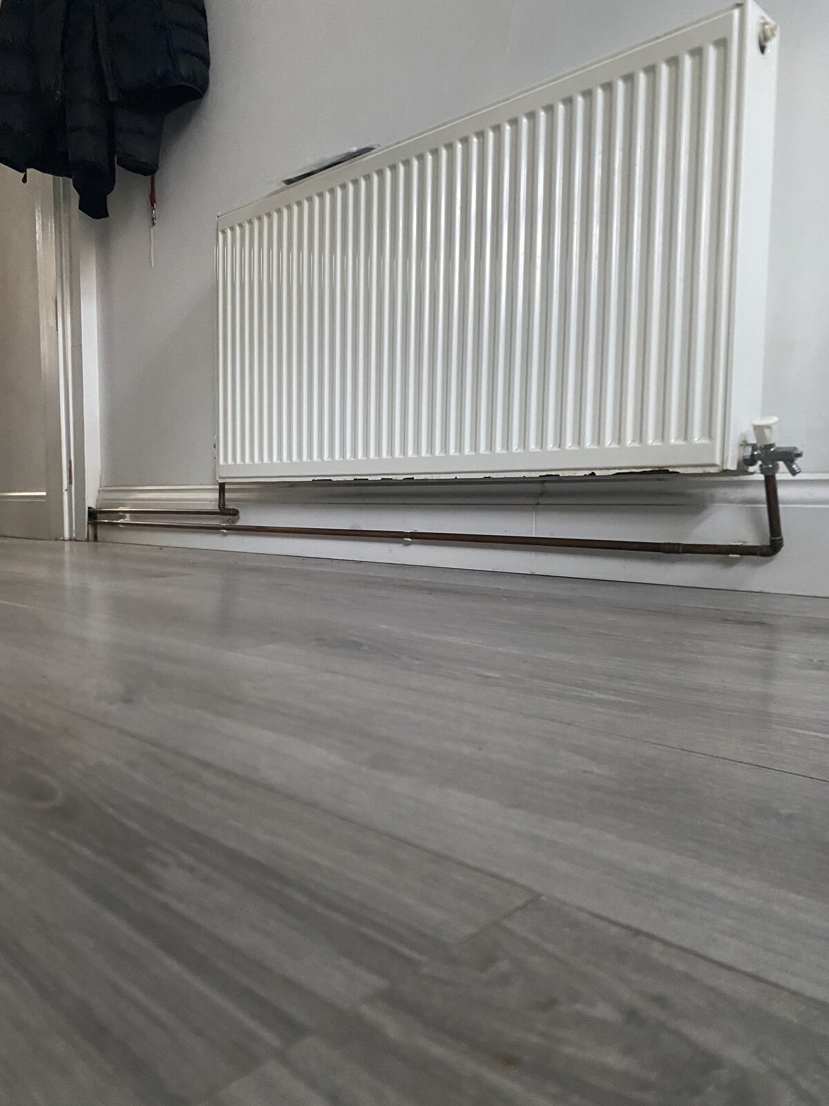

I live in a 2 up 2 down terraced house so only 5 radiators in the house
Kitchen, bathroom, both bedrooms, Living room
Today I installed a new radiator in the bathroom, and bevause they are vertical pipes coming out of the floor, I drained the upstairs radiator and pipework. On the two bedrooms upstairs, I turned the lockshield and TRV valve both off before draining the bathroom radiator (drained via the kitchen radiator as seen on picture below
Before refilling system, I put the bedroom radiators back to their initial setting (trv valve and lockshield).
Every radiator in the house was boiling hot, apart from the kitchen one… it was stone cold and so was the pipework supplying it
The kitchen radiator is below the bathroom
Any idea why my radiator is stone cold?
I have tried bleeding it but there is no air in there, water came straight out of bleed nipple
