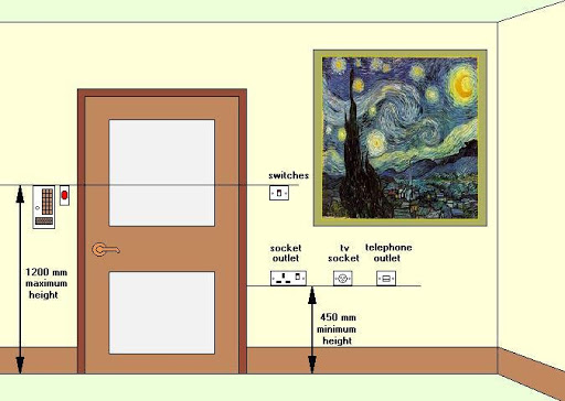

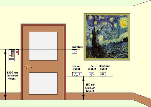

Does NOT relate to an existing property. Part M only applies to new buildings. if you started using those socket and switch heights in existing houses you would also need wheelchair ramps and extra wide doors in downstairs cloak rooms.
Get yourself a copy of Part M and read the first paragraph.
I do indeed have a copy of Part M and have read the contents, which I was I chose to refer to it. I don't see what in my post shouts out "this guy doesn't have a copy of Part M" The OP asked for suggestions regarding the height, so I offered him one. I made no mention of it being compulsory.
And as you mention reading, if you had read my post properly instead of jumping on your high horse. You would have seen I even chose to start it with "generally" [adverb: commonly or widely in a general way or sense] I'm sure a lot of public money, time and research went into it, so, it is probably a better and more widely considered proposal than most.
That's all fair enough.
However, I didn't bother mentioning it at the time but, since you are now talking about your having 'offered suggestions' to the OP .... I don't know where the diagram you posted came from but I would say that it can easily be read in a way that could be misleading - since it can easily be taken to imply that there is a minimum (but no maximum) height for sockets and a maximum (but no minimum) height for switches etc..
