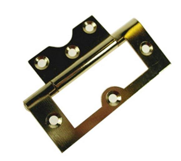

I'm fitting a louvre door to a cupboard and I've got some flush hinges, I want the door to be flush with the lining but I'm confused how these fit on because the cylinder of the hinge will stop the door from opening and closing. Are these the right hinges? I've not fitted a door before, need some tips

By flush hinges I presume you mean these:
The "cylinder" is what we refer to as the knuckle. Presumably you want to install the doors as full overlay (where the door completely covers the "lining"), in which case the knuckles will protrude at the sides:
If on the other hand you want the doors to fit inside the "lining" in what we call inset installation, the knuckles will be at the front:
Just like they do on your living room door (in all probability). If you don't want the hinges to be seen at all then you've bought the wrong hinges and what you need are concealed hinges, like the ones on your kitchen cupboards (again, in all probability)
They are countersunk 15mm long 5mm head, anyone know what they are called ?
Countersunk head screws. Screws are sized on their shanks NOT the diameters of the heads. In all probability they will be something like #4 x 5/8in or even #2 x 5/8in (#4 = no.2 = 4 gauge)
Hi Job many thanks, I wanted to install these without rebating any timber so the hinge is fitted to the face of the door. It is still what you refer to as inset despite the hinge showing on the front of the door it actually looks quite good
