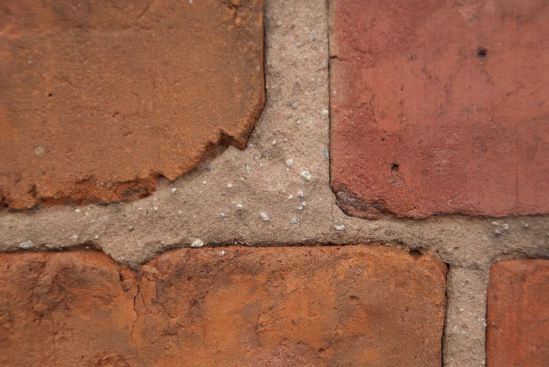

One question about the mortar. The current stuff is very textured:
I realise some experimentation is in order to get the best match, but do you have any idea what would have been used to achieve this? Some kind of fine Ballast or Shingle?
It's pretty hard to get a really good copy but your best bet is Sharp sand plus red builders sand and a weak mix.
