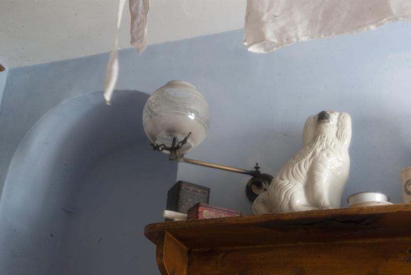

years ago in the caravan we used gas lights and I have never really worked out why they were not fitted as standard in the more modern caravan. Even better than the tungsten lamp for keeping warm.
We yes I do know some reasons. Broken mantles, as a result smashed diffuser glasses and caravan fires. Plus just like with tungsten lamps yellowed dirty areas around the fitting. But likely cheaper to use. At least with hook up charges of today.

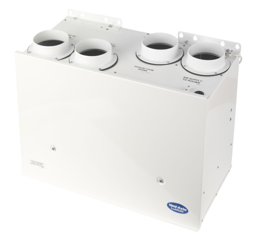

As we start to use heat recovery units like these
56776_P
then some of the advantages of using tungsten lamps will go and the compact florescent unit will start to really save energy as we require less and less energy to heat the house. But at £700 each without fitting it will take some time before we see these in even new houses never mind those already built.
